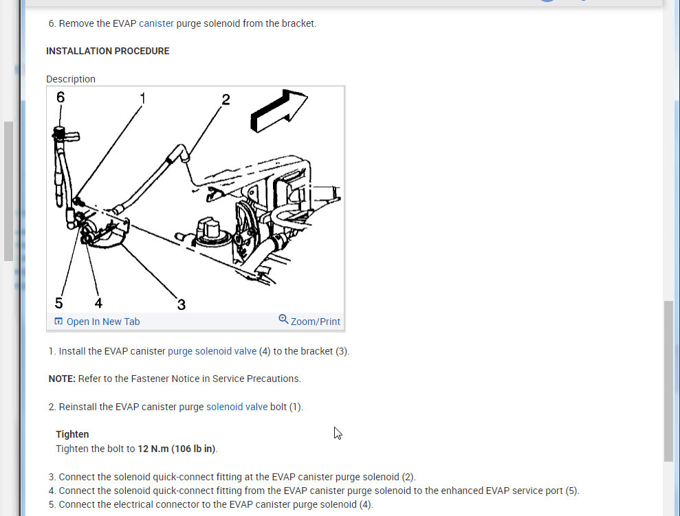

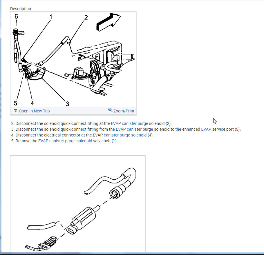

However, if that is not it then these are not easy to figure out. We have to pull the system into a vacuum to see if it holds a vacuum. Basically you can do this at the purge valve and if the system holds a vacuum then the purge valve is the most likely issue. This would be great but a lot of times the lines are dry rotted and only leak at certain times.
Can we start with checking for codes and make sure we have a small leak. It should be a P0456.

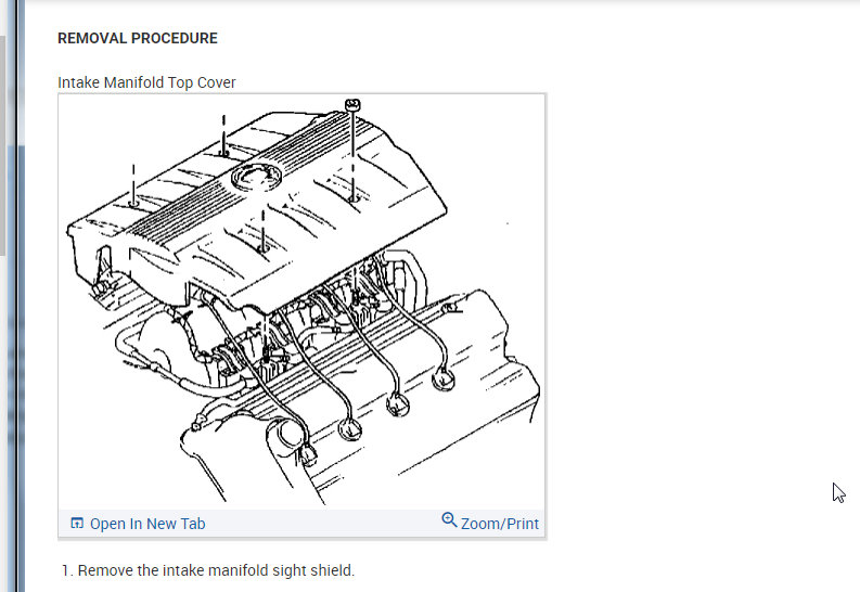

I would then replace the gas cap hoping that takes care of it. If not we are going to have to hook a vacuum gauge to number 2 in the info below. This is the line going to the purge valve and then pull it into a vacuum and see if it holds. If it does, replace the purge. If it doesn't then you still have a leak in the system that we will have to narrow down.
