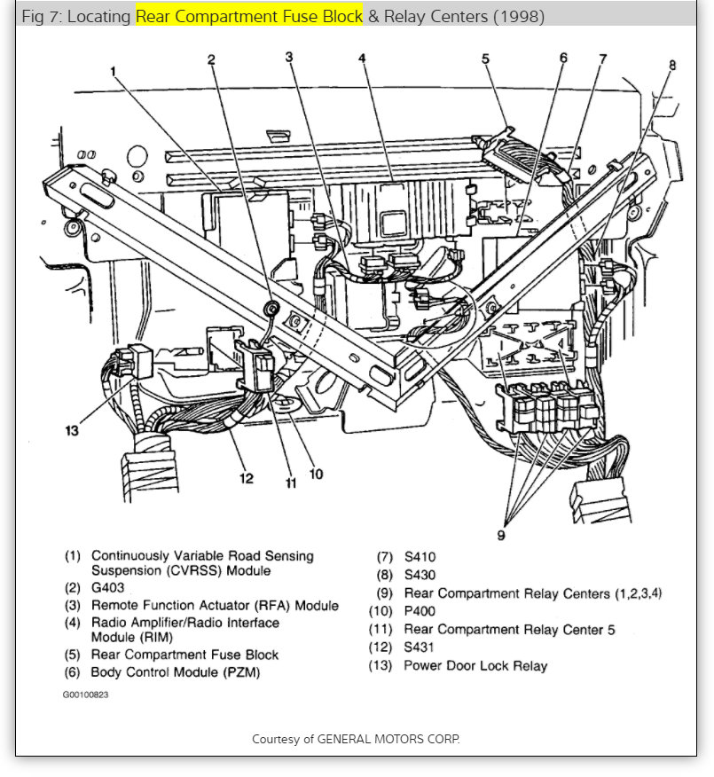

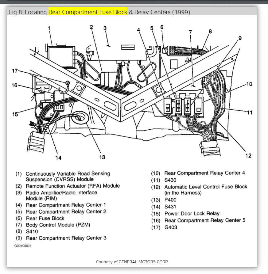

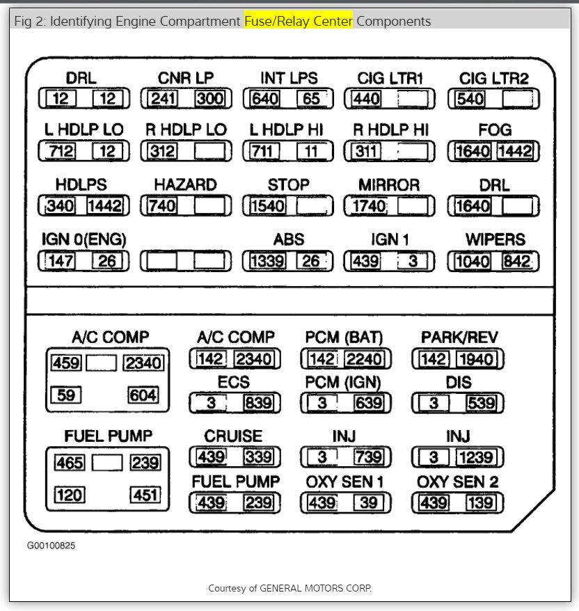

hey i was working on a 1999 caddy deville and replace fuel pump and not getting any fire to the fuel pump. I checked all the relays and the fuse under the hood is there another relay that is some where esle on the car, aiso check the fuses in the trunk , i test the relays with a test light and where the fuel relay goes their is no fire there. dont see any crack wire or any thing do the oil sending unit has any thing to do with that
Sep 21, 2010 at 1:15 PM
  • 75,992 POSTS

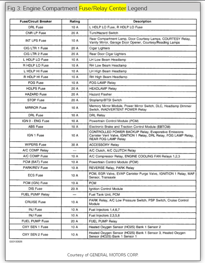

Check the fuel pump relay socket pink wire if there's power nothing here and the fuel pump fuse is good the pink wire is open between the fuse and relay socket

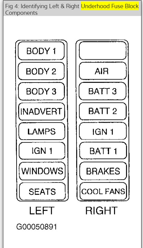

the fuel pump fuse is in the relay panel under right side of dash. 20amp fuse we enjoy your feedback

FACTORYJACK
  • 4,159 POSTS

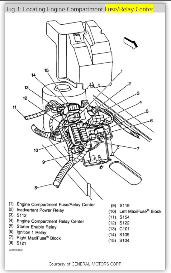

The fuel pump relay is in the underhood fuse block, in front of the left front(driver) strut tower. It is either under the flap that provides access to the mini fuses, or you need to remove the plastic cover. There will be a sticker on the underside of the cover, the legend for the fuse relay center.

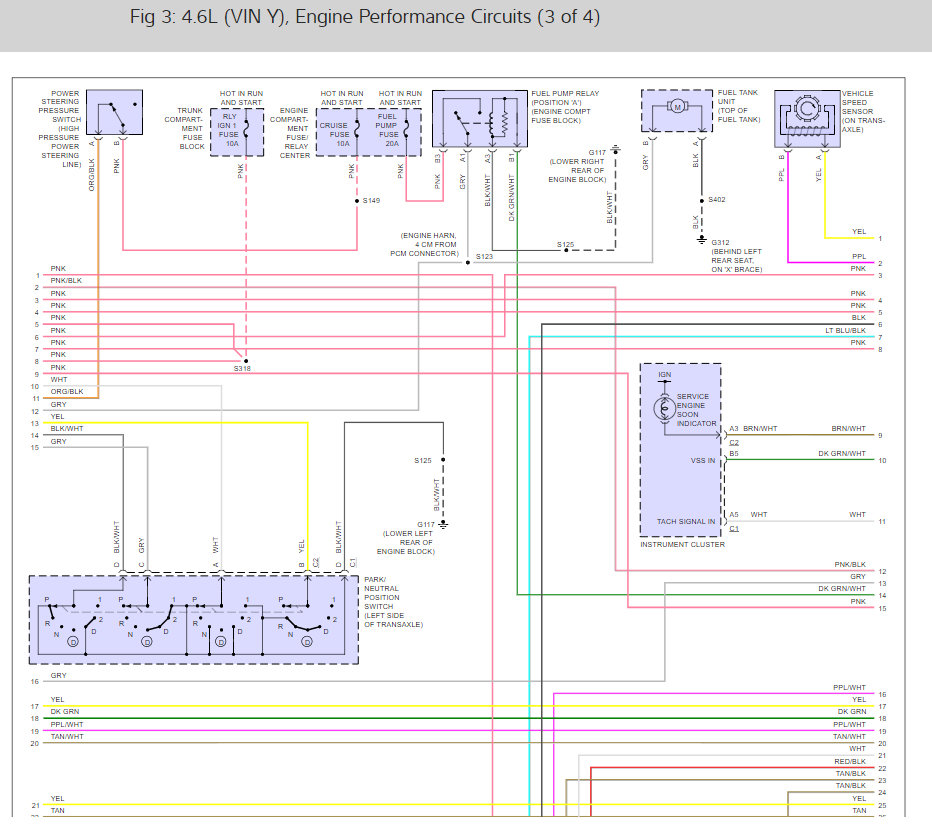

  • 55,433 POSTS
hello,
Here is a wiring diagram that show where the power is coming from which looks like a fuse. Here is a guide on how to check for power

i had the same car back in my cadie yrs. do u hear the pump run when u first turn the key on?drop the r/side under dash panel.u will see a relay panel with fuses in it.there is a 20 amp. mini fuse their marked fuel pump.use a test light or volt meter to check that voltage is there and the fuse isnt blown.we can start here.kk

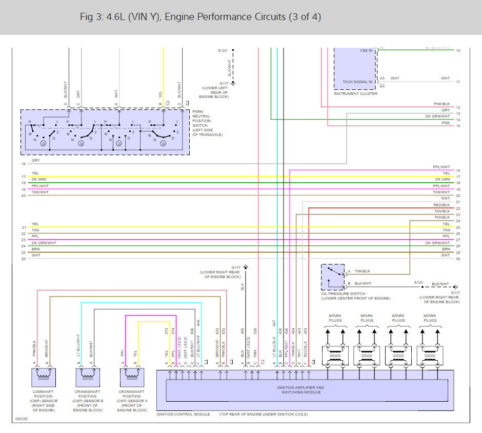

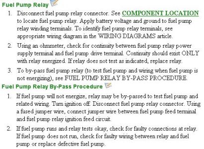

I'm new to this forum. Working on a 99 Cadillac STS 4 door. Similar story as above. Fuel pump replaced. Ran fine then he let it run out of gas. Now now power at the pump. Fuse and relay are good. I did swap the relay jic. Probing the relay block I get constant 12v for relay but no voltage for relay control circuit. I power probed the fuel pump and checked fuel pressure 39 psi. Tried starting it with power probe on fuel pump. Cranks well but no start. I wonder if the computer needs a signal to fire up?
Tomorrow I'll check the drkgrn\wht wire for power. Where does the green and white wire get power? I want to check there.
Jul 8, 2026 at 2:59 AM
  • 55,433 POSTS
Welcome to the forum, make sure the pink wire tot he relay has power, then the drgrn/wht wire is the trigger from the ECM. If the crankshaft sensor or MAR sensor is not working the engine will not start. Please check out this video it can help us get started to fixing the problem.
