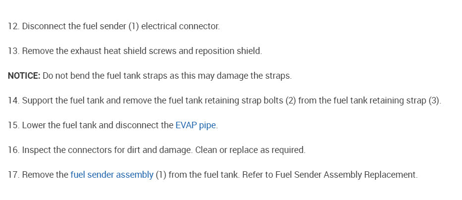

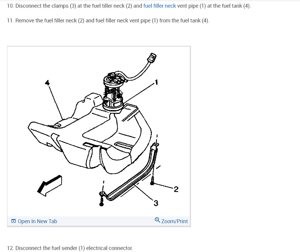

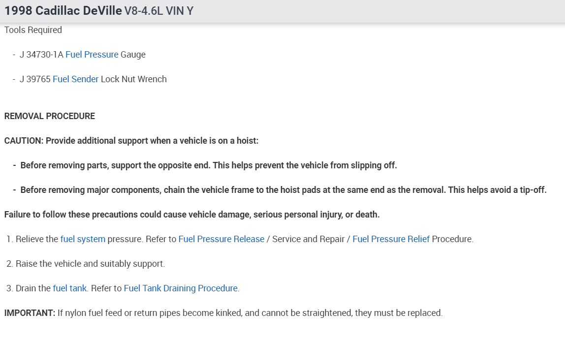

I would like to know if it is necessary to drop the gas tank in order to replace the fuel pump? Also, is there an easy way to tell if it is the fuel that has gone bad? I have been told that you can "hear" the fuel pump running when you turn the key to the run position, but the only sound I can hear when I go to run is the pneumatic ride pump and I think that sound would drown out the fuel pump noise. Please help, thanks.
May 22, 2016 at 2:00 AM
SATURNTECH9
  • 30,869 POSTS

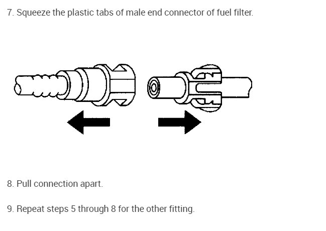

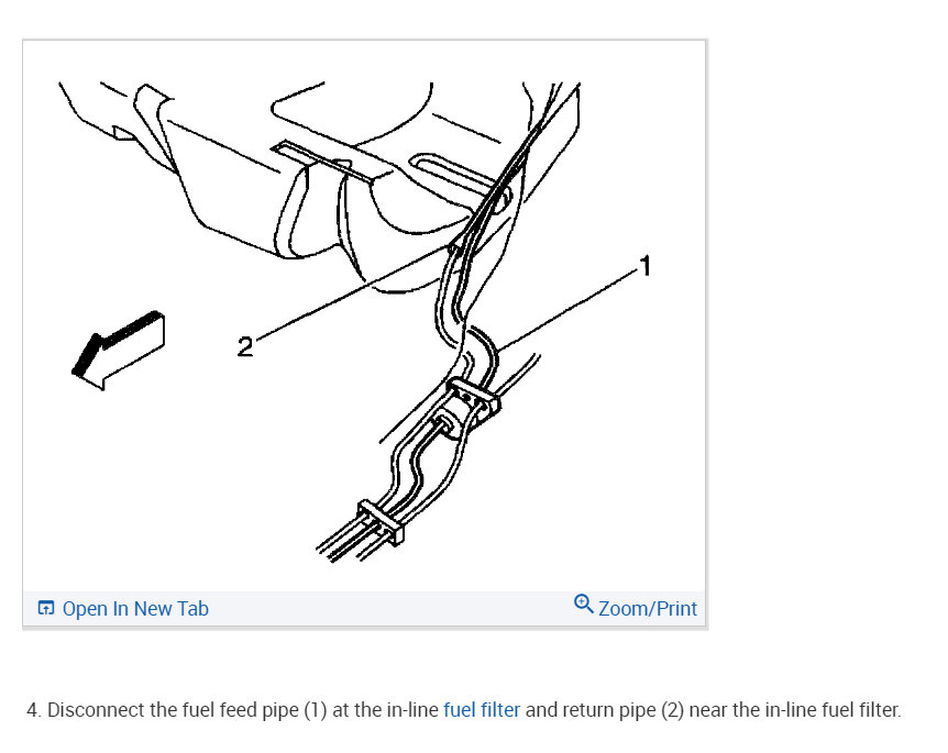

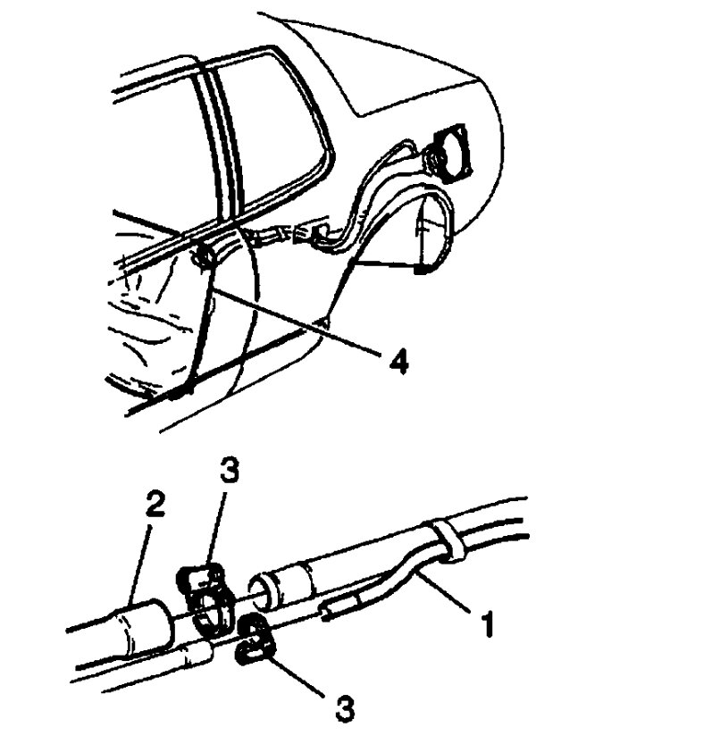

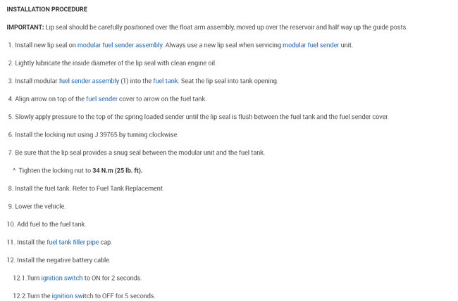

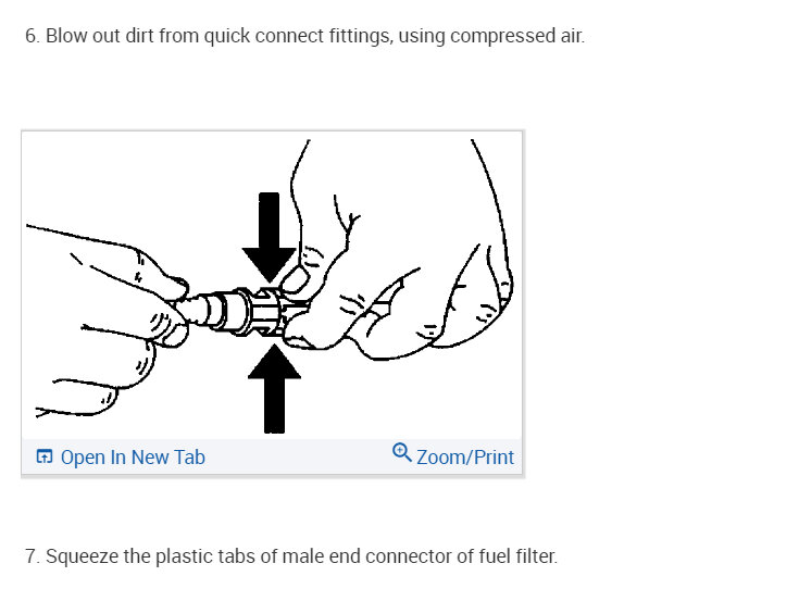

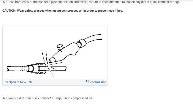

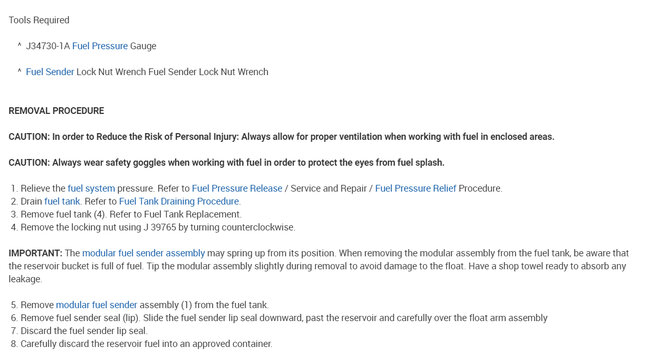

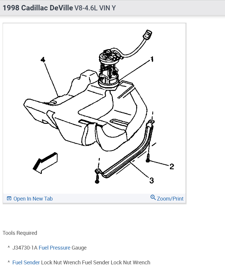

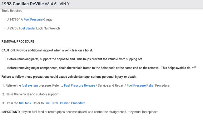

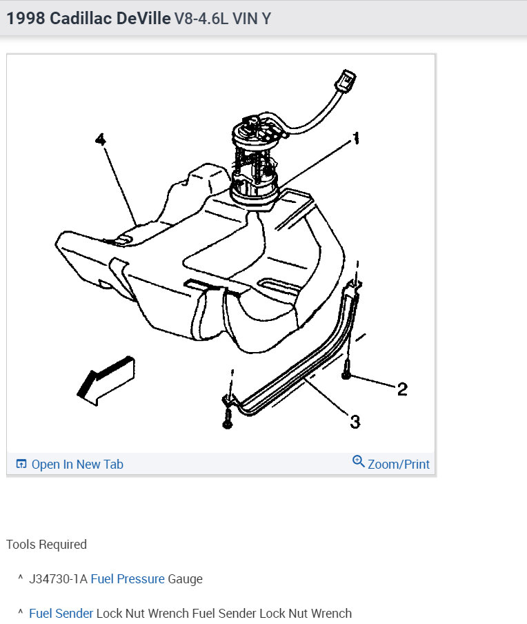

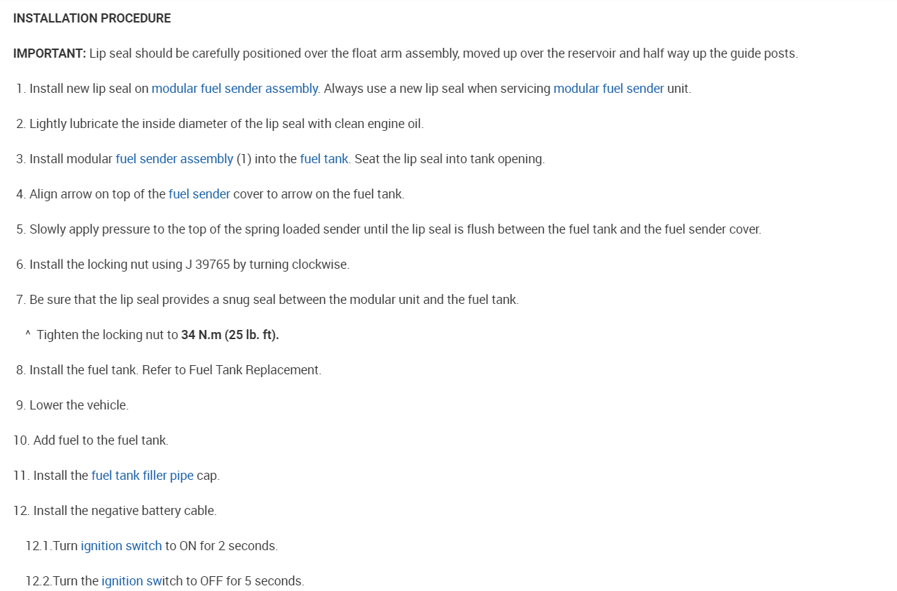

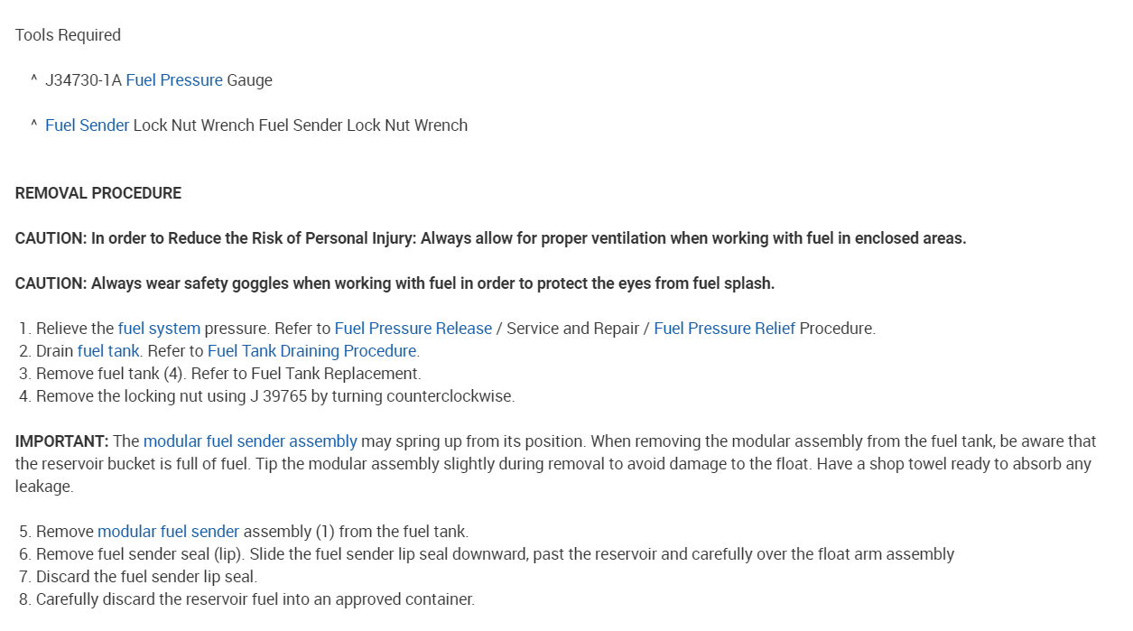

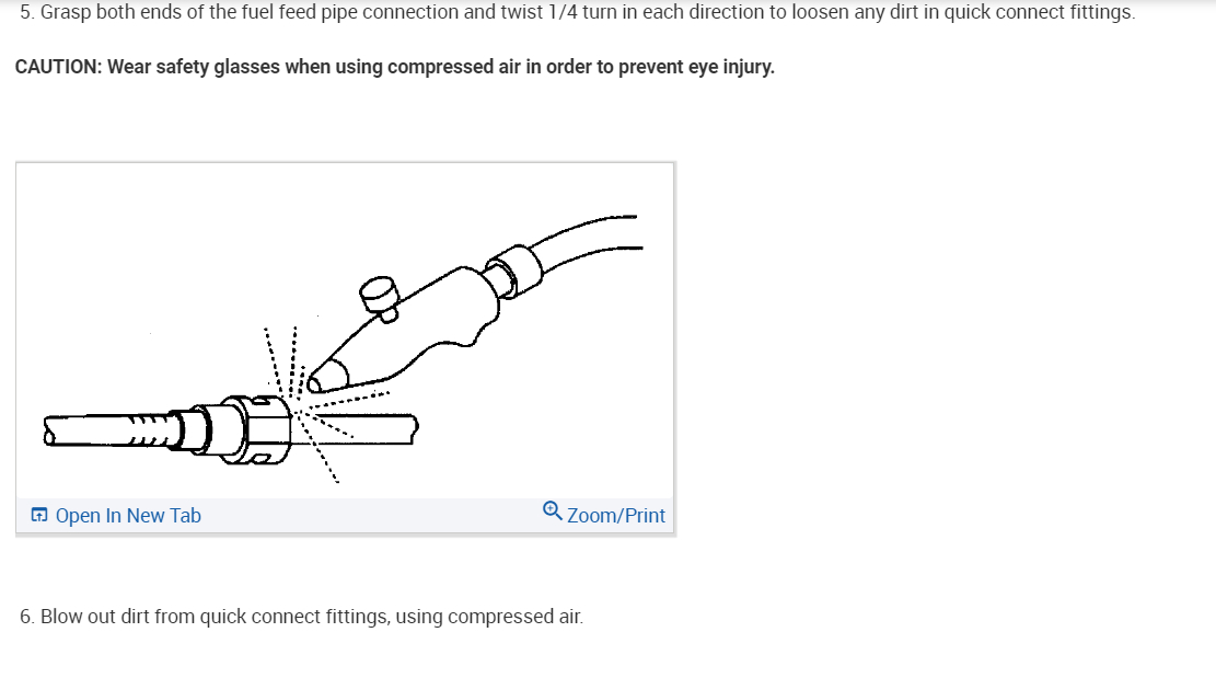

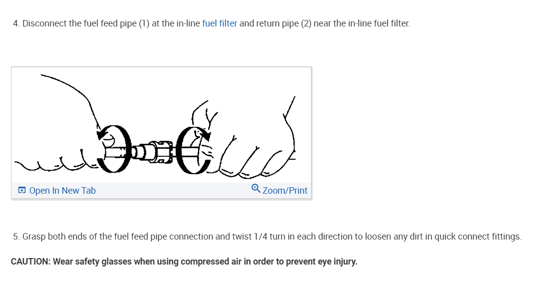

The fuel tank will need to be removed, here are the instructions on how to do the job. Check out the images (Below). Please let us know if you need anything else to get the problem fixed.
