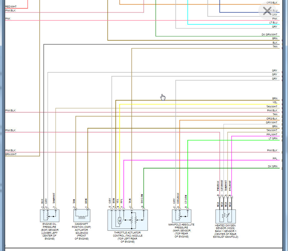

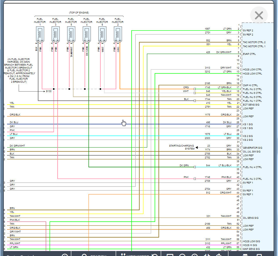

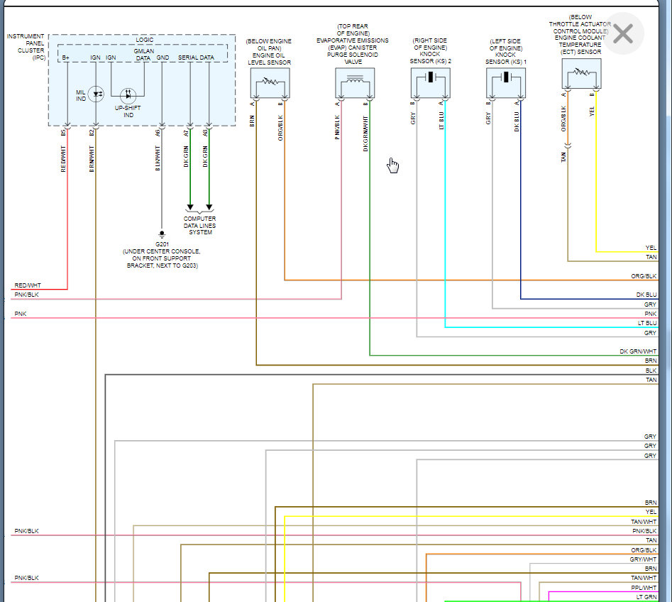

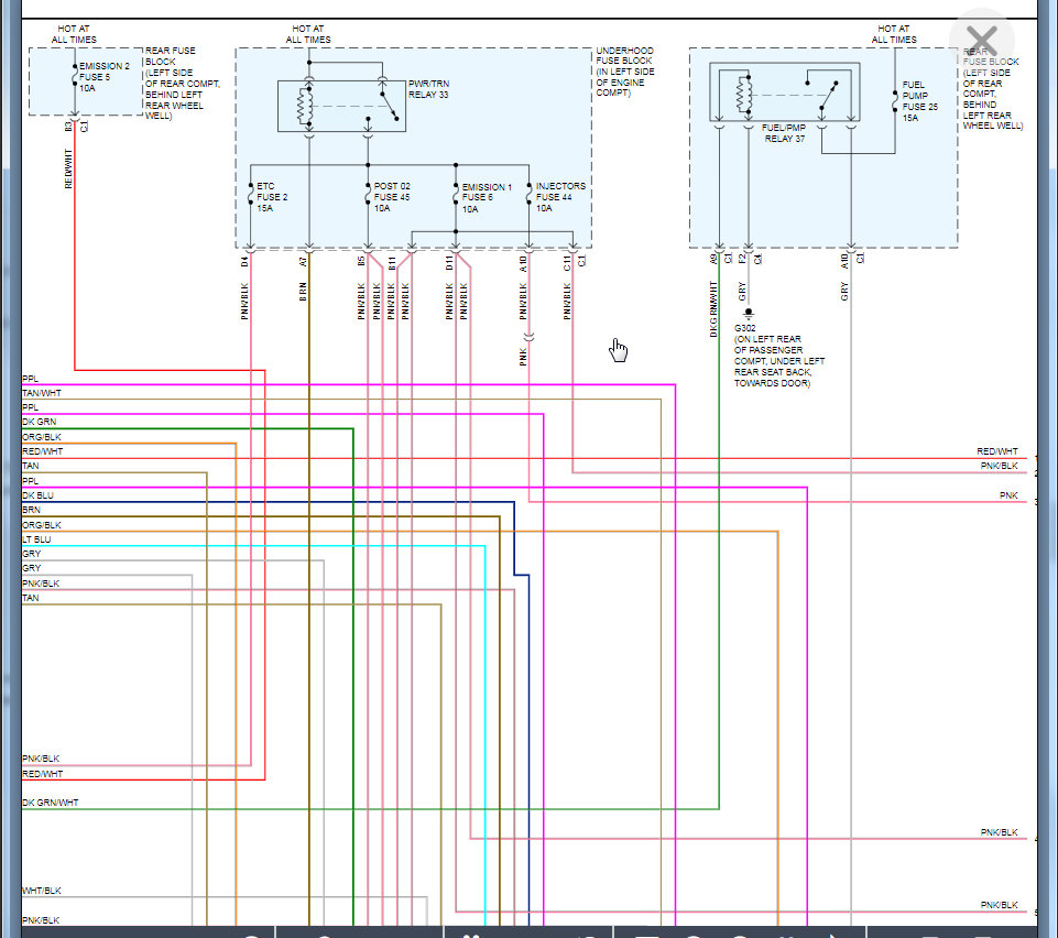

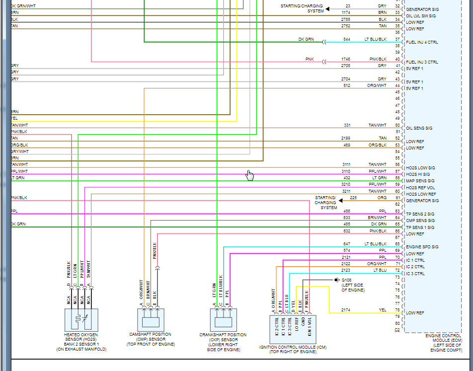

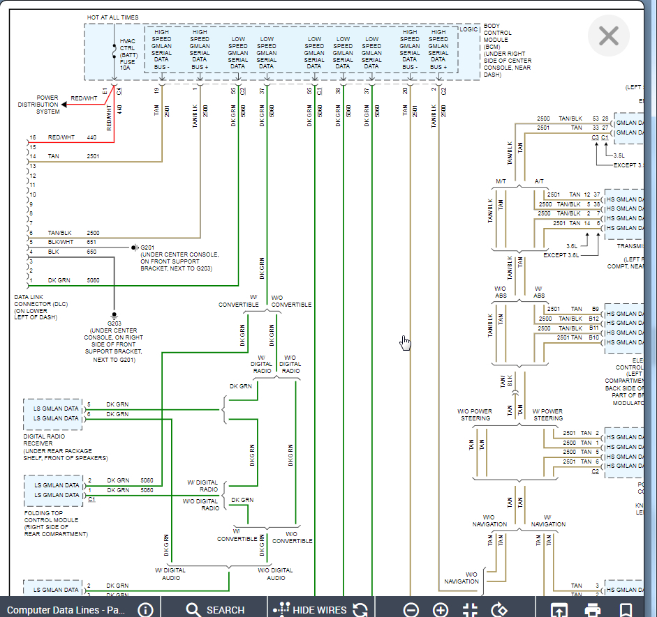

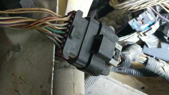

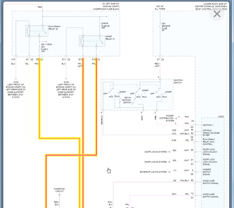

I bought it like that. Error shows on odometer, no start. I checked every wire from pcm and TCM under the hood to the connector that goes to the ABS computer and the inside of the car (show in picture, is the one hanged over the wipers washer fluid), everything looks good on on that side, but now I don't know where these wires are going on the inside. what do you suggest me to check? I know maybe the PCM or BCM are bad but I want to be sure the wiring is good before order any of these parts.
Apr 9, 2021 at 1:57 PM
I provided the complete wiring diagram below but I would suggest a different plan of attack. Inspecting the wiring that you can see is not a bad idea but there is a ton of wiring that you will not have access to so I would just test the wiring from end to end. Meaning unhook the connector on a component like the Ignition Control Module and then the connector on the PCM and test for resistance and shorts to power and ground. Here is a guide that will help with this testing:
Doing it this way you are ensuring there are no issues with the wiring and it is finished in a matter of minutes. Plus it is more definitive because you may inspect all the wiring but not see the pin hole rub through that is there. However, if it is touching a piece of metal it will show when you check for ground.

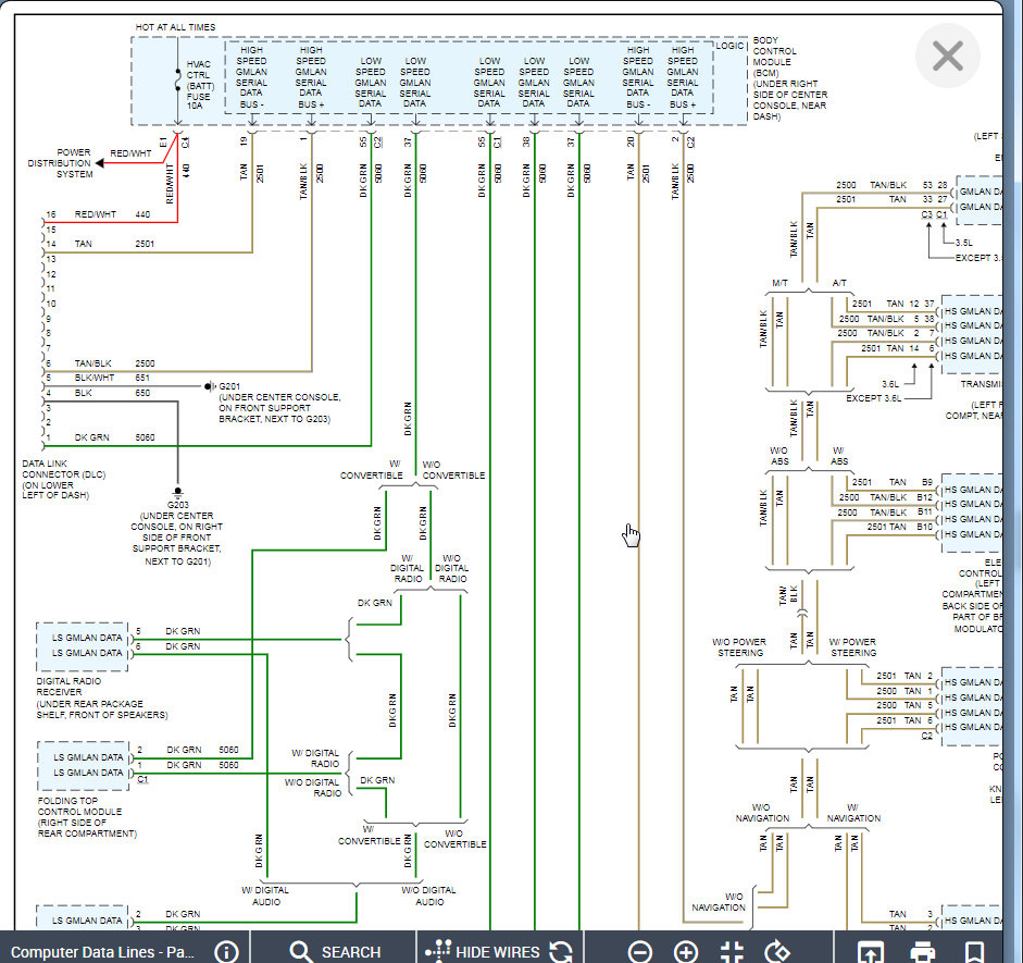

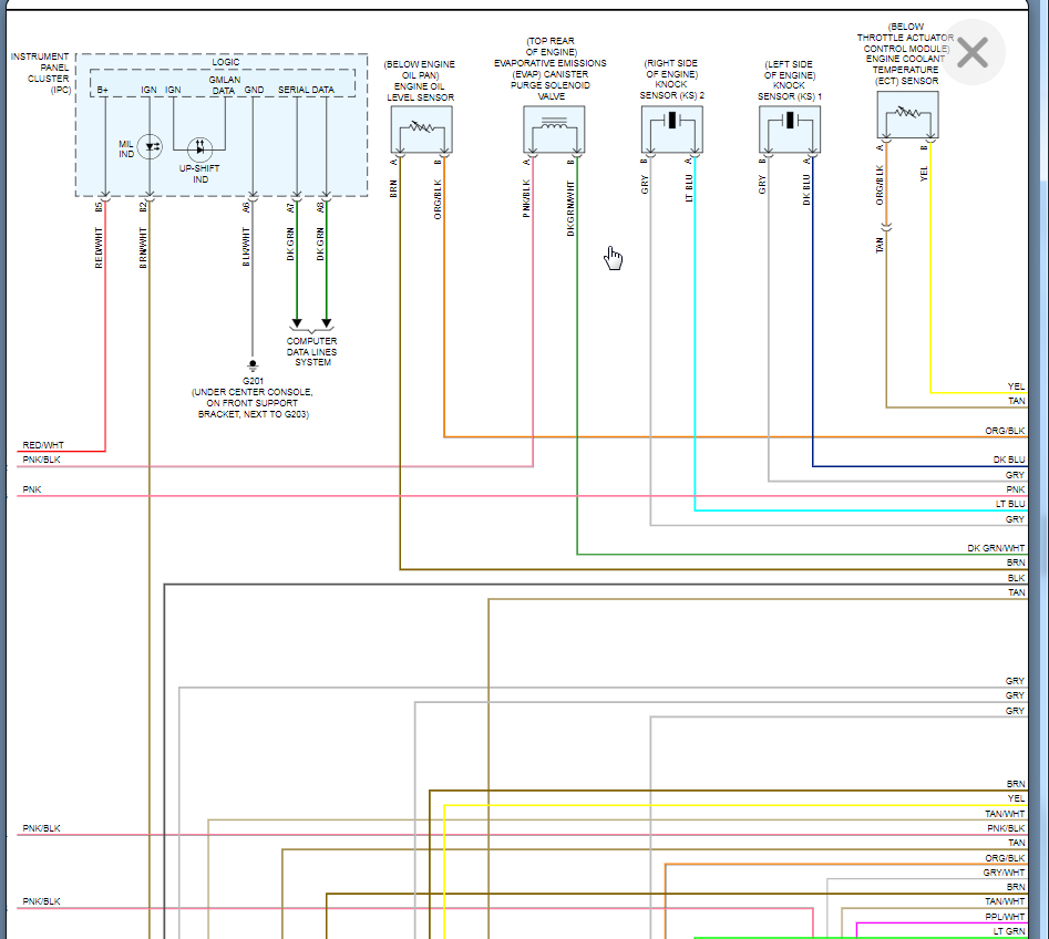

Then we need to check for codes. I suspect you will not be able to communicate with the PCM which means it is either failed or the BCM is failed as you suggested.
So if you cannot communicate with any module then I would shift to the BCM and test the wiring from the DLC to the BCM. This is the last wiring diagram that I attached. Again, test for shorts and open circuits. Then make sure the BCM has power and ground itself just to make sure there is not a fuse issue, and it is has all this then I would replace the BCM.
Let me know if you have questions on any of this and we can walk through it. Thanks

Thank you Kasekenny. I will be checking the entire path for every wire. Also, I went to an automotive electronics repair shop with my PCM and BCM, seems the PCM was faulty but can be repaired. I will test if that fixes the problem when I get it back in a few hours.
Let you know if I got lucky.

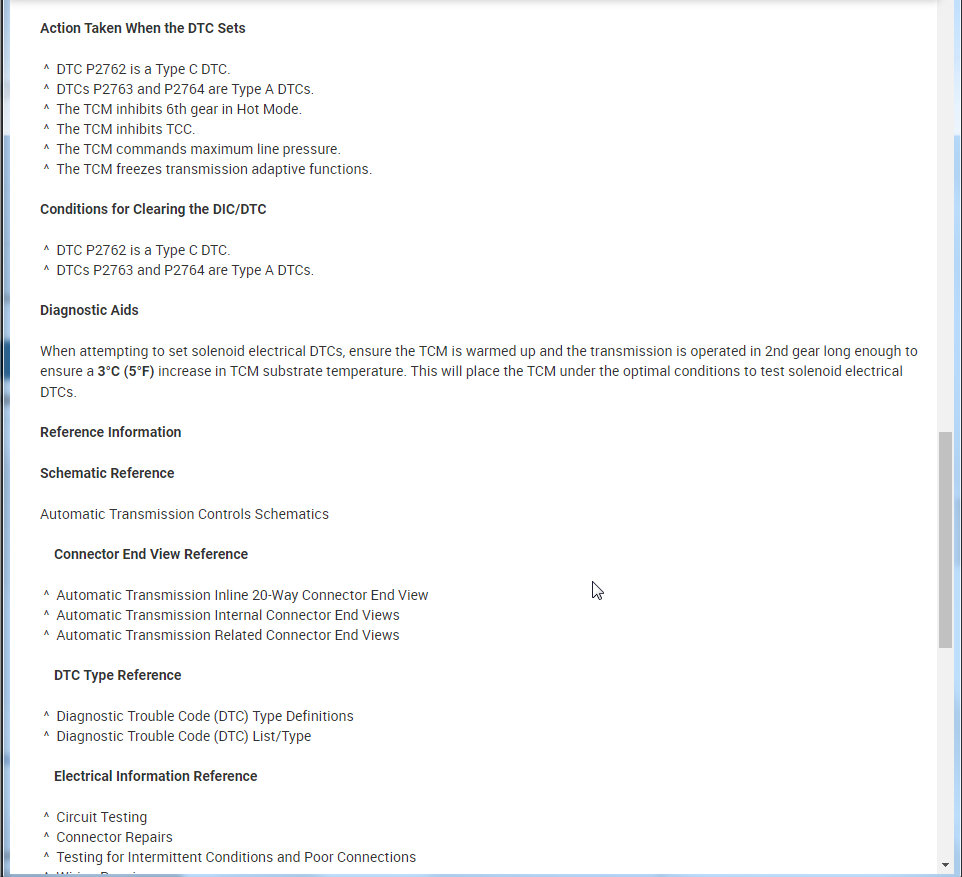

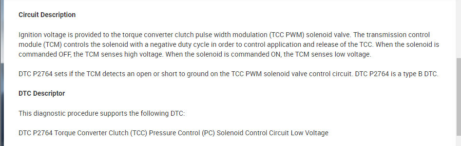

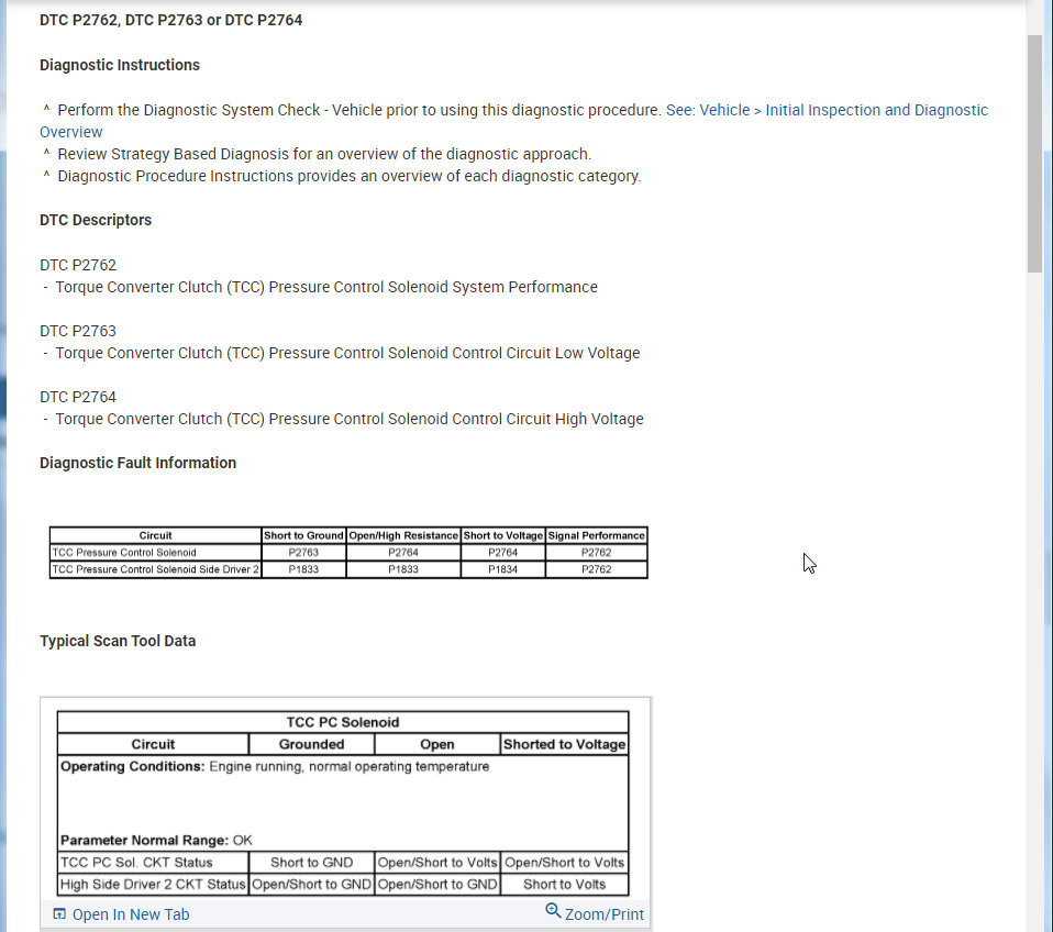

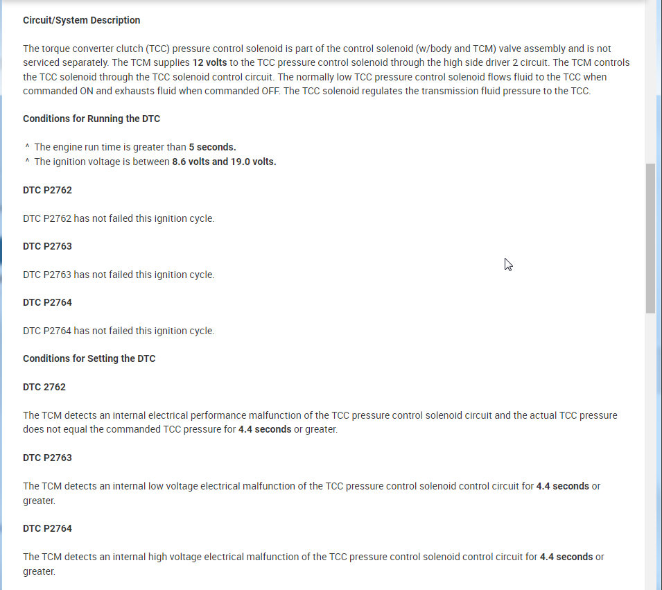

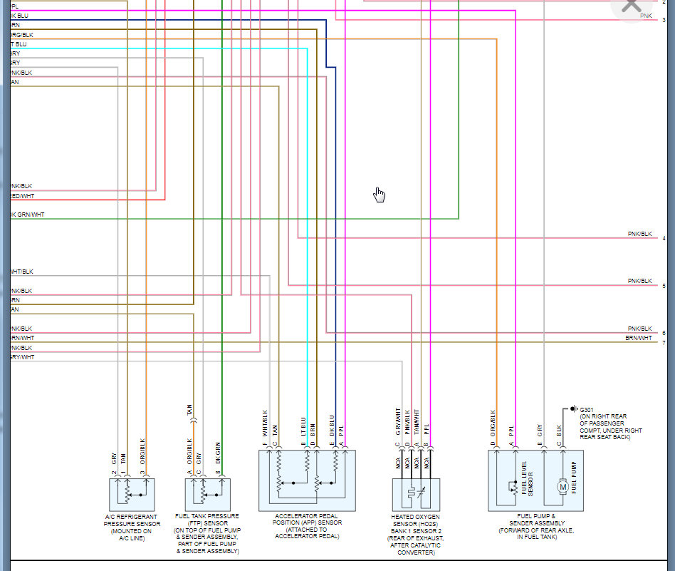

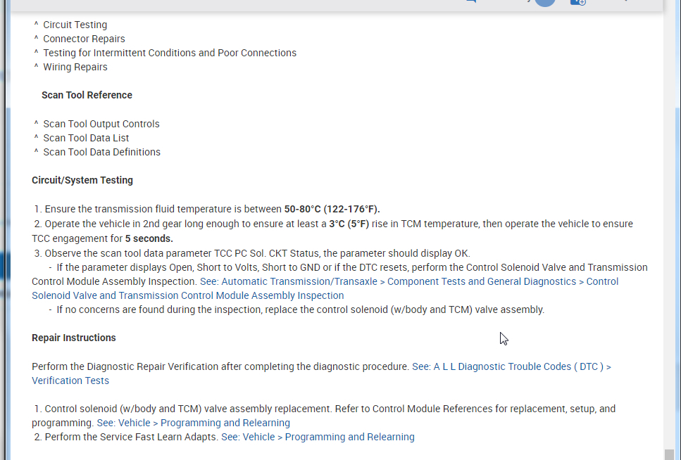

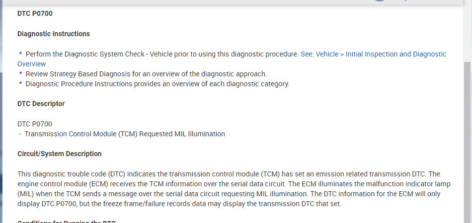

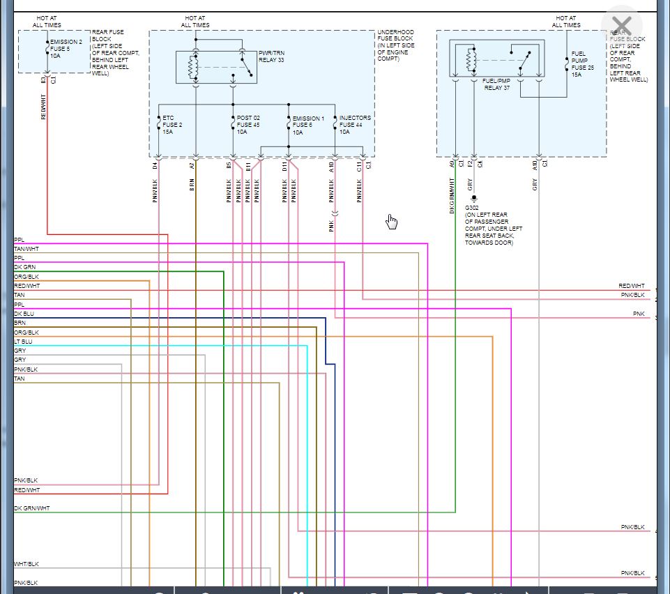

Update: I did a relearn (10 minutes key On, 3 times) and I got a few different codes. P0700, P2764, also I did a fuel pressure test and I only got 10 PSI.
What do you think guys, can this be related to the wiring? In that case how do you suggest me to check it? Or what should be the next step?
Apr 12, 2021 at 10:54 AM
Let's take a step back because I think we have a couple issues going on here.
Does the vehicle crank at this point or are you still jumping the relay? When you tested that fuel pressure was that just with the key in the on position?
If the engine does not crank then we don't need to worry about fuel pressure or those transmission codes yet. I attached the detail on them below just so you have it but again, we need to start with a no crank issue if this vehicle is doing this.
When they say it was a voltage regulator, what was that going to address?

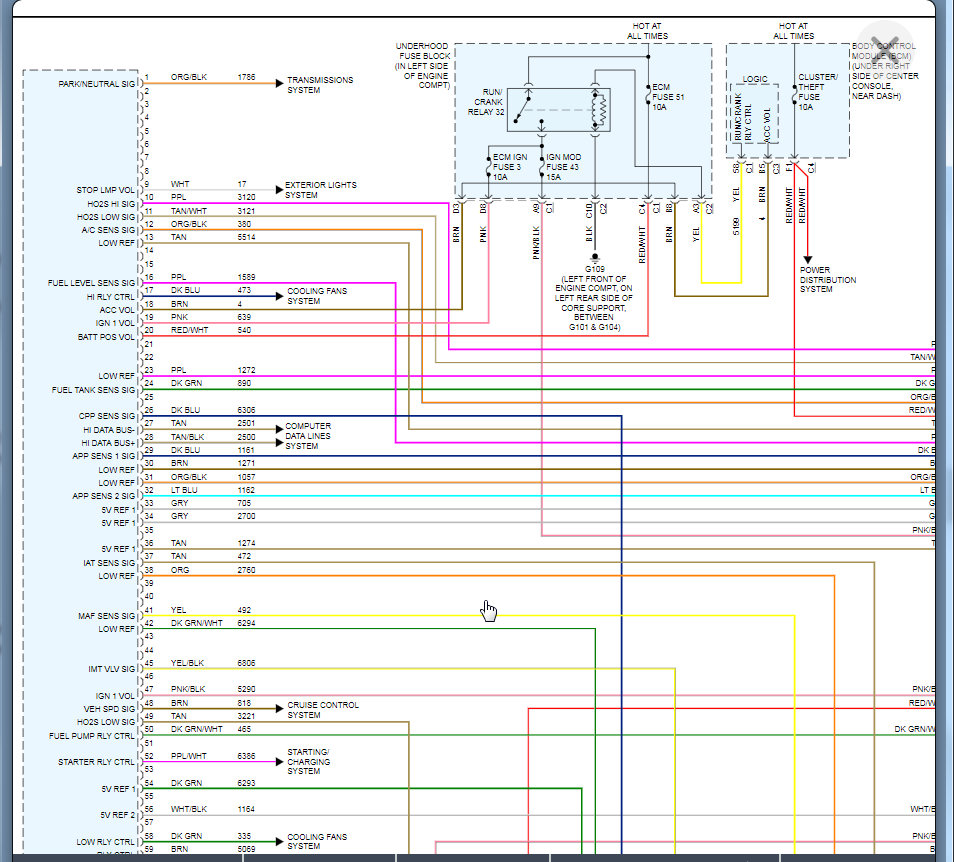

Can you guys tell me what conditions needs to accomplish in order the bcm execute the ignition command?
If I understand the ignition relay is totally controller by the BCM.
Thanks.
Apr 14, 2021 at 10:48 AM

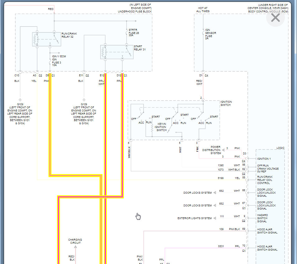

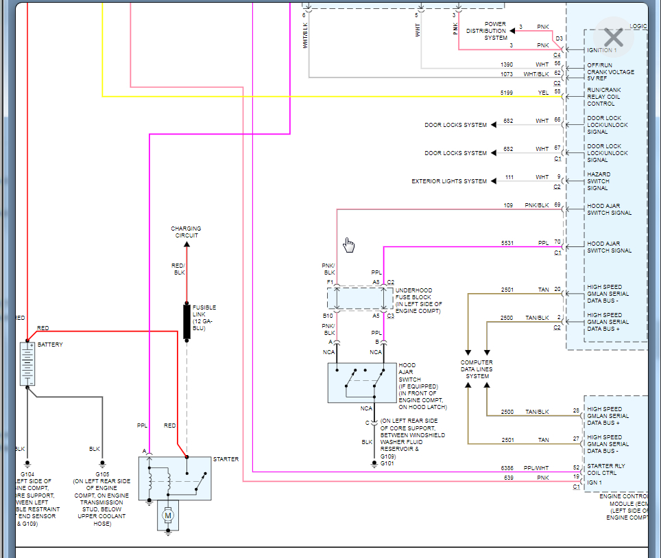

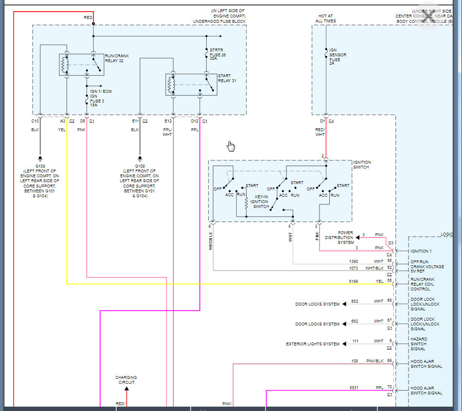

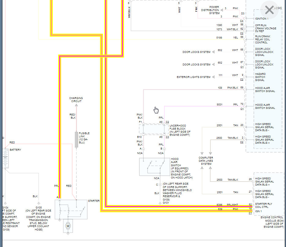

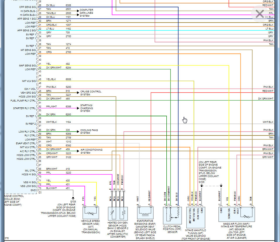

Okay. If there is a no crank then we need to check voltage on both wires at the starter.
The purple wire is the control wire and needs to have 12 volts when you are cranking the engine.
If you don't have voltage on this wire then we need to check the start relay 31. If that is ok then we need to check for power coming from the PCM on the purple and white wire.
Basically the way this works is the key sends a signal to the BCM. The BCM sends the signal to the PCM to send power to the relays. When the relay closes it sends power to the starter.
Please run through this wiring diagram and let us know what you find.

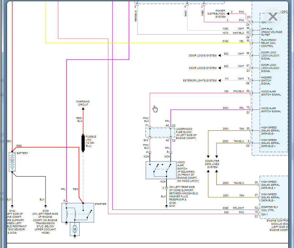

More then likely you are correct. The Body controller gets the signal and cycles the locks so I would just verify the voltage at the starter when cranking and then we can go back through the system.
Let us know what you find and we can go from there.

Okay. I checked relay 31 and 32. They seem to click when I turn the key to on position.
The relay 31 does have power all the time with the key on.
I checked the voltage an these are the result for relay 31.
Pin 86 ppl/WHT. = 12v with key On, 12v during crank
Pin 85 = ground (seems to have some resistance on the connector with the relay, about 30 Ohms)
Pin 87 purple wire to starter.
Pin 30 12v from battery at all times.
It doesn't make sense it has 12v on the ppl/wht at all times with key On. Also. What can be the reason for when I jump 30 and 87 the starter cranks. But if the relay coil is energized at all times with key On it should crank the motor because is closing the circuit but it is not.
Can this be related to the relay socket and that resistance I mentioned above? Can the fuse sockets be disassembled to check if there is some corrosion or other problems?
Apr 16, 2021 at 11:55 AM
ALEJANDRISSIMO MORGADO
  • 17 POSTS

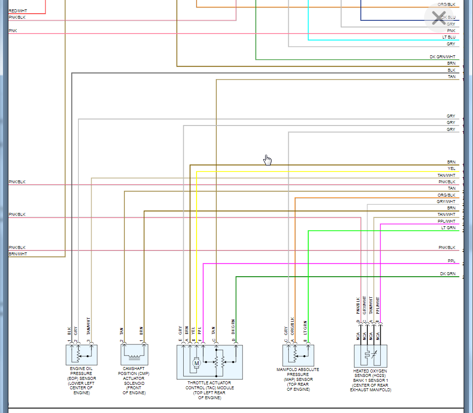

Okay. I figured out. Yes, that weak ground is at least one of the problems.
I opened the relay to see if it was working mechanically. And surprise it wasn't. But because the coil was not getting ground.
According to the diagram. This ground for relay 31 is coming from G109. Just to be sure where is exactly located the G109?
Anyway. With the multimeter probe and a paper clip I can touch the ground pin on the relay 31 socket. But the relay seems to be not long enough to reach it. Because with the relay disassembled, there is no ground on the other side of the relay leg.
As a testing. I jumped the relay 31 coil pin directly to battery ground with a spare wire and the car was to crank (but at this point of testing the battery is lower than 10v so I will recharge it.
I think the problem is on the socket, can this fuse socket be disassembled? If yes how? Because I tried and it seems the center bolts are holding the two pieces together.

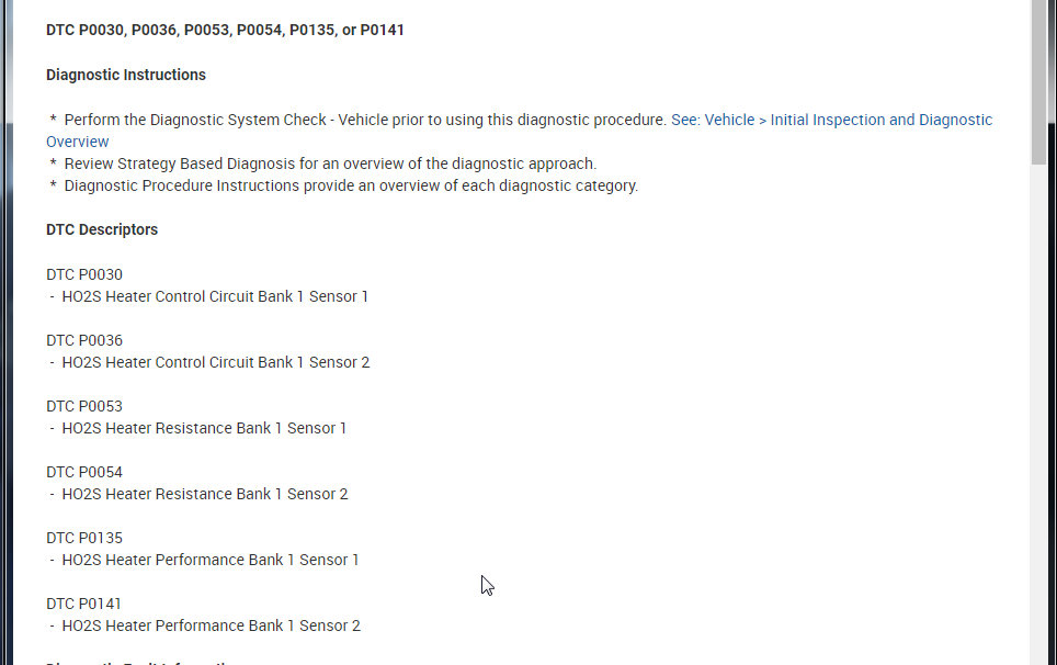

Now, the codes with the engine on :)
P0036
P0141
P0700
P2764
Can any of this be related to possibly faulty connections in the fuse box? Or affect the car driveability.
Before trying to move the car I will do an oil change and check the spark plugs.
Thanks
Apr 17, 2021 at 5:55 AM
Wow. That is great updates and progression. Others will benefit from this in the future.
I attached a list of these codes. In short, they will not effect the running of the vehicle immediately. The o2 codes will effect it in the long run but let's get a new post started for these as they will not be related to this one and we need to keep each to one issue so that others can find the solution if they have the same thing.
As for the P0700 that is just telling you that you have a transmission code and that code is the TCC circuit low code. If you need help with that one as well, let's get a post started there as well. However, I suspect that will go away once you get the vehicle running.
