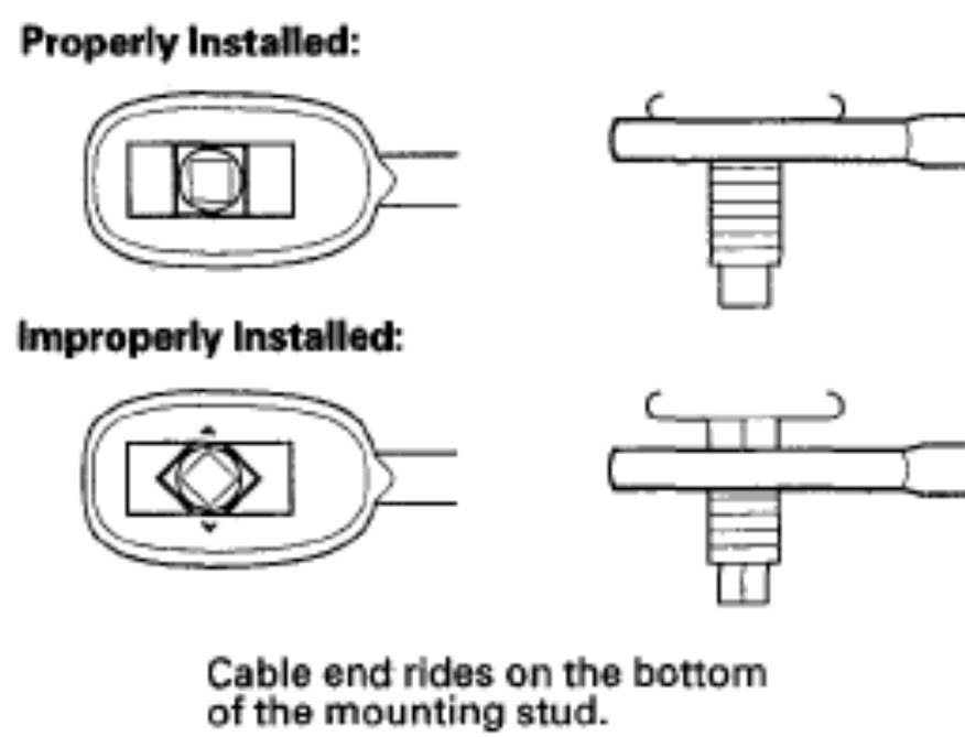

HMAC300
  • 48,601 POSTS
these are relatively new as far as transmissions and not a lot is known about them. scan for codes if any and get back to us.you can check to see if filter is partially clogged as well as shift linkage ok. we dont' have that vehicle in USA so no info on it.
