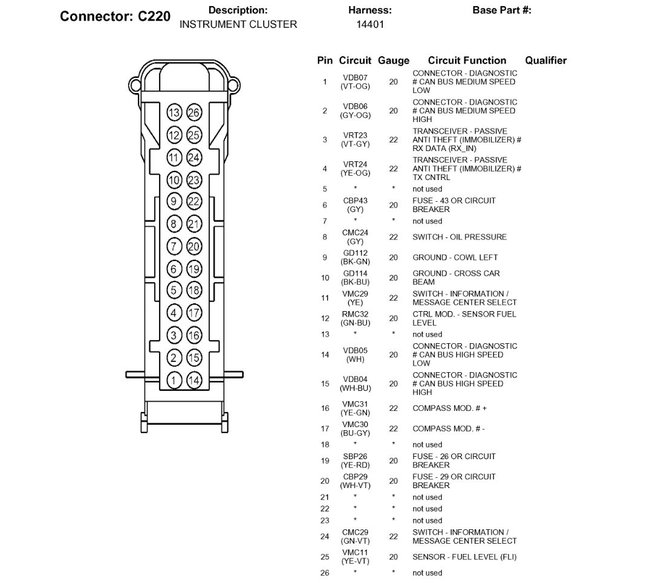

gauges pegging out and all warning lights coming on while driving.
Dec 4, 2019 at 4:23 PM
JONNYB1963
  • 263 POSTS

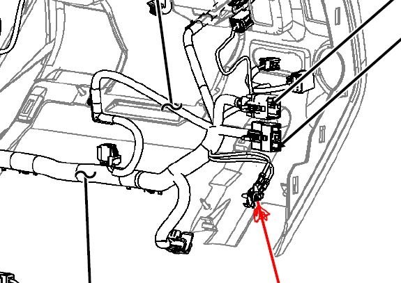

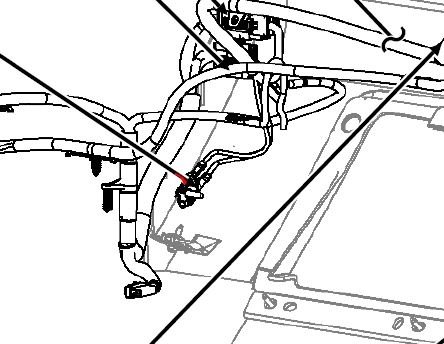

Sounds to me like you have a loose ground to the Instrument Cluster. Its a pretty common thing. This is where I would start if I were you.

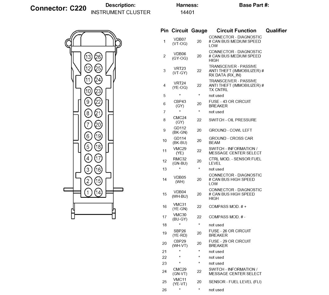

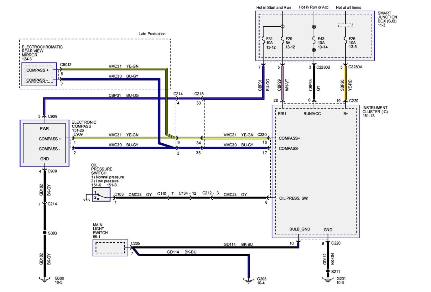

On this vehicle there are two ground wires from the cluster, one goes to the left hand side, behind the dash panel and bolts to a stud on the body, The other goes to right side behind the dash and also bolts to a stud. You should check both of them.
You will need to get a flashlight and get under the dashboard and locate them. When you find them, give them a wiggle and if they move, tighten the nut to secure them back in place.
Start there and let me know what you find!
