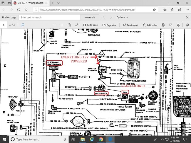

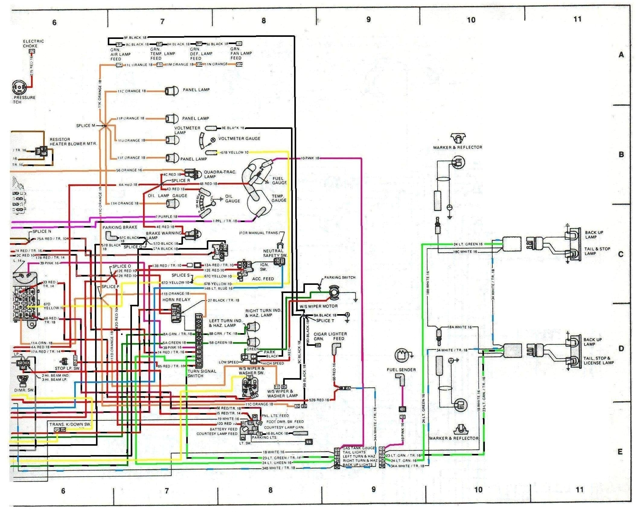

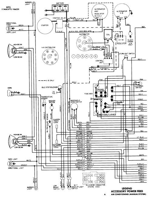

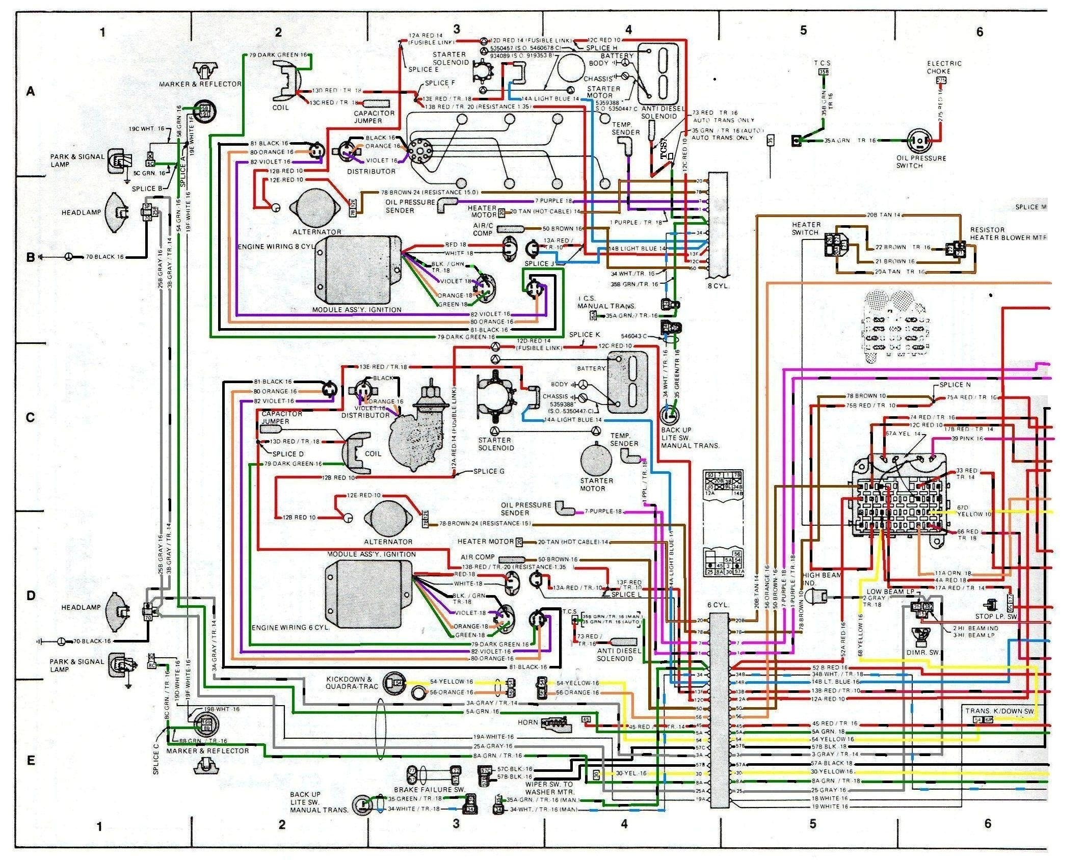

I colored a '79 diagram and use it a lot, I upgraded my Prestolite ignition to Motorcraft, that diagram serves me well, much of it pertains to other CJ years.

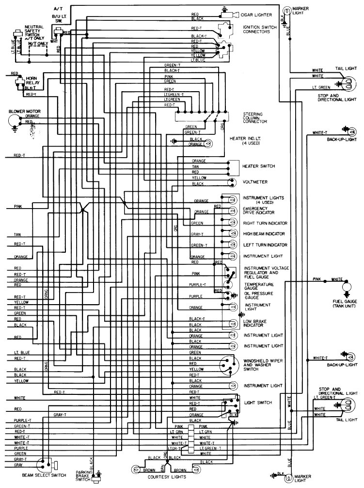

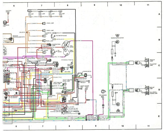

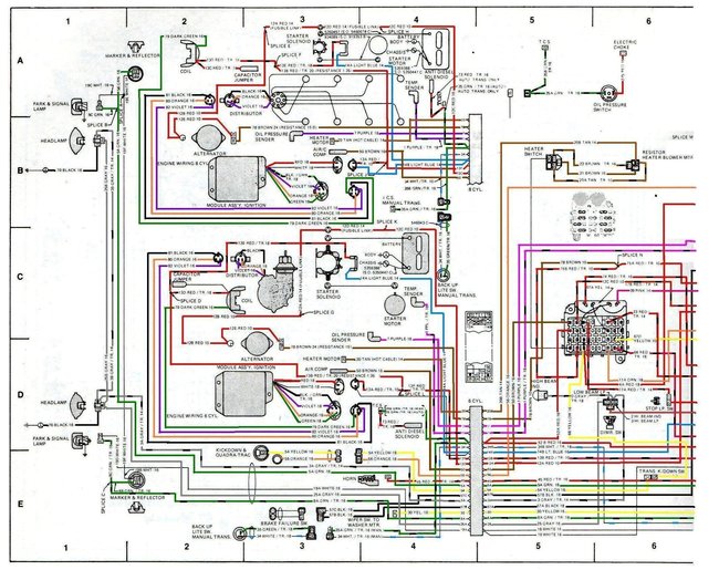

I'm guessing yours is still "mostly" 1978. I have not had a chance to color (in Microsoft Paint) this 1977 diagram (should be the same '76-'78), I'm sending it to you anyway, Maybe you can read it well.
Pic 1 and 2) 1977
Pic 3) From a different source, a close up of the solenoid area '76-'78. I could not find the full diagram in all of my pics.

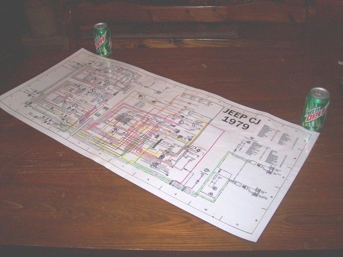

Pic 4 and 5) My 1979 colored diagram
Pic 6) I joined the last two, blew it up, laminated it, it is so easy to trace stuff.

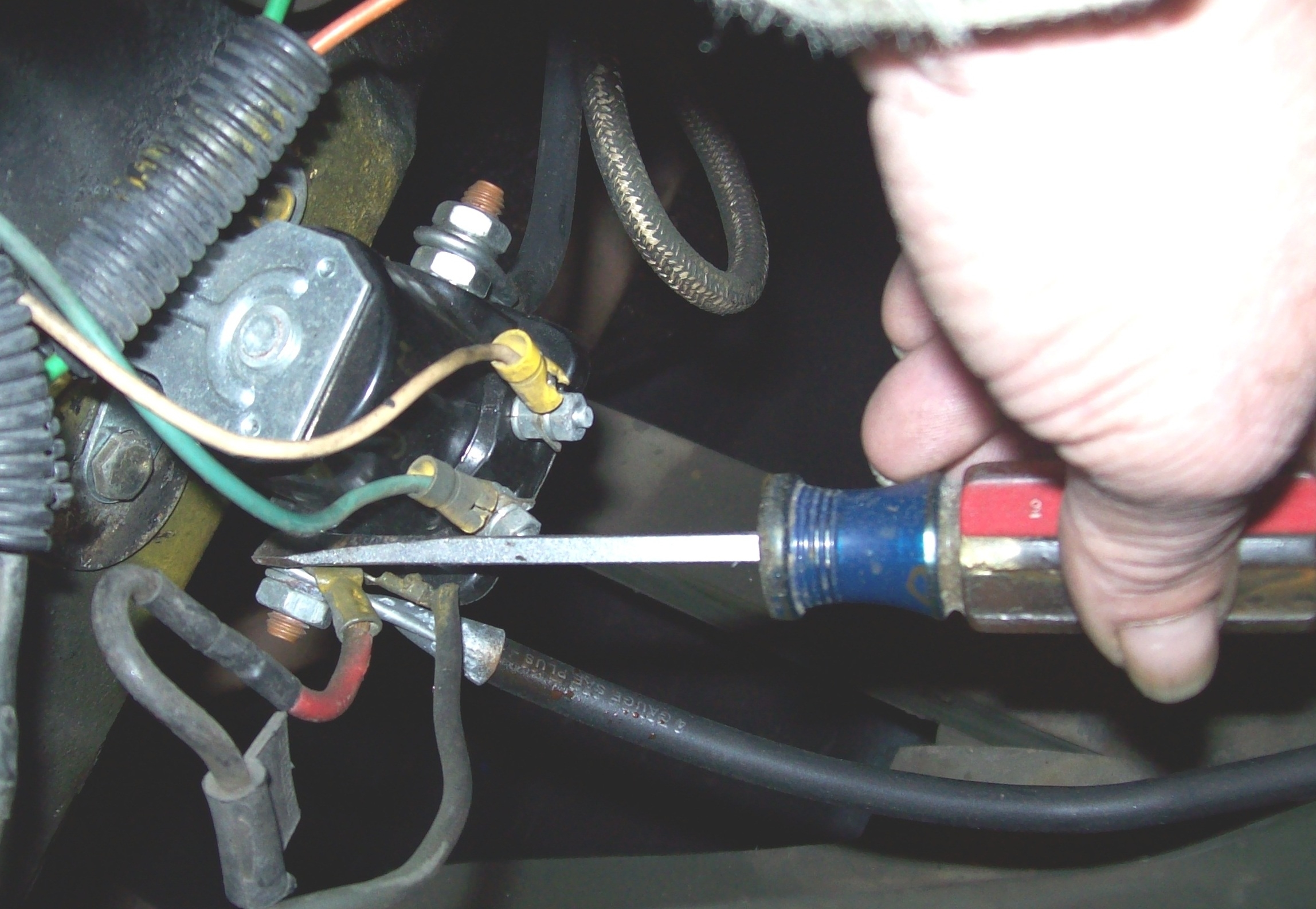

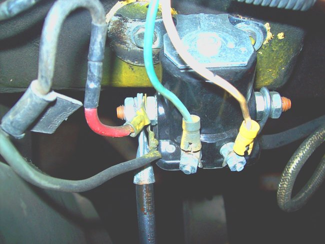

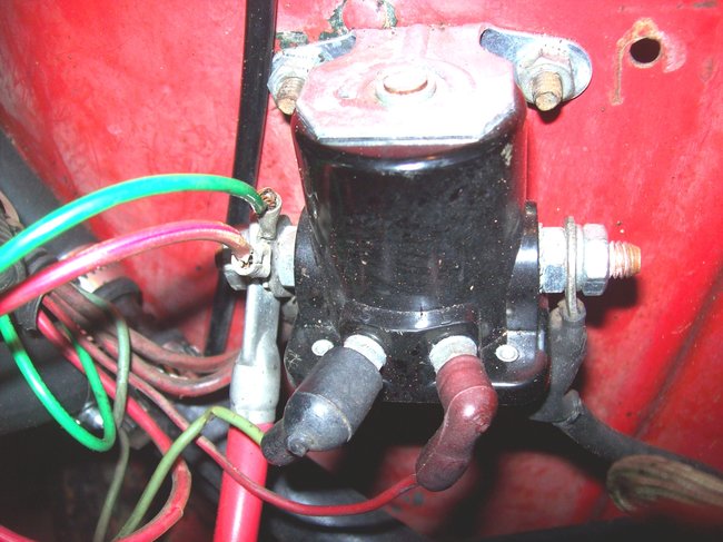

Can you send a picture showing where the wire was?
Here's a picture of my 1977 solenoid, the other is my 1946 pretty much rewired similar to the newer CJs.
Note: I have swapped everything on the big posts to the opposite big post. In other words my "positive stuff" is on the left big post. The starter cable is all by itself on the right side big post. (this is opposite from the original set up)(the solenoid does not care!)
This is now set up more like Ford vehicles of the same period. Best of all, the Positive big post is now close to "S" terminal, the screwdriver can touch both at the same time. This allows me to bump or start the engine using a screwdriver. (last picture)
