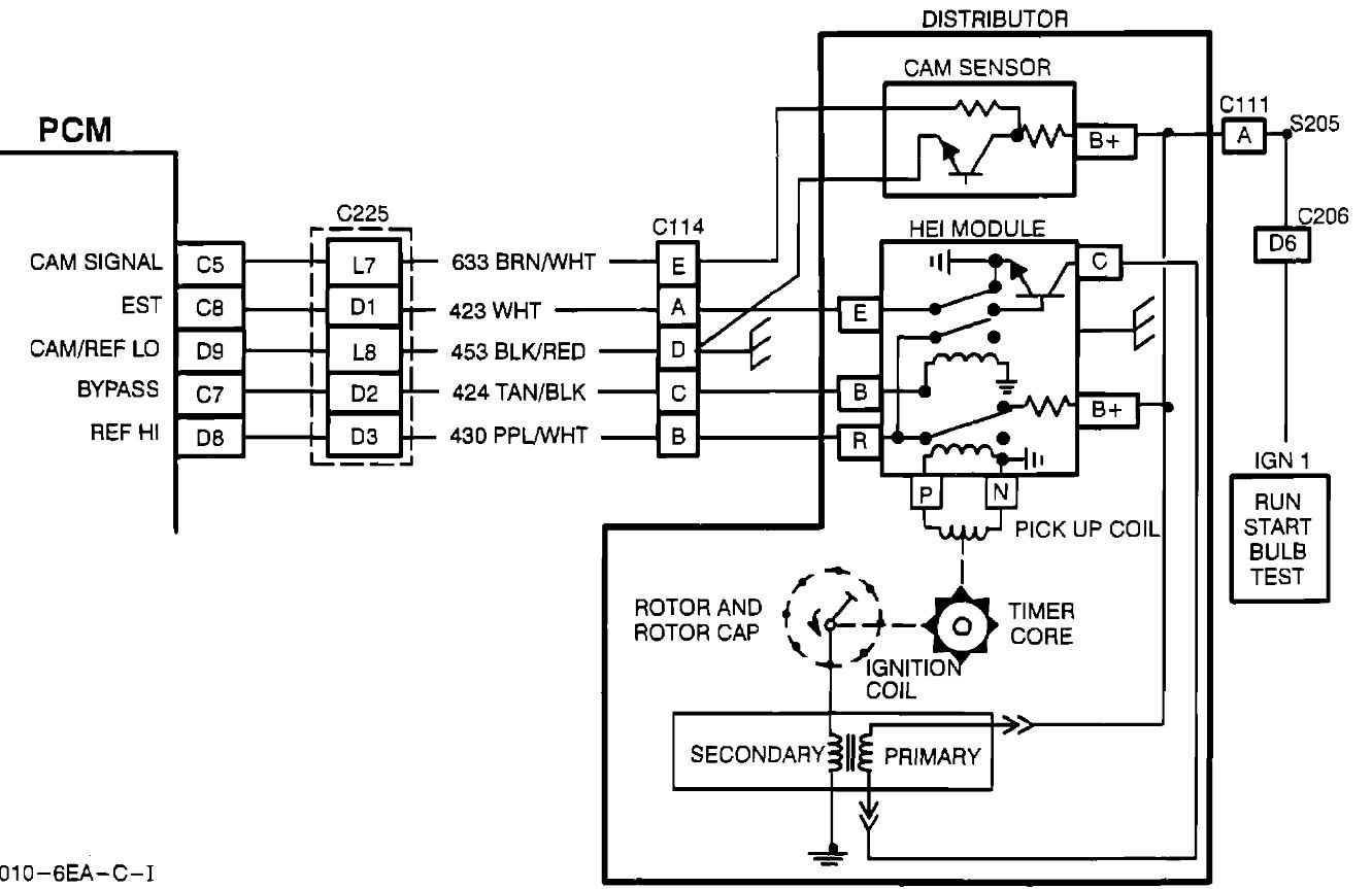

I put a new ignition coil, new control module and rotor. The car still turns over but will not start running. I'm getting a E012 code mean no distributor signal. How can I fix this code?

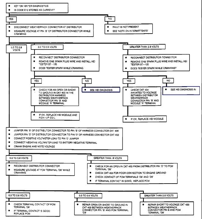

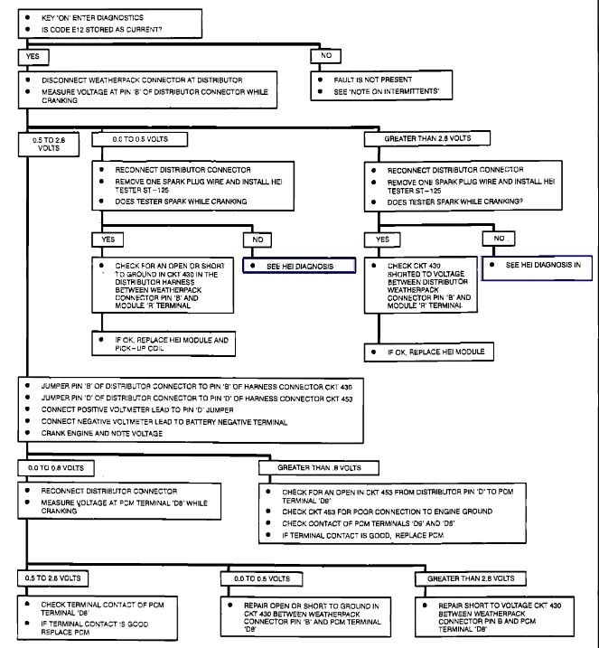

This could be a ground related issue or power supply issue. Here are the diagnostics specific to the code. The attached pics correlate with the directions. Look through them and see if it is something you feel comfortable doing.

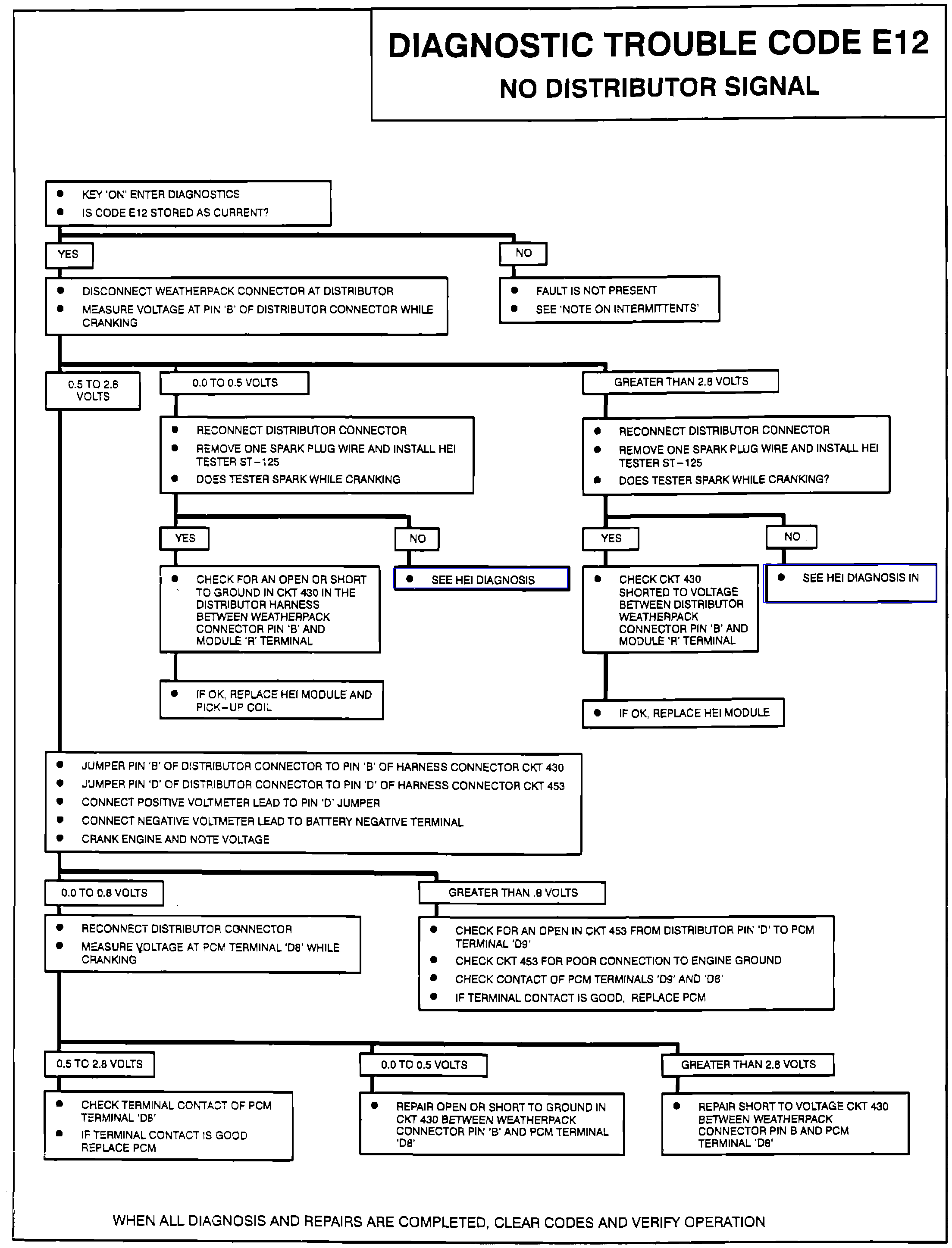

Diagnostic Chart.

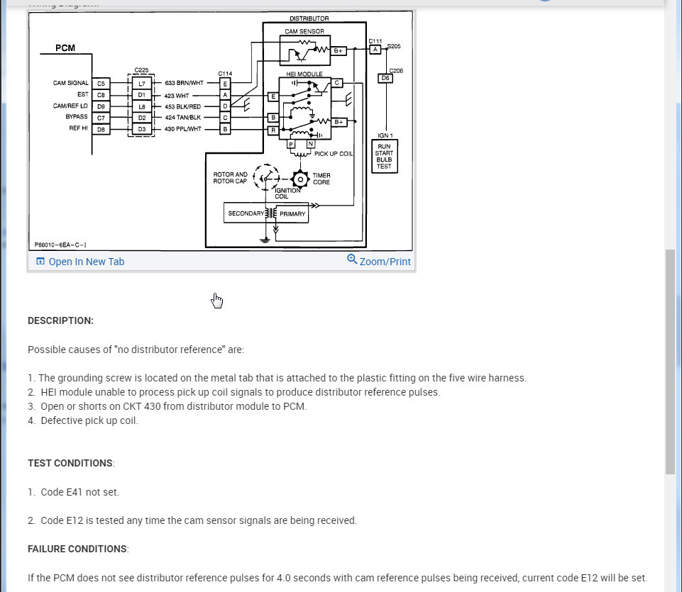

pic 1

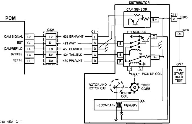

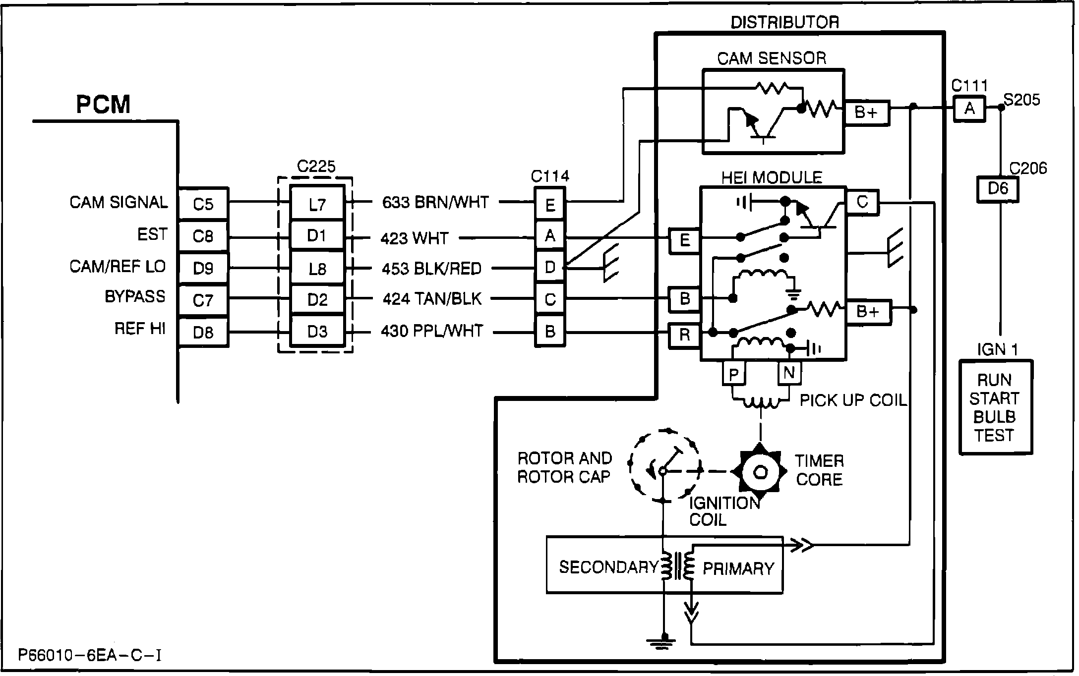

Wiring Diagram.
pic 2

Possible causes of "no distributor reference" are:
1. The grounding screw is located on the metal tab that is attached to the plastic fitting on the five wire harness.
2. HEI module unable to process pick up coil signals to produce distributor reference pulses.
3. Open or shorts on CKT 430 from distributor module to PCM.
4. Defective pick up coil.

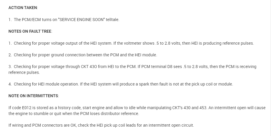

ACTION TAKEN:
1. The PCM/ECM turns on "SERVICE ENGINE SOON" telltale.

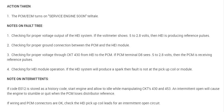

NOTES ON FAULT TREE:
1. Checking for proper voltage output of the HEI system. If the voltmeter shows .5 to 2.8 volts, then HEI is producing reference pulses.
2. Checking for proper ground connection between the PCM and the HEI module.
3. Checking for proper voltage through CKT 43O from HEI to the PCM. If PCM terminal D8 sees .5 to 2.8 volts, then the PCM is receiving reference pulses.
4. Checking for HEI module operation. If the HEI system will produce a spark then fault is not at the pick up coil or module.
NOTE ON INTERMITTENTS:
If code E012 is stored as a history code, start engine and allow to idle while manipulating CKT's 430 and 453. An intermittent open will cause the engine to stumble or quit when the PCM loses distributor reference.
If wiring and PCM connectors are OK, check the HEI pick up coil leads for an intermittent open circuit.

I attached the testing for this code.
Unfortunately we need to run through this testing to find out what the issue is. Review this and tell me what you have questions on and we can work through it.
I suspect you have a wiring issue but this will prove that out.

I have seen this as both a wiring problem and PCM failure but more common was a failed pickup coil in the distributor. The test chart works okay on this one.
The grounding screw is located on the metal tab that is attached to the plastic fitting on the five wire harness. Check that it is grounded.
