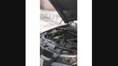

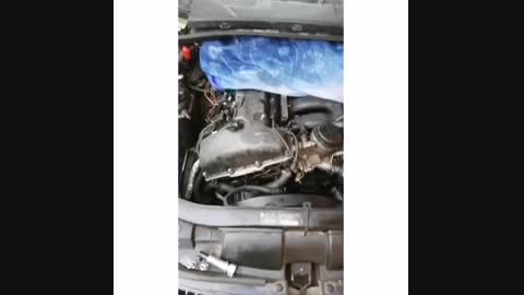

Kindly listen to the video on the latest update.
Wednesday, May 27th, 2020 AT 10:16 AM
Great update using that video. Two things. First the metal shavings that you felt is not a good sign. Most likely that is bearing material and could cause some issues but I don't think it is causing this one. I suspect that tensioner is your issue.
I can't say I have ever checked the tension on an N52 engine but most tensioners that I have felt, I could not compress.
Here is a video of someone changing the tensioner and he squeezes the old one and it does not compress at all. Now this may still have the oil in it but even still when he is installing the new one, it appears to have a lot more tension when he is screwing it in. I may have missed it but was that a replacement tensioner or the existing one? Either way, I would get another and compare it. Even if you took that one down to the parts store and just took the new one out of the box and compared the spring tension.

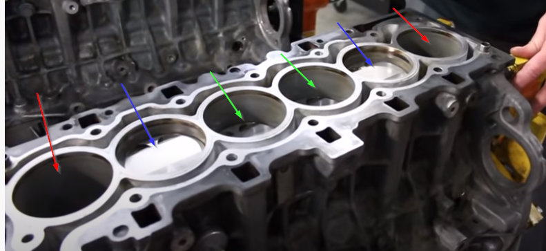

Another thing, I just noticed is that when cylinder 1 is at top dead center cylinder 2 is also at TDC. Is that a good sign or what?
Friday, May 29th, 2020 AT 8:45 AM
That engine sounds like it is knocking or rattling quite a bit. Have you drained the oil and cut apart the filter to see how much metal is in it? Drain the oil into a pan and then pour it through a coffee filter to see how much metal is there.
As for the pistons, that does not sound correct. Take a look at the picture of your block with no head. 1 and 6, 2 and 5, 3 and 4 are synced together and the piston will be in the same position but on opposite strokes. So when 1 is coming up on the compression stroke, number 6 will be coming up on the exhaust stroke.
If you have number 1 and 2 at TDC, they will be on different strokes but that is not correct.
