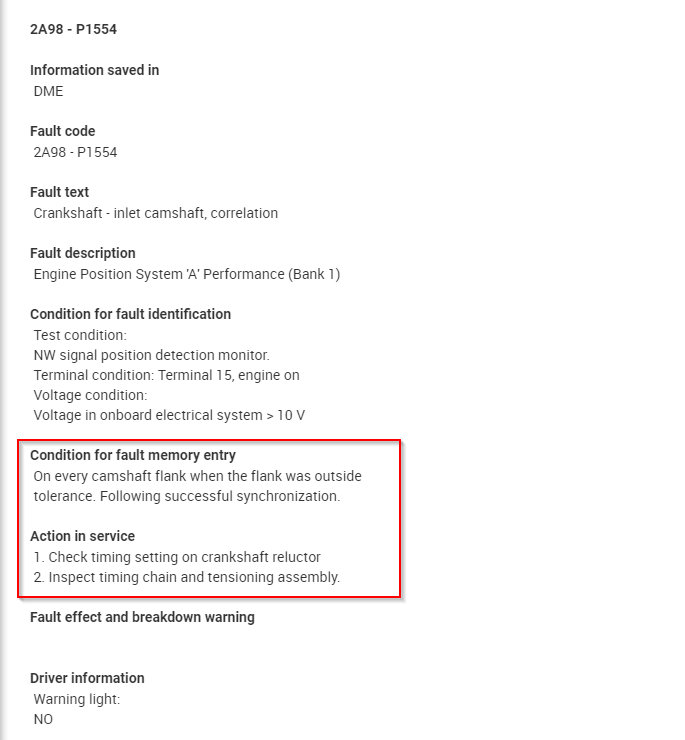

Here is the breakdown of these codes:
P0015 - Cam Bank 1 over retarded
P0102 - MAF circuit low
P0140- O2 sensor no activity Bank 1 sensor 2
P0369 - Cam Bank 1 circuit intermittent
P1553 Engine position performance bank 1
P1554 - Engine position performance Bank 1

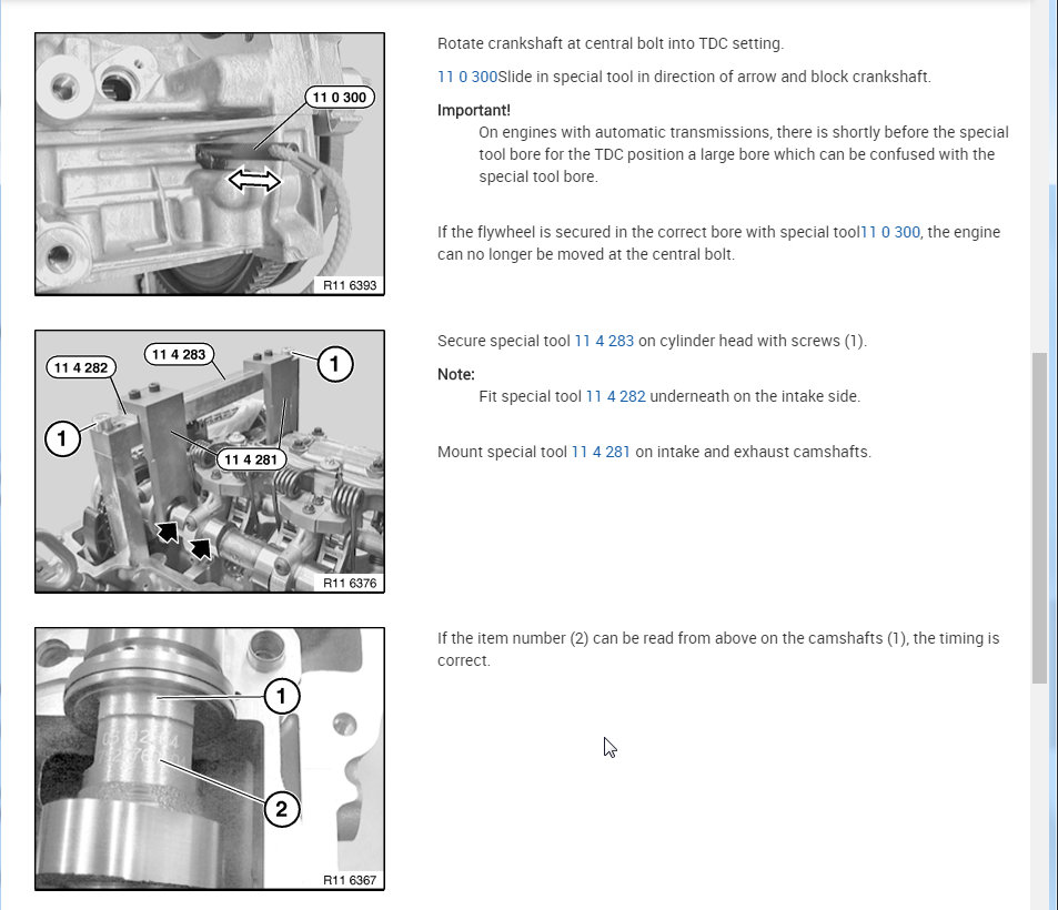

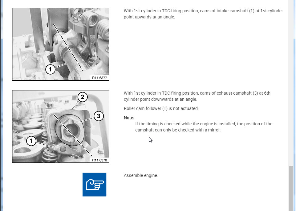

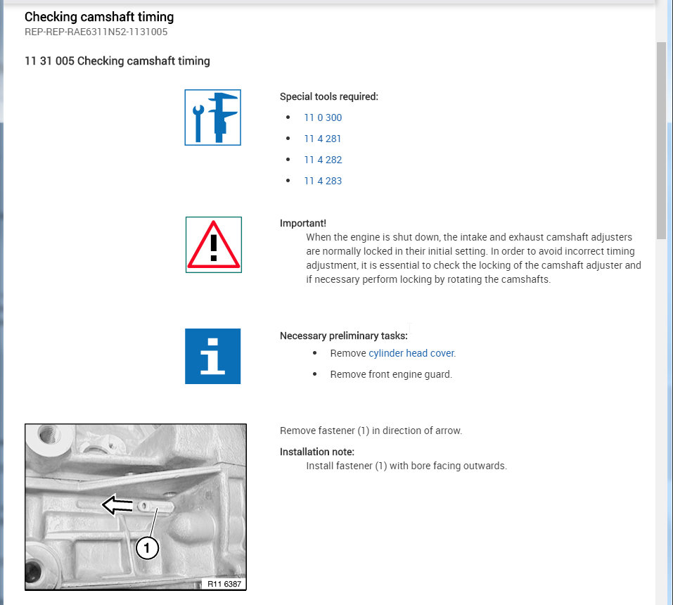

Based on all these and what you are experiencing, it appears the engine is out of time. The backfire was probably when the engine jumped timing and shut off. Unfortunately we are going to need to pull down the engine and check the timing.
I attached the process on how to check the timing. Please let me know if you have questions and we can from there. Thanks

Thanks, can I have a video to show me the process of checking engine timing?
Mar 27, 2020 at 11:41 AM
Unfortunately we don't have a video on this engine. The best I can do are the instructions I provided. I looked online for a video but could not find one on your engine assuming you have the M54 engine. Is this accurate or do you have a different engine?

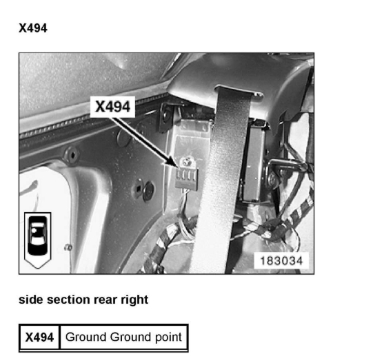

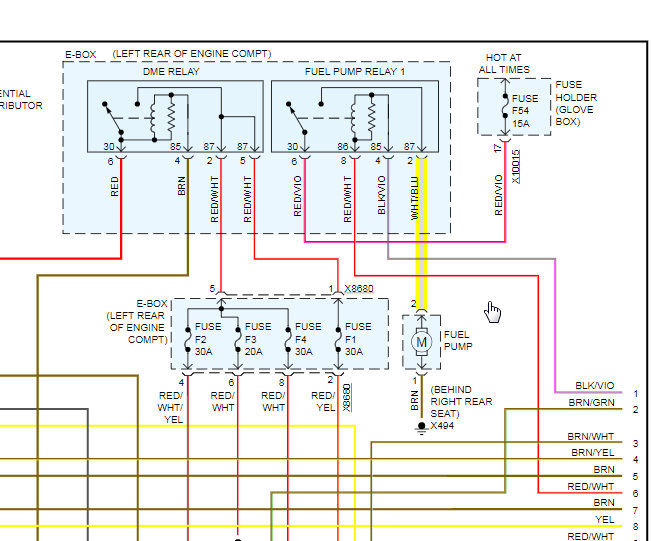

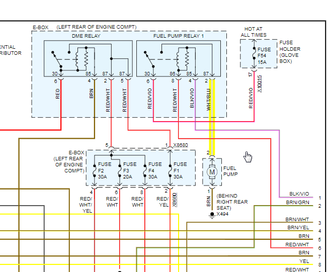

I just noticed that the voltage the fuel pump is 7.5v and not up to 12v.
My question is, what could be the course of this problem and where can start from in diagnosing this issue?

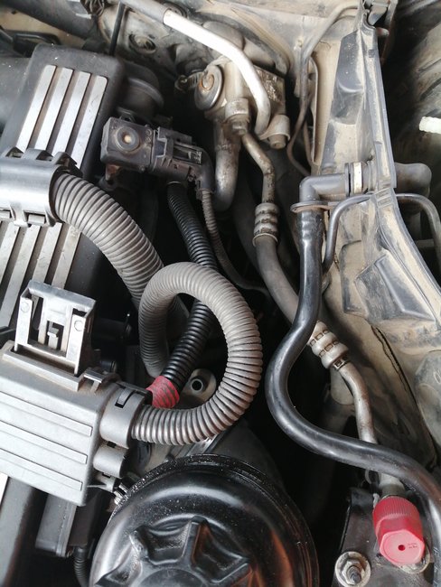

Code I still get are p1124, p0205 and p0102.
Apr 11, 2020 at 3:59 AM
Okay. The P1124 is a throttle position sensor out of range.
P0205 - Is an injector circuit out of range.
The fuel pump only having 7.5 volts is normally caused by resistance in the circuit or a faulty ground. The ground is X494 which is behind the right rear seat. I would suggest taking the fuel pump relay out and unplug the fuel pump, then measure resistance from Pin 87 from the relay to the fuel pump connector. You should have less then a half ohm of resistance.
Then check the ground and make sure it is clean and tight.

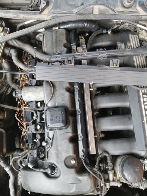

The only thing I have not change is the coil and I tested all 6 as I saw In this video. I didn't get the same reading as to the video. So can all 6 coil go bad at once.

It is unlikely that all would fail at the same time. What were the readings you were getting on the primary and secondary side of the coils?
Your primary side should be around 1 ohm. The secondary side could vary depending on the coil as you saw in that video. As long as you are getting between 5,000-20,000 ohms of resistance, it should be okay.

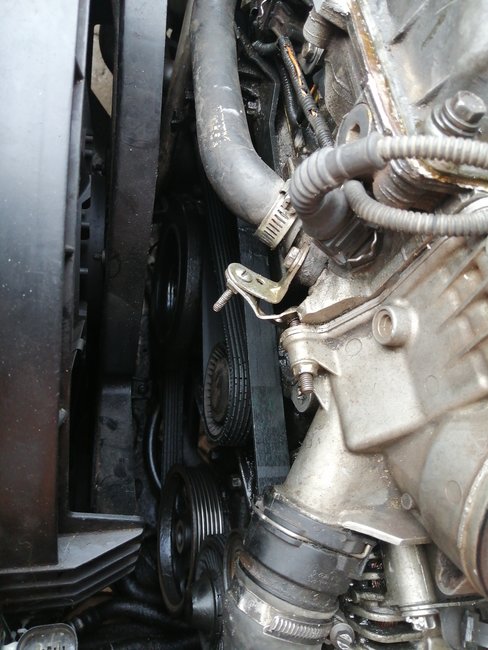

Let me time back the engine and tight the tensioner bolt and see what will happen.
May 24, 2020 at 6:28 AM
Okay. Sounds great. Before you mess with the bolt, just push on the chain and see if there is much slack. There should be very little. It should feel pretty tight. At least that will give us some idea that we are on the right path. Thanks
May 24, 2020 at 7:55 PM
UZOMAKIY OKPALA
  • 41 POSTS
I have done it and the chain looks pretty tight, because I was touching it while a turn the engine manually. Set timing and start the car and it runs poorly only if I press the pedal and it never revved pass 3 rpm and later shut off the same way. After 3 attempts with the same thing car won't start and gives car codes p0015, p0102, p0205, p0203 and p1124.

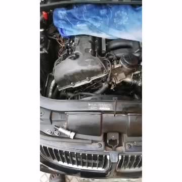

Kindly listen to the video on the latest update.
May 27, 2020 at 10:16 AM
Great update using that video. Two things. First the metal shavings that you felt is not a good sign. Most likely that is bearing material and could cause some issues but I don't think it is causing this one. I suspect that tensioner is your issue.
I can't say I have ever checked the tension on an N52 engine but most tensioners that I have felt, I could not compress.
Here is a video of someone changing the tensioner and he squeezes the old one and it does not compress at all. Now this may still have the oil in it but even still when he is installing the new one, it appears to have a lot more tension when he is screwing it in. I may have missed it but was that a replacement tensioner or the existing one? Either way, I would get another and compare it. Even if you took that one down to the parts store and just took the new one out of the box and compared the spring tension.

The first start my leg was not on the pedal but the second time it started my leg was on the pedal and it couldn't rave pass 2 rpm then later shot off could not restart again. Tensioner has been replaced.

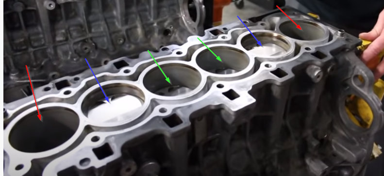

Another thing, I just noticed is that when cylinder 1 is at top dead center cylinder 2 is also at TDC. Is that a good sign or what?

That engine sounds like it is knocking or rattling quite a bit. Have you drained the oil and cut apart the filter to see how much metal is in it? Drain the oil into a pan and then pour it through a coffee filter to see how much metal is there.
As for the pistons, that does not sound correct. Take a look at the picture of your block with no head. 1 and 6, 2 and 5, 3 and 4 are synced together and the piston will be in the same position but on opposite strokes. So when 1 is coming up on the compression stroke, number 6 will be coming up on the exhaust stroke.
If you have number 1 and 2 at TDC, they will be on different strokes but that is not correct.
