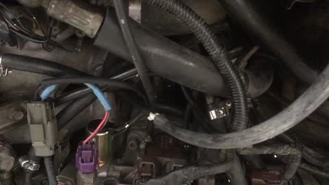

Okay. It appears it does matter so let's switch them and see what happens.
There is a power wire, and the other is the ground but that goes to the PCM and the PCM controls the IAC via the ground. So, if you have them reversed then you are running the motor in the opposite direction.

I switched the wires on the IACV and installed a new fuel pressure regulator but no difference at idle but seemed a little crisper on Highway driving.

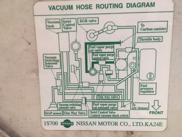

I don't know what's left other than EGR full check out, O2 Sensors (but we disconnected, and it would not idle), MAP, Multifunction TPS, Throttle Body, Weak Fuel Pump at idle? (We tested the pressure at higher rpm - MAF disconnected, is okay), and all the other electrical controlled vacuum switching solenoid valves - swirl control valves - purge valves - one-way valves- etc, smog pump, ECU, etc.

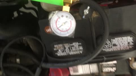

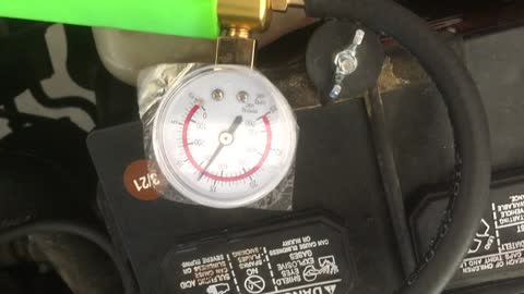

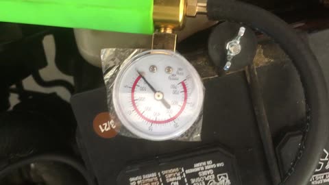

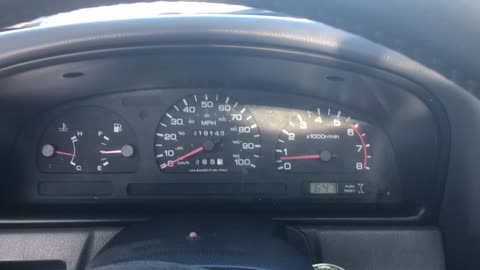

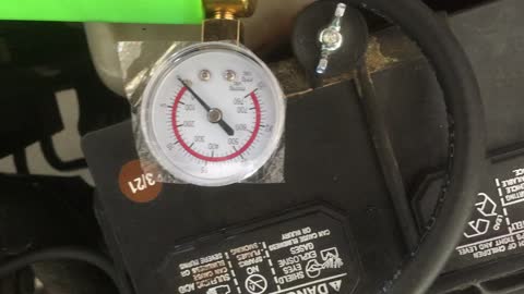

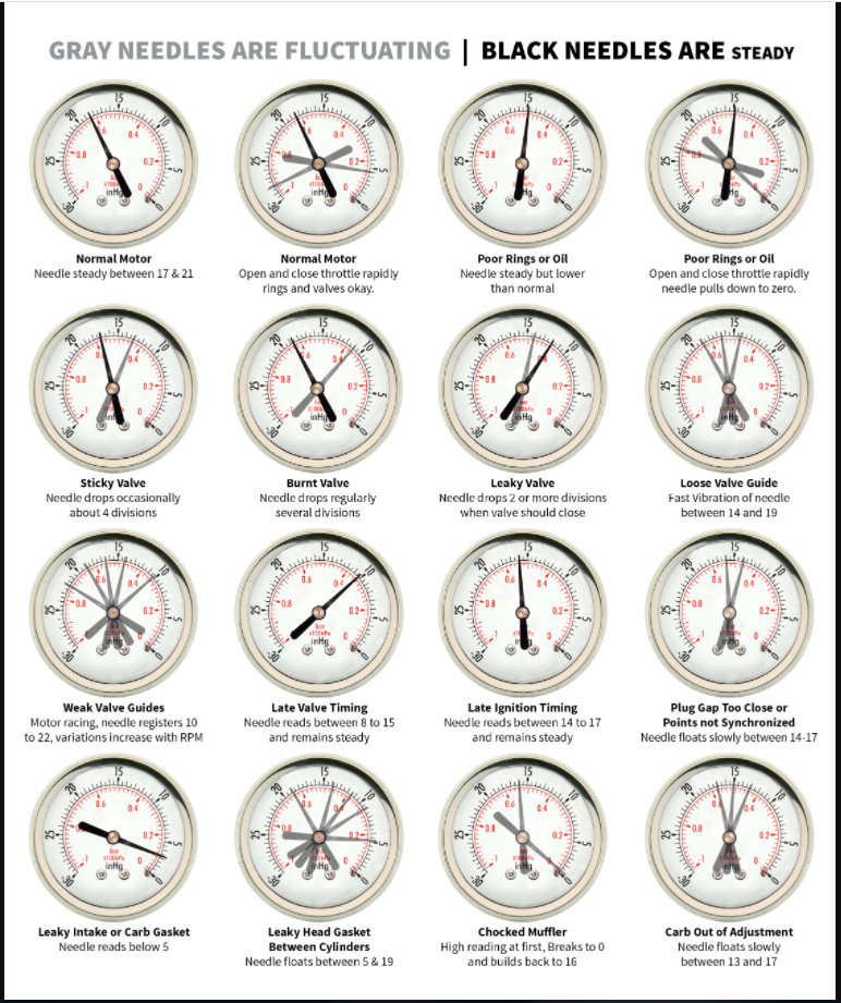

Vacuum Tests Videos - one with MAF disconnected to warm engine up - read 19.5 - Then 2 videos trying to assist it from stalling out. Then 2 videos starting - not assisting idle. One after new fuel pressure regulator and driving 25 miles +/-. One next morning with cold start. 2 Pictures - vacuum Routing and engine/Catalyst info.
Hopefully, these videos will assist in Diagnosis - See Attached.

These are great videos. Take a look at this attachment. You have valve guides or intake valves leaking. Basically, the giveaway is when you start the engine, and the vacuum is low, but the needle is bouncing wildly. This needle should be steady and about 14-20 inches of mercury. The key thing is that the needle is steady and not moving.
Yours is bouncing between 12 and 2 inches which means the intake valves are not selling allowing the engine to build the proper amount of vacuum. This is what is causing the engine to show the fuel trims at full lean because there is more air coming in due to the intake valves not sealing.
The way to narrow in on this is to do what is called a running compression check.
I know you did a regular compression check and found that cylinder four was low and didn't feel confident about that test. However, if that is accurate then we need to start with cylinder four as that is the likely cause of this.

Totally understand. A weak fuel pump can cause similar issues like surging and stalling but it will not cause the vacuum gauge to bounce like that. This is going to be an external vacuum leak exactly as you talked about.
Unfortunately, I think you are looking at valve guides and a valve job to correct this.

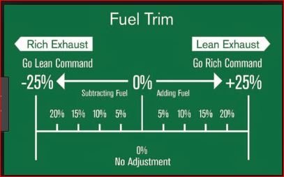

ST FTRM readings confuse the issue for me because with the MAF Disconnected they are as much as - 25 and with the MAF Connected they are mostly +25 - LOL

Okay. I think I have a pretty good understanding as to what is happening. You most likely have an intake valve issue on cylinder 4 if that is low on compression. It is most likely a guide issue causing the valve to hang open.
The reason it smooths out at higher RPMs is because the vacuum needs are lower at higher RPM. Basically, as the engine revs up the valves open faster and the vacuum drops.
Also, when the engine revs faster it can actually cause the valve to break loose and it will seal better. It will never be what it should, but it will be better at higher RPMs.
Also, the actual engine vacuum is not going to care if you have sensors plugged in or not. That is why the gauge bounces like it does.
Clearly, I could be wrong, but you have all the signs of a sticking valve.
