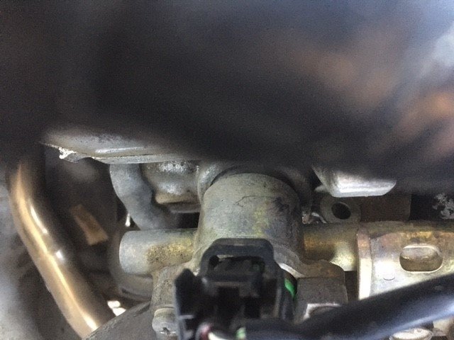

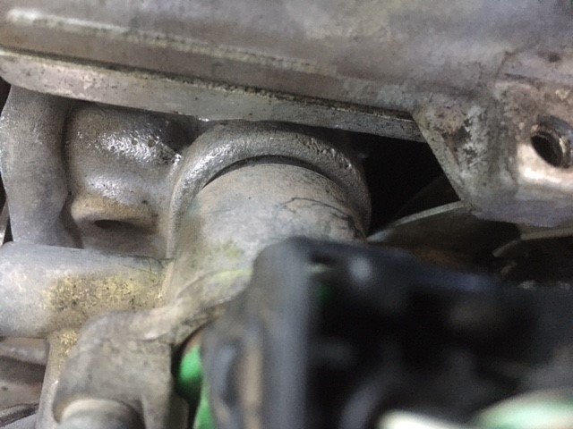

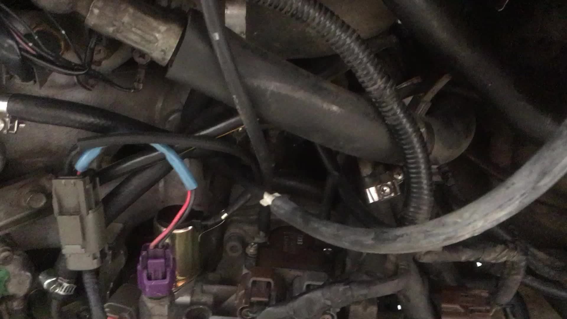

I forgot to send your pictures of manifold area close to the #3 or#4 Injectors - sending now.

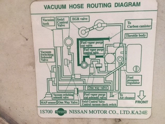

Next, we need to hook a vacuum gauge to the engine and see if we have an internal vacuum leak if you didn't find an external leak.
As for this bolt, if you have no vacuum leak there then that may be an issue, but it is not causing this issue.

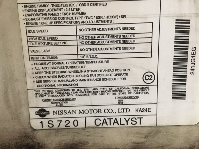

I forgot to mention that this pickup truck is a 1996 SE Model - Changeover model built in 02/96 so many parts are different than models built prior and conforms to California, EPA and US emissions. Also, ECU does not throw any codes and there is no check engine light unless I unplug a MAF sensor, IACV, etc., and then it will come on and throw a code and or codes like P0100, 110,171,300,301,304,505. I clear the codes and they do not come back.

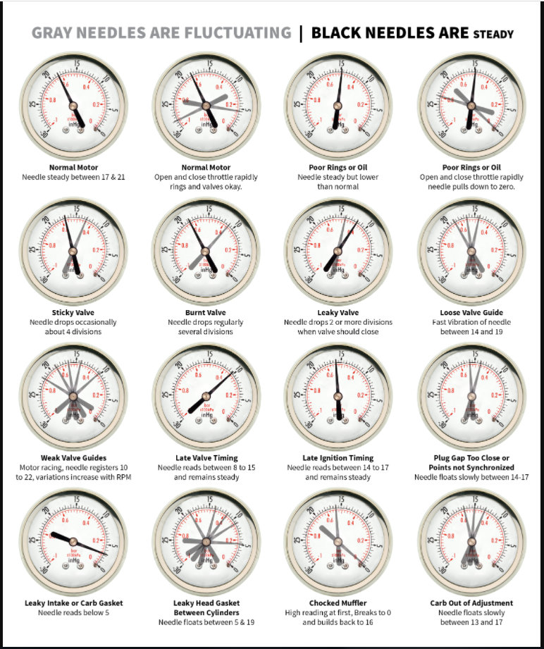

If it is still doing it with the o2 unplugged, then we need to put a vacuum gauge on the engine and see what the internal vacuum is doing.
Here is a chart that will help with this.
May 24, 2022 at 6:35 AM
LWROOS
  • 17 POSTS

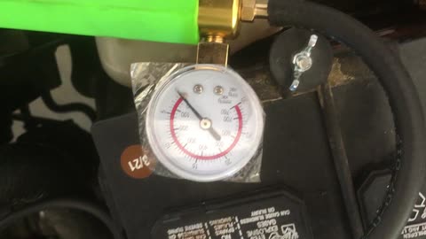

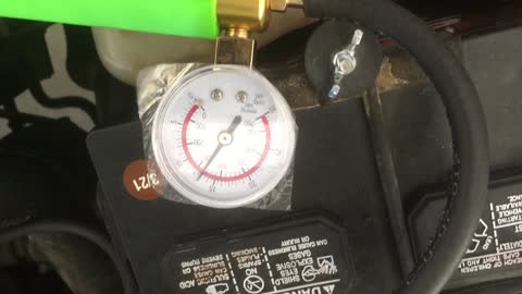

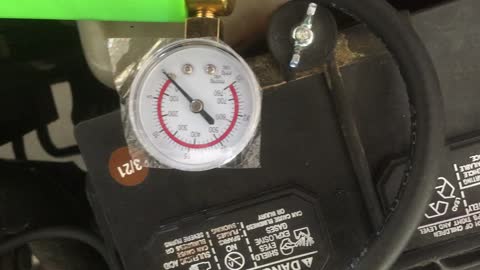

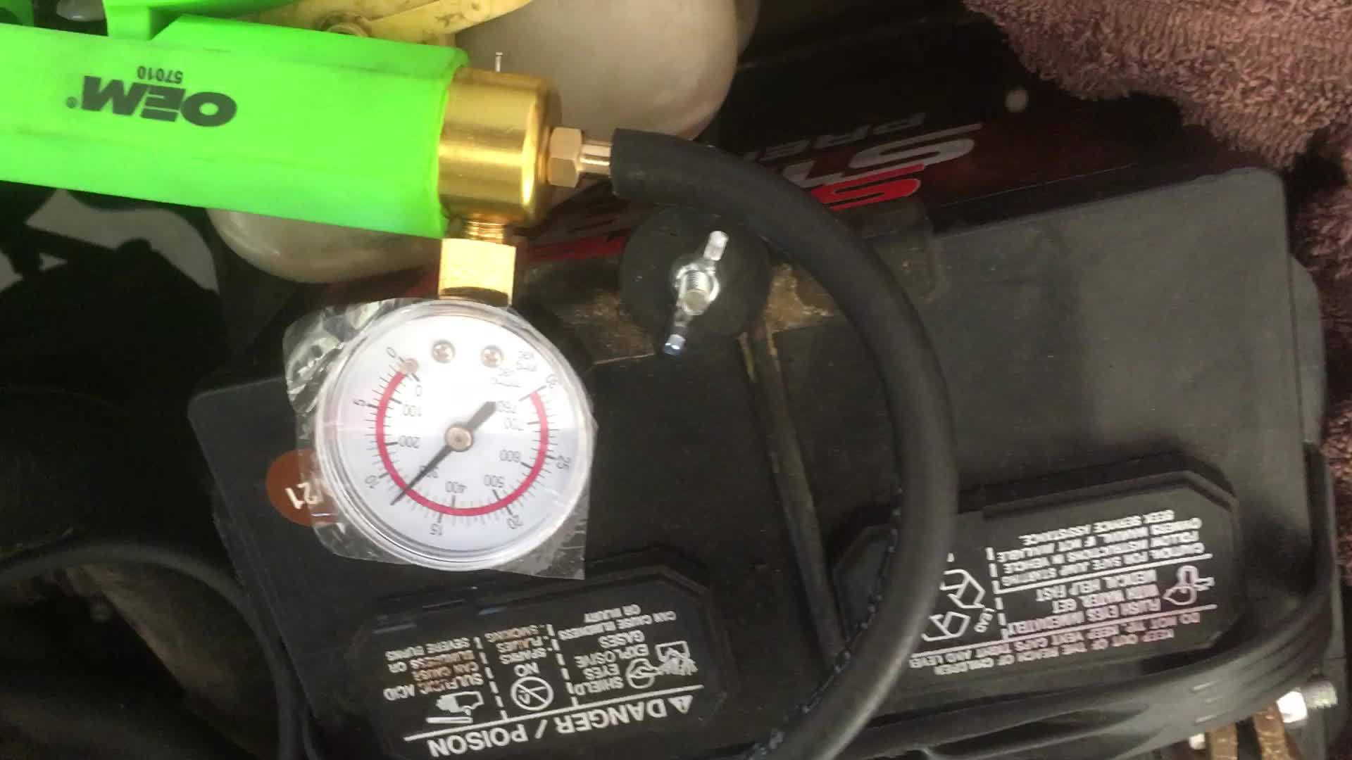

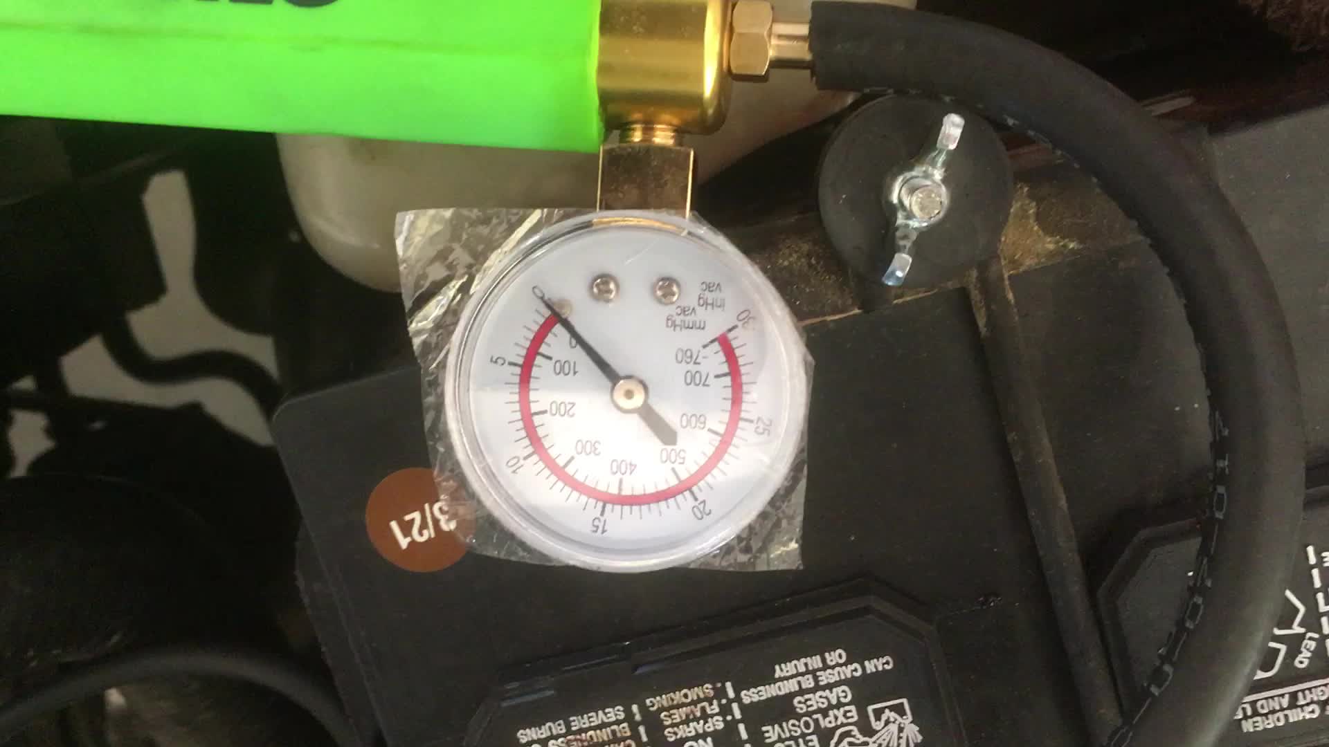

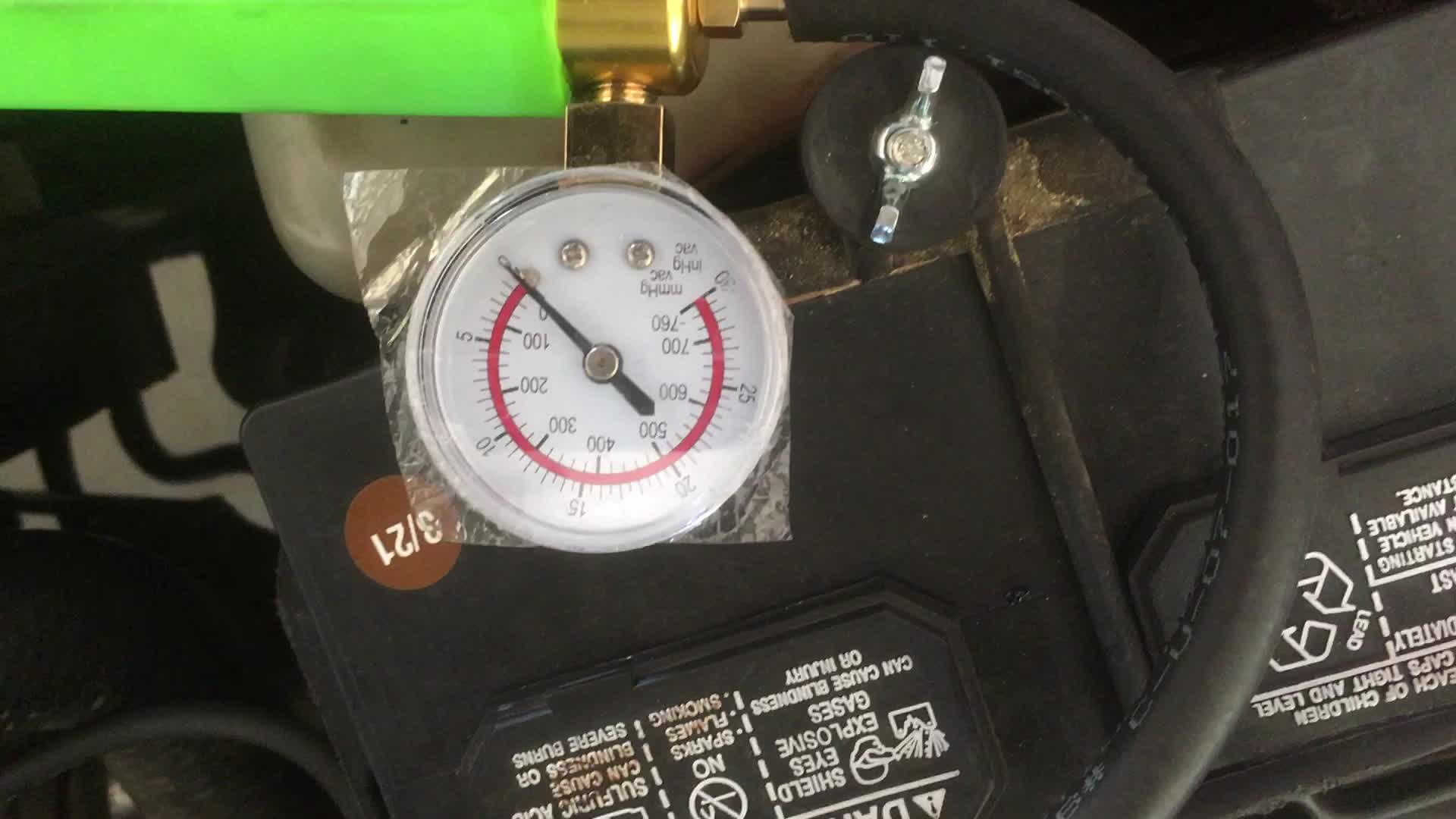

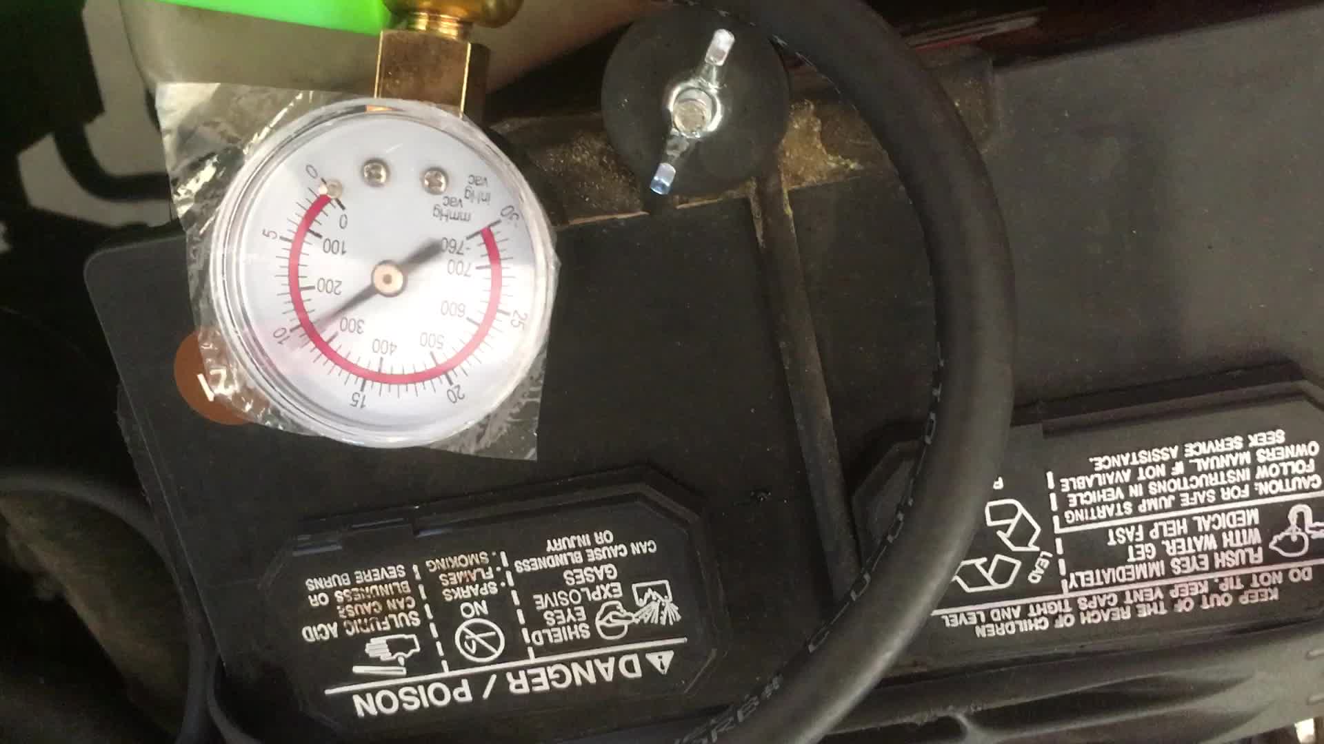

Vacuum Test.
Using a T connector, I connected the vacuum tester to line at base of throttle body area and disconnected the MAF sensor to maintain RPMs at about 1,500 to 1,600 instead of fighting to keep it from stalling out. It read at a steady 19 as per one of my messages to you on 5/22. I must add to my earlier message that at the lower rpm the gauge was jumping all over the dial at lower rpm with the MAF connected. Maybe you could give me instructions on how and where to place the vacuum gauge if I did it wrong.
Sometimes I have sent you a couple of replies on the same day to try to give you additional info. Sorry if I am not communicating properly with you. Please review my messages as I also sent Fuel Pressure, fuel regulator and Compression test etc..
Thanks for your help!!!
Larry
May 24, 2022 at 8:08 AM

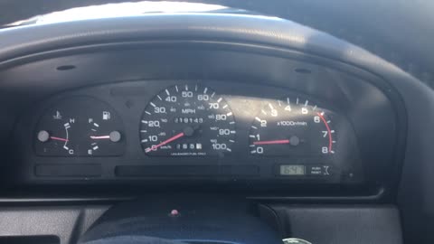

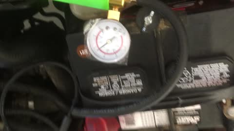

Okay. So, we need to know what the needle is doing when it is jumping around. Can you get a recording of this? Just hook it up as you stated and get a recording of what the gauge is doing and what the RPM is. Even if the engine is running poorly the engine vacuum would be steady if the air intake and valves are running properly.
If the engine is running at higher RPM and the needle smooths out, then we need to revisit a vacuum leak.

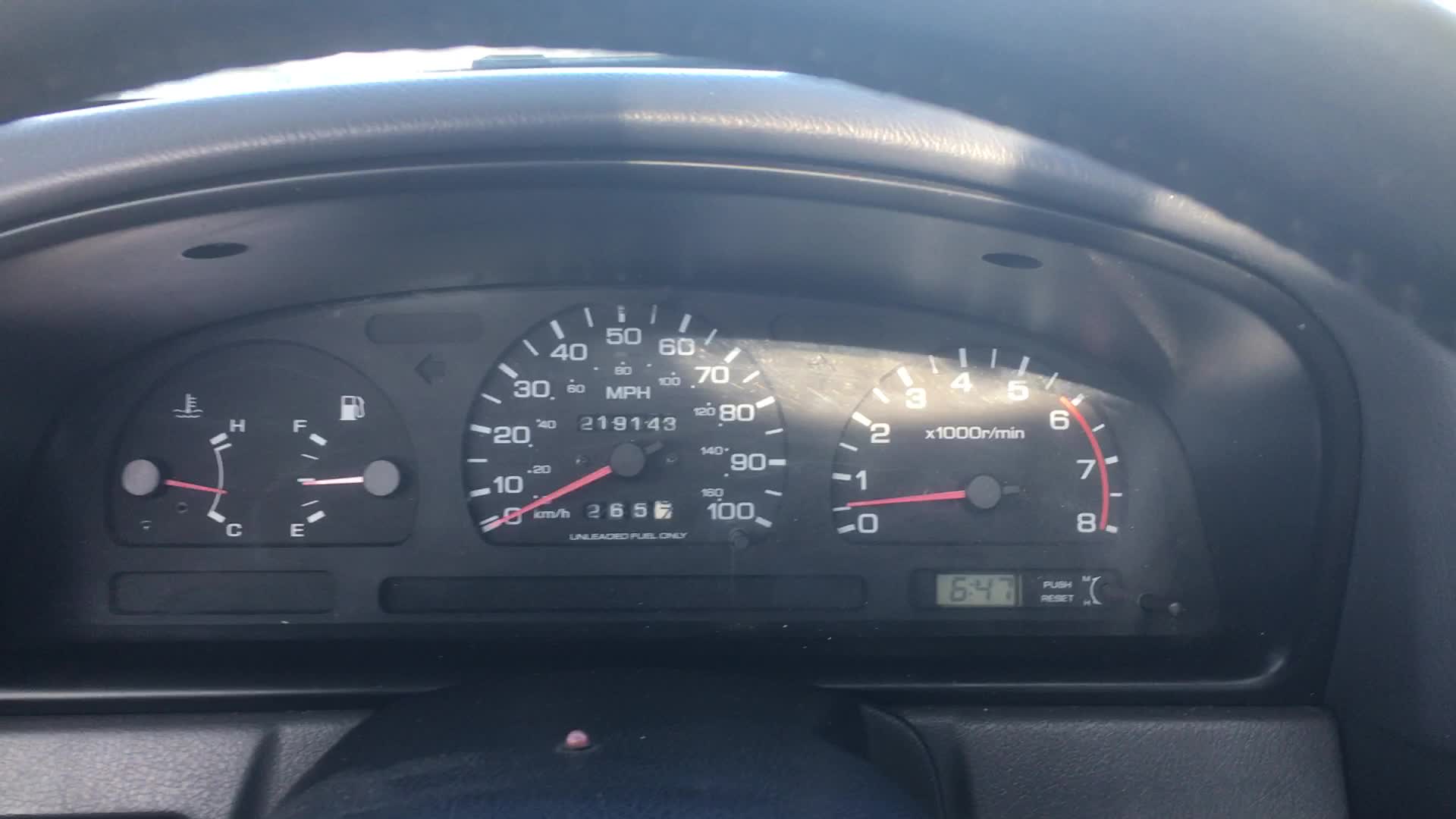

However, let's start with a video of what the needle is doing when you see it bouncing around. Based on the action of the needle it will give us an idea as to what the issue is.

Thanks for your reply! I will attempt this as soon as I can get some help and send you a video.

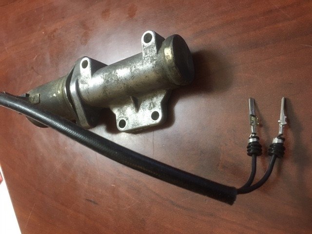

Hey Kenny,
Last weekend I installed my aftermarket IACV and both wires tips are the color of Red just prior to the pin connectors so thinking it didn't matter I hooked it up. Now I wonder and don't know if I screwed up in case one of them is supposed to be a hot wire and the other one a ground wire or link to the ECU. My old unit was the same way except the color was black on both tips. Neither units have any markings on the wires or pin connectors. Of course, it didn't fix this idle issue but if it is hooked up wrong maybe the IACV is not functional???
Please advise me if i should switch them at the connectors.
This weekend with some help I will get you the video of Vacuum Test a different RPMs.

My IACV wiring question was about hooking up both wires tips to the connector plug. I understand one should be power when IGN Key on and the other communicates with the ECU.
The new IACV I installed wires have red colored tips on both and my old IACV has Black colored tips on both wires. Neither have any kind of marks showing which is a positive or negative lead wire. So, I assumed it didn't matter and hooked it up. Now I am wondering if the valve is not working or working in reverse. I can't find any info on the internet nor from any sellers, so I thought I'd ask you.

Here's a pix of the IACV Valve.

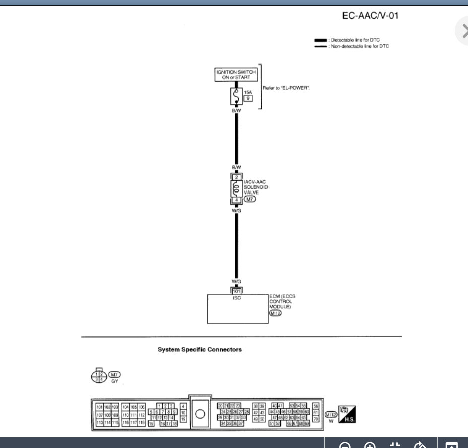

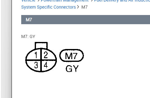

You are correct that one wire is the power feed which is a shared power wire so you can find this by starting the engine and check for power.

The problem I am having is that the two wires on the Old and New IACV have no markings as to which go to power #2 pin or ECU Signa #4, so I do not know if it is hooked up backwards or if it even matters - LOL. None of the aftermarket sellers seem to provide this information on the wiring of the valve.

Okay. It appears it does matter so let's switch them and see what happens.
There is a power wire, and the other is the ground but that goes to the PCM and the PCM controls the IAC via the ground. So, if you have them reversed then you are running the motor in the opposite direction.
May 27, 2022 at 6:28 AM
LWROOS
  • 17 POSTS
Hi Kenny,
I switched the wires on the IACV and installed a new fuel pressure regulator but no difference at idle but seemed a little crisper on Highway driving.
So far from my research through internet articles and videos I began chasing parts which is not good due to very limited funds.

Vacuum Tests Videos - one with MAF disconnected to warm engine up - read 19.5 - Then 2 videos trying to assist it from stalling out. Then 2 videos starting - not assisting idle. One after new fuel pressure regulator and driving 25 miles +/-. One next morning with cold start. 2 Pictures - vacuum Routing and engine/Catalyst info.
Hopefully, these videos will assist in Diagnosis - See Attached.
May 29, 2022 at 6:35 AM
These are great videos. Take a look at this attachment. You have valve guides or intake valves leaking. Basically, the giveaway is when you start the engine, and the vacuum is low, but the needle is bouncing wildly. This needle should be steady and about 14-20 inches of mercury. The key thing is that the needle is steady and not moving.
Yours is bouncing between 12 and 2 inches which means the intake valves are not selling allowing the engine to build the proper amount of vacuum. This is what is causing the engine to show the fuel trims at full lean because there is more air coming in due to the intake valves not sealing.
The way to narrow in on this is to do what is called a running compression check.
I know you did a regular compression check and found that cylinder four was low and didn't feel confident about that test. However, if that is accurate then we need to start with cylinder four as that is the likely cause of this.
May 29, 2022 at 1:07 PM

So, as I understand with the engine trying to idle but surging, stumbling and quick stalling out the vac test points an internal engine vac leak. Therefore, to a valve job due to bad valve guides and or valves not seating properly. Is that correct?
What threw me off is the engine seems to run normal at higher idle rpm and while driving at city and highway speeds but just won't idle at a stop without assistances due surging, stumbling and quick stalling. I cannot hold a steady idle rpm pressing the accelerator pedal below 1,000 -1,400 RPMs in or out of gear, LOL.
Also, the vacuum test with the MAF disconnected the engine seems normal and smooth but creates idle at around 1575 in Park and 938 in Drive the reading hold pretty steady at 19 -19.5.

I am sorry I didn't take the vacuum test properly the first time along with the fuel pressure and compression test. I can also see the importance of videos sent to you.
I did learn how to take videos on my phone - AirDrop them to my email - follow the link to AirDrop site - download to my computer and upload to you among all the other things I am learning from you.

Okay. I think I have a pretty good understanding as to what is happening. You most likely have an intake valve issue on cylinder 4 if that is low on compression. It is most likely a guide issue causing the valve to hang open.
The reason it smooths out at higher RPMs is because the vacuum needs are lower at higher RPM. Basically, as the engine revs up the valves open faster and the vacuum drops.
Also, when the engine revs faster it can actually cause the valve to break loose and it will seal better. It will never be what it should, but it will be better at higher RPMs.
Also, the actual engine vacuum is not going to care if you have sensors plugged in or not. That is why the gauge bounces like it does.
Clearly, I could be wrong, but you have all the signs of a sticking valve.
