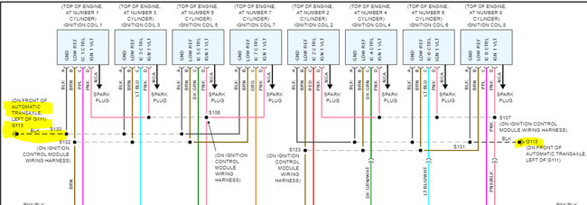

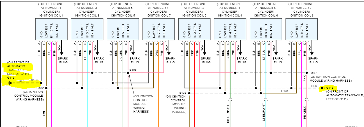

If you replaced the sensor there is either a connection issue, a faulty sensor, or something that has failed in the ECU. By chance, did you get the sensor online? I have been seeing so many faulty parts online. Also, if you have a live data scan tool, did you check for an RPM signal when cranking the engine?
You could have voltage to the coils, but to complete the circuit for spark, there needs to be a signal ground from the ECU. There is also a ground on the transmission for all coils.
At each coil, there will be a black wire. That is the ground for all coils. Confirm there is continuity to ground on all black wires.
If there is, at each coil you have a pink wire which is power, the black that I mentioned, a brown wire which is the signal ground, and a fourth will be different of each coil. Check to see if there is a signal ground at each of the signal grounds as well when the engine is cranking.
Check these two things and let me know. Also, check for a ground on the black wires as well.
So, you have a reference, I attached the coil schematic below. Also, let me know how you reprogrammed the ECU and if you still have the original crank sensor, switch it with the new one and see if you get spark.
See pic below.

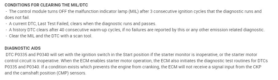

You know, this all started when the sensor was replaced. Was there an issue requiring the sensor replacement? If so, let me know what it was. Additionally, check to see if there are presently any diagnostic trouble codes.

What immobilizer code are you getting? The 315 is for the cam sensor and 335 is the crank. There is no signal to the ECM.

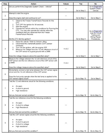

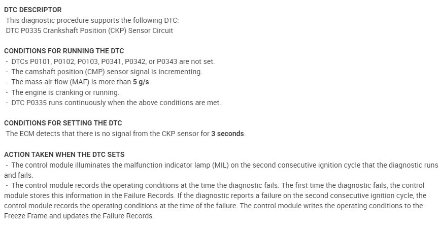

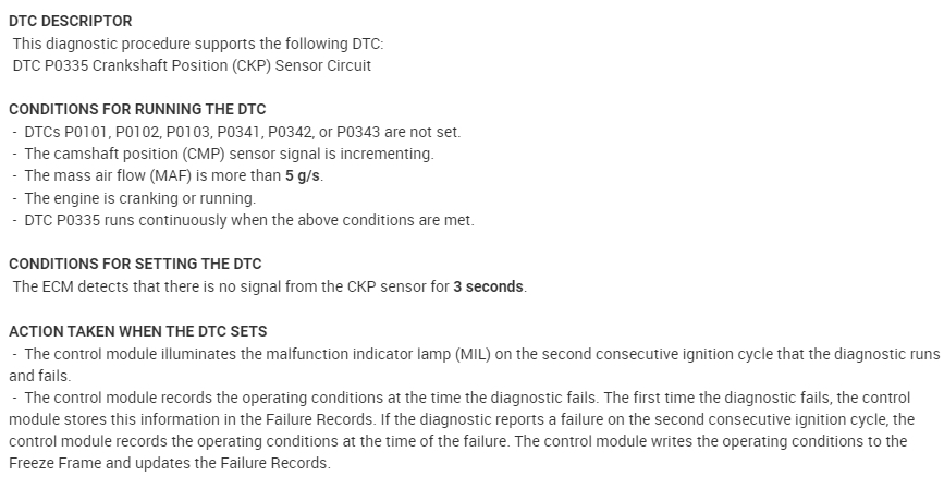

Is the new sensor under warranty? If it is, switch it with a new one. You may have gotten a bad one. Also, if the cam sensor was also replaced, do the same.

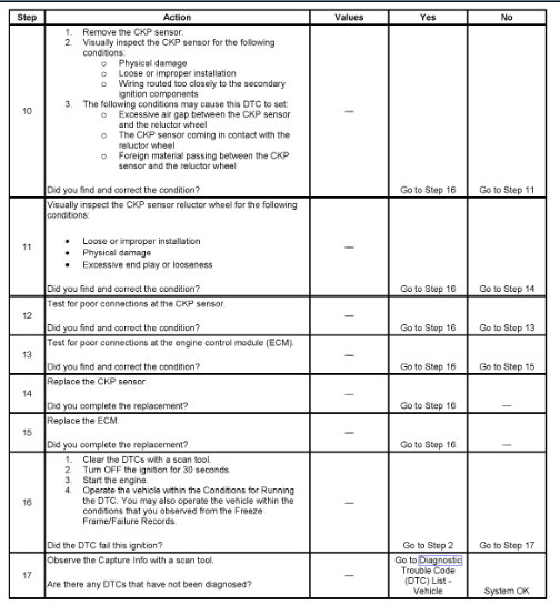

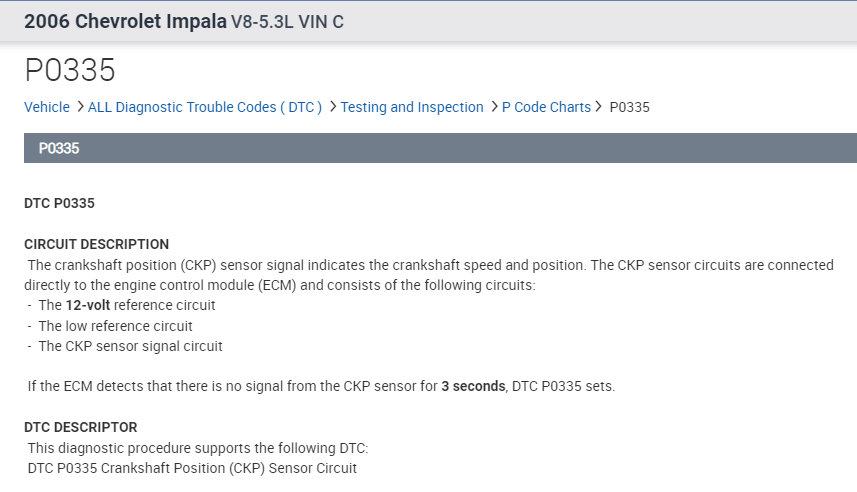

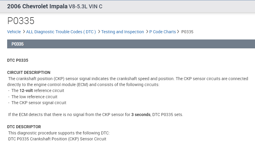

I attached the diagnostics below for the P0335. We need to start somewhere to see why we aren't getting a crank signal to the PCM.

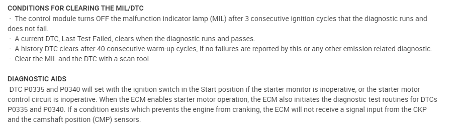

Are you using a good key? Have you tried a different one? If the antitheft light is on, will it turn off after approximately 10 minutes with the key in the run position?
The problem is caused by the immobilizer not recognizing the key. When a condition exists which prevents the engine from cranking, the ECM will not receive a signal input from the CKP and the camshaft position (CMP) sensors. We've had codes from both.

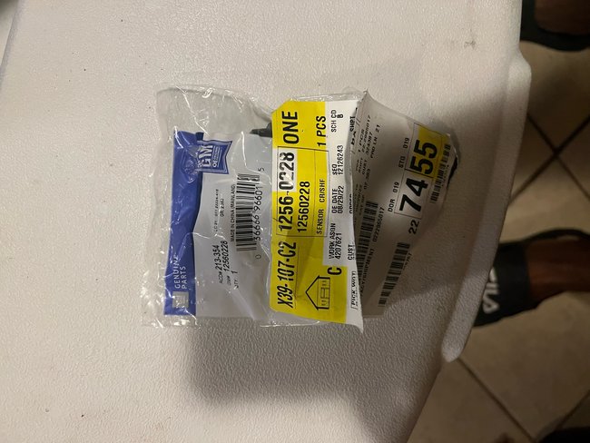

i ordered and just received a new crank sensor. It's a GM part 213-354. If I install this new sensor, will I have the same issue? I have attached a pic of the part.
Sep 23, 2022 at 10:09 PM
  • 110,244 POSTS
Hopefully, that will take care of the issue, but there is no guarantee. The problem could be with the wiring or module.
