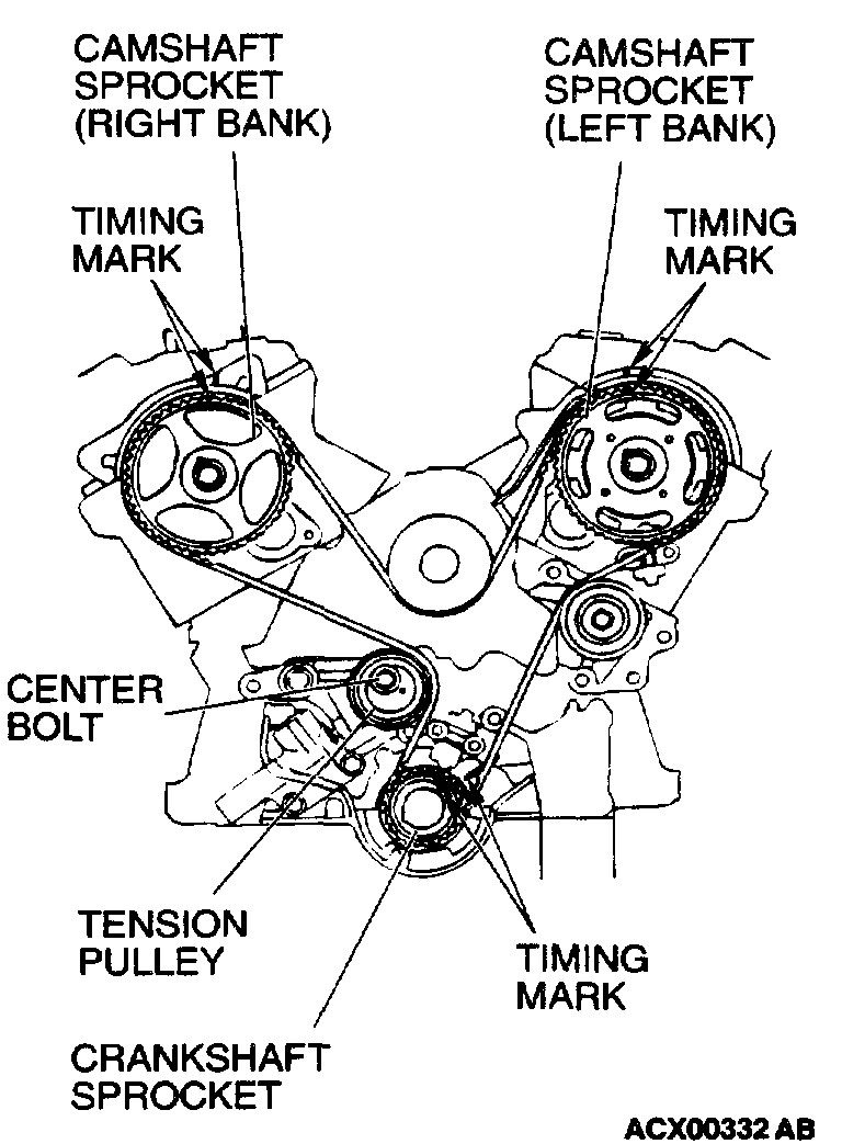

Starter works, spins engine. Timing belt is intact and turns cams. Have spark at the coils.
Turns over but will not fire off. Tried spraying Engine Start into fuel system this wouldn't work either. Can't understand why it wont work. Any ideas of where else to test or what might be causing this issue?

If you have spark and it still won't start for a couple seconds using starting fluid, I suspect there is an issue with timing or engine compression. Although the timing belt is there and turning the cams, they could be off time. That will result in lowered engine compression and a no start.
With that, the first thing I would do is check the engine compression. Here is a link that shows in general how it is done:

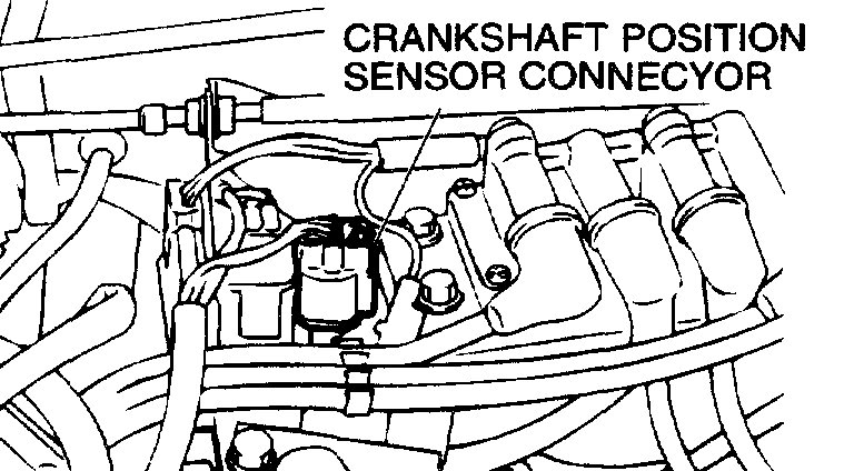

4. Disconnect the crankshaft position sensor connector.
NOTE: Doing this will prevent the powertrain control module from carrying out ignition and fuel injection.

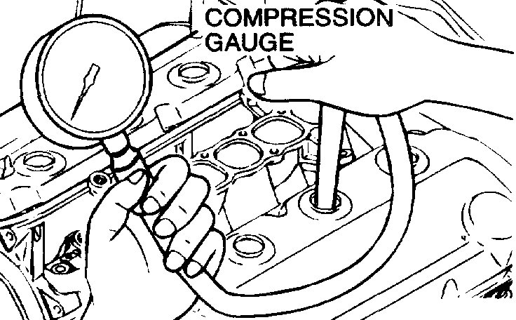

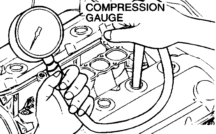

6. Set compression gauge to one of the spark plug holes.
7. Crank the engine with the throttle valve fully open and measure the compression pressure.
Standard value (at engine speed of 250 - 400 r/min): 1,200 kPa (171 psi)
Minimum limit (at engine speed of 250 - 400 r/min): 890 kPa (127 psi)
8. Measure the compression pressure for all the cylinders, and check that the pressure differences of the cylinders are below the limit.
Limit: 98 kPa (14 psi)

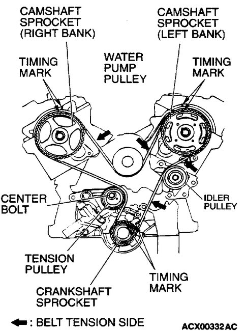

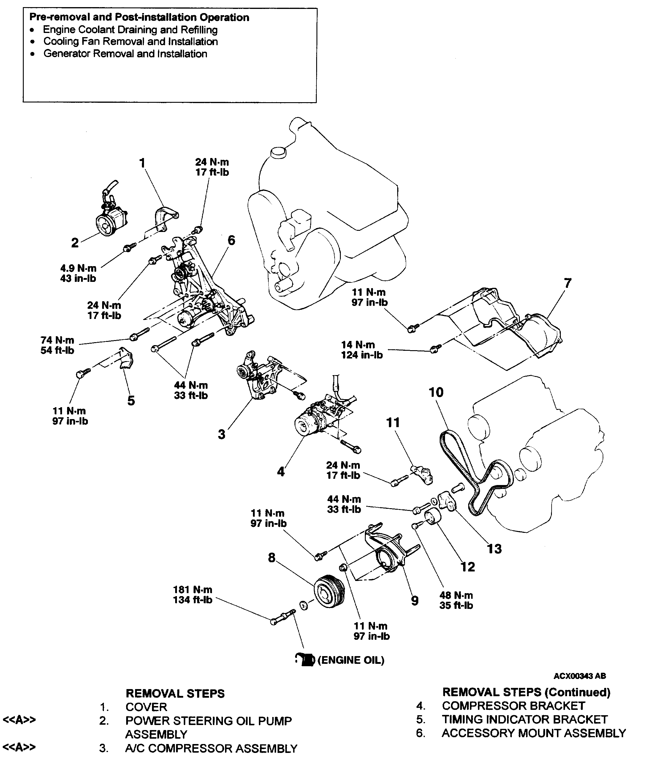

If you find the compression to be low, you will need to confirm the belt has not jumped time. I will provide the directions for belt replacement which includes timing mark locations and how to set timing.

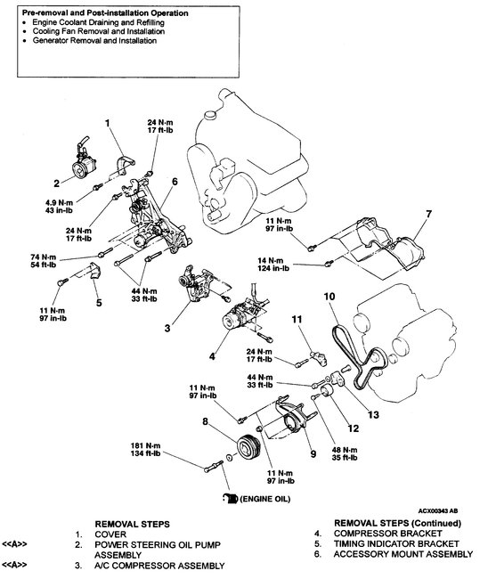

REMOVAL AND REPLACEMENT
pic 3
pic 4
REMOVAL AND INSTALLATION
REMOVAL SERVICE POINTS
[[A]] POWER STEERING OIL PUMP ASSEMBLY / A/C COMPRESSOR ASSEMBLY REMOVAL
1. Do not disconnect the hoses to remove the pump and compressor.
2. Support the removed pump and compressor with a wire, etc. so that they will not get in the way while working.

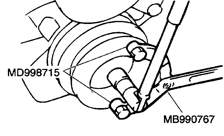

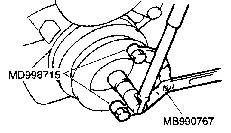

[[B]] CRANKSHAFT PULLEY REMOVAL
pic 5
Use special tools MD998715 and MB990767 to remove the crankshaft pulley from the crankshaft.
[[C]] TIMING BELT REMOVAL
CAUTION: Never turn the crankshaft counterclockwise.
pic 6
1. Turn the crankshaft clockwise to align each timing mark and to set the number 1 cylinder to compression top dead center.
2. If the timing belt is to be reused, chalk mark the flat side of the belt with an arrow indicating the clockwise direction.
3. Loosen the center bolt of the tension pulley, and then remove the timing belt.

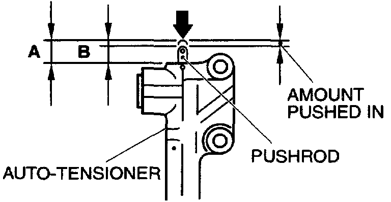

pic 7

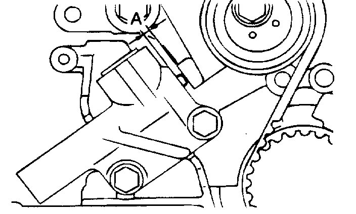

1. While holding the auto-tensioner by hand, press the end of the pushrod against a metal surface (such as the cylinder block) with a force of 98 - 196 Nm (72 - 145 ft. lbs.) and measure how far the pushrod is pushed in.
Standard value: Within 1 mm (0.04 inch)
A: Length when no force is applied
B: Length when force is applied
A - B: Amount pushed in
2. If it is not within the standard value, replace the auto tensioner.

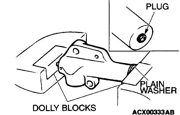

CAUTION:
^ Place the auto-tensioner perpendicular to the jaws of the vice.
^ If there is a plug at the base of the auto-tensioner, insert a plain washer onto the end of the auto-tensioner to protect the plug.
pic 8
3. Place two dolly blocks in a vice as shown in the illustration, and then place the auto-tensioner in the vice.
CAUTION: Never compress the pushrod too fast, or the pushrod may be damaged.

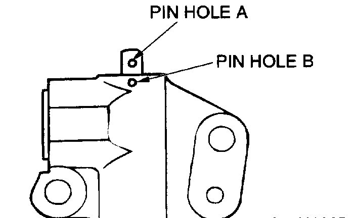

pic 9

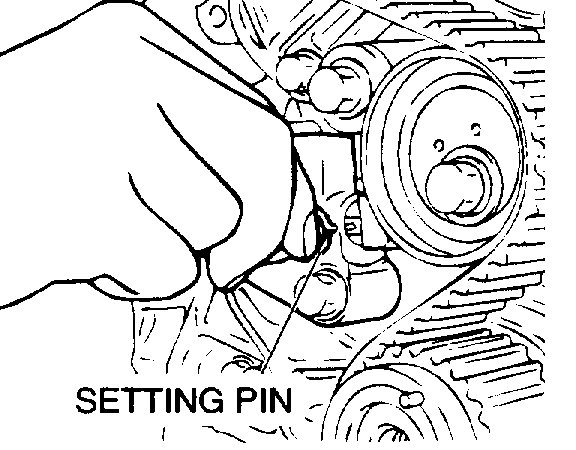

4. Slowly compress the pushrod of the auto-tensioner until pin hole A in the pushrod is aligned with pin hole B in the cylinder.
5. Insert the setting pin into the pin holes once they are aligned.
NOTE: If replacing the auto-tensioner, the pin will already be inserted into the pin holes of the new part.
CAUTION: Do not remove the setting pin from the auto-tensioner.
6. Install the auto-tensioner to the engine.
]]B[[ TIMING BELT INSTALLATION

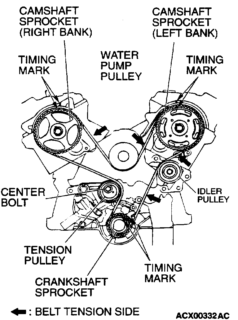

1. Align the timing marks of the camshaft sprocket with those of crankshaft sprocket.
CAUTION: The camshaft sprocket (right side) can turn easily due to the spring force applied, so be careful not to get your fingers caught.
2. Install the timing belt by the following procedure so that there is no deflection in the timing belt between each sprocket and pulley.
1. Crankshaft sprocket
2. Idler pulley
3. Camshaft sprocket (Left side)
4. Water pump pulley
5. Camshaft sprocket (Right side)
6. Tension pulley
pic 10
3. Turn the camshaft sprocket counterclockwise until the tension side of the timing belt is firmly stretched. Check all timing marks again.

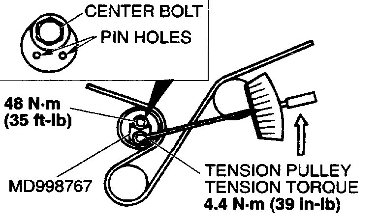

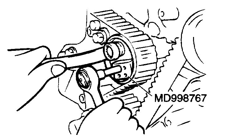

4. Use special tool MD998767 to push the tensioner pulley into the timing belt, and then temporarily tighten the center bolt.
pic 12

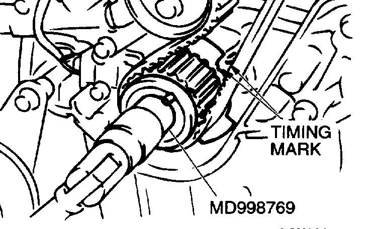

5. Use special tool MD998769 to turn the crankshaft 1/4 turn counterclockwise and then turn it again clockwise until the timing marks are aligned.
CAUTION: When tightening the center bolt, be careful that the tensioner pulley does not turn with the bolt.
pic 13
6. Loosen the center bolt of the tensioner pulley. Use special tool MD998767 and a torque wrench to apply the standard torque to the timing belt as shown in the illustration. Then tighten the center bolt to the specified torque.
^ Standard value: 4.4 Nm (39 inch lbs.) [Timing belt tension torque]
^ Tightening torque: 48 Nm (35 ft. lbs.)

]]C[[ CRANKSHAFT PULLEY INSTALLATION
pic 16
Use special tools MD998715 and MB990767 to install the crankshaft pulley.

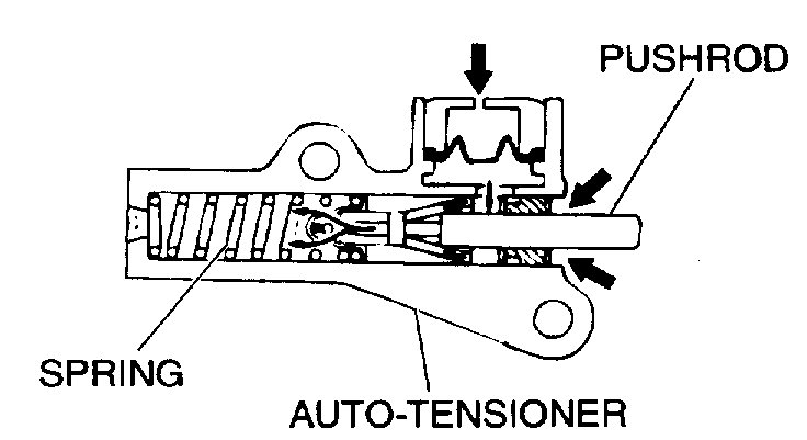

AUTO-TENSIONER
pic 17
^ Check the auto-tensioner for possible leaks.
^ Check the pushrod for cracks.
