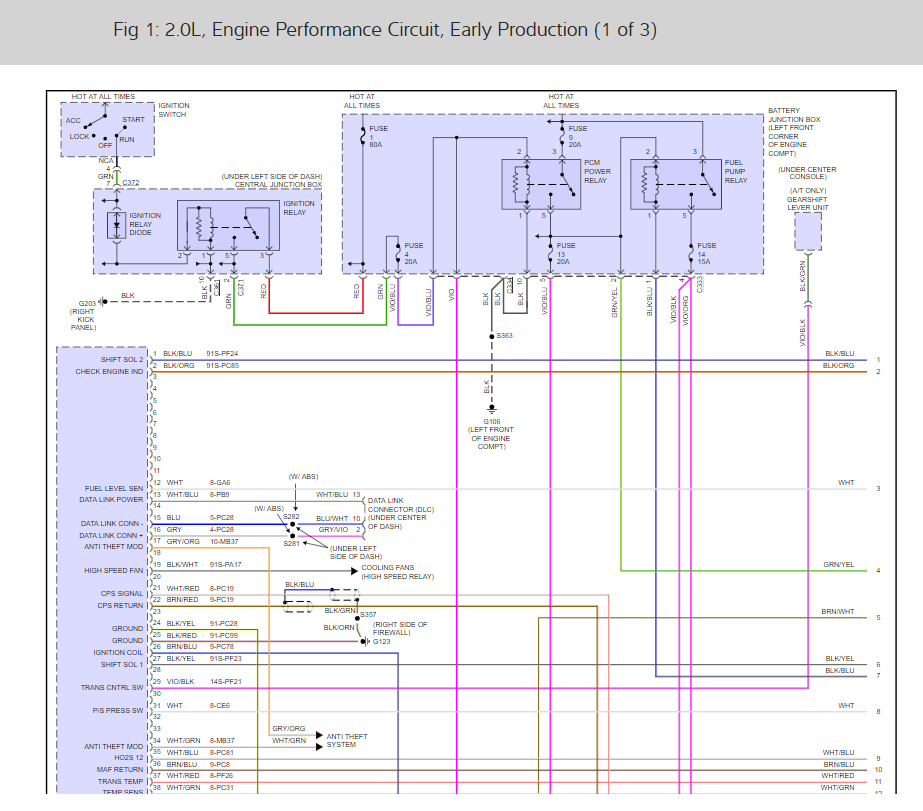

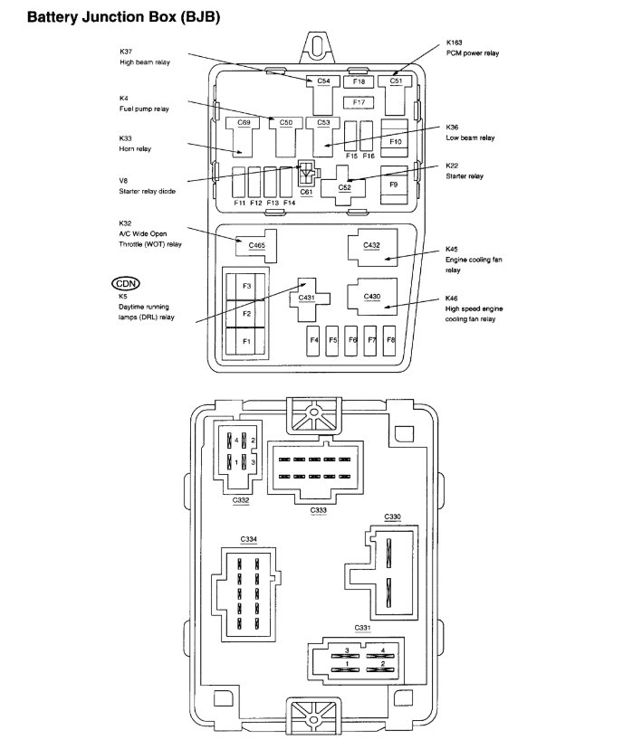

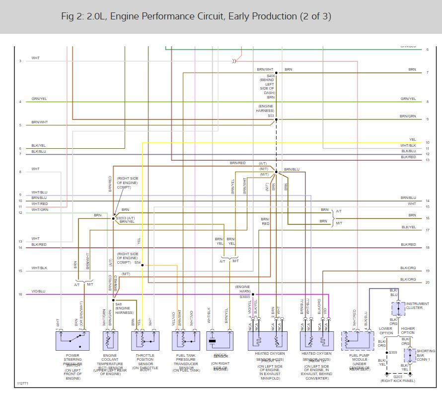

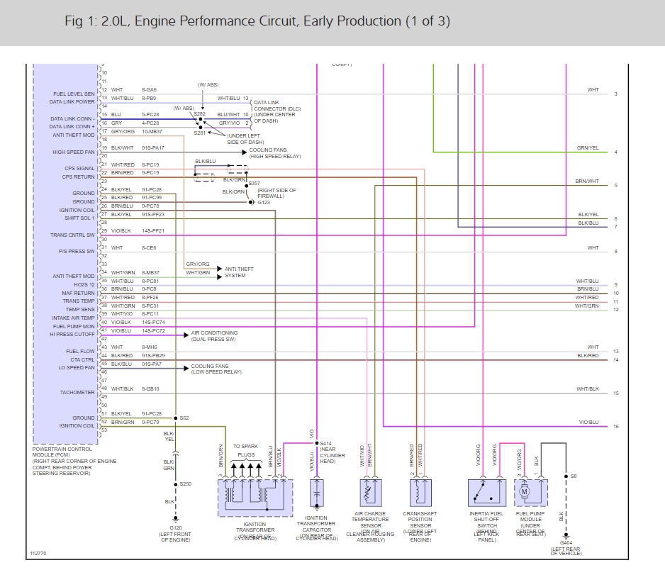

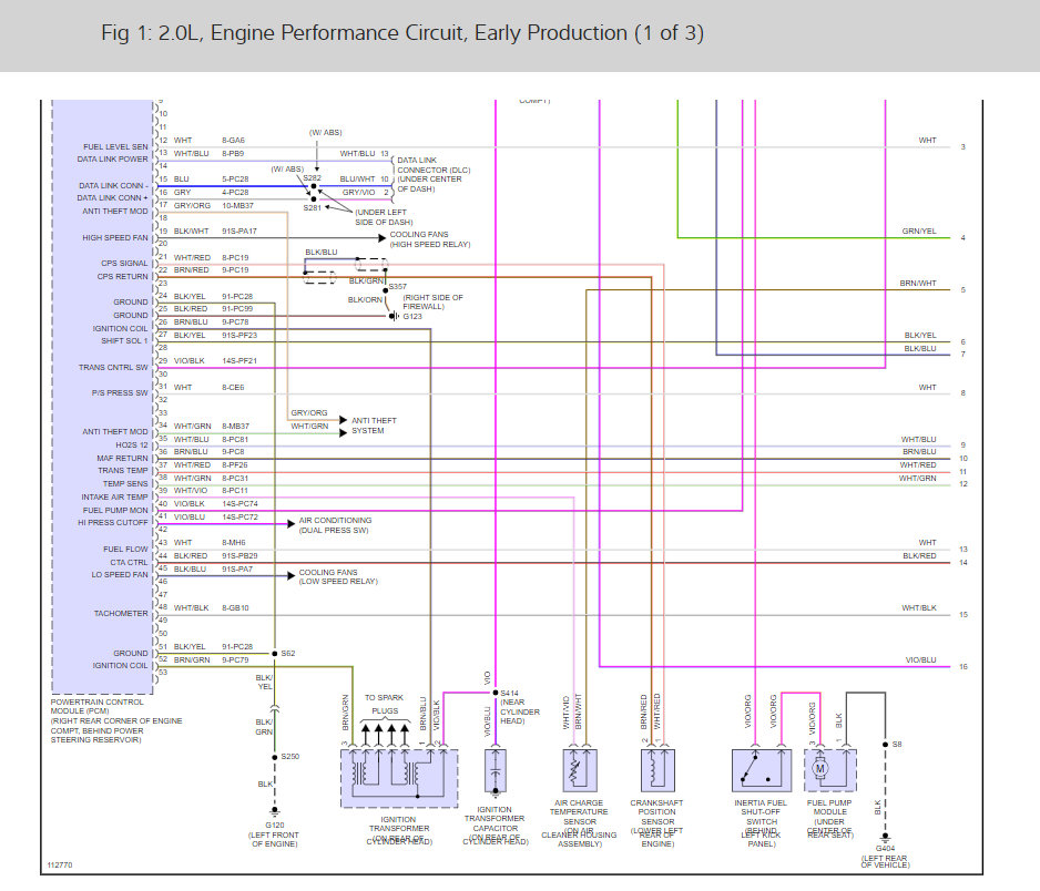

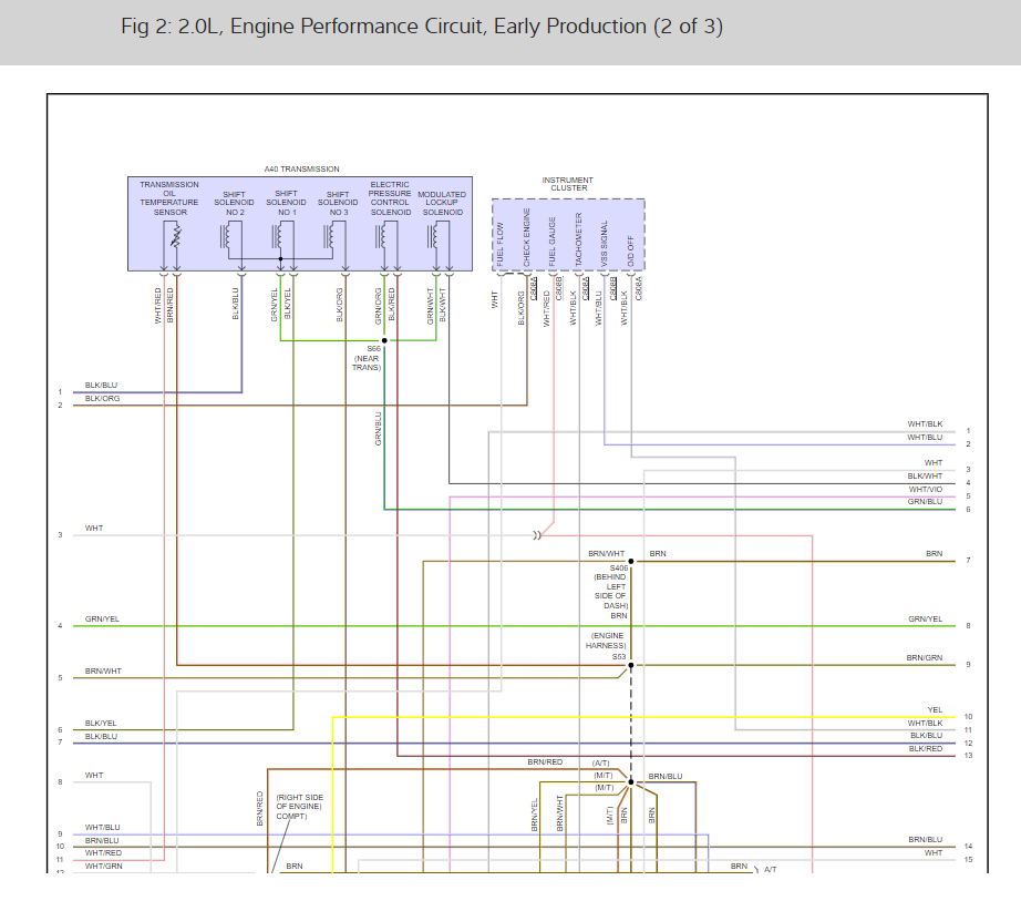

I checked all fuses and relays seems to be okay. Have spark and fuel. I believe fuel pump relay is out of order .I have Chilton manual but there show other location of fuses and relays and I'm not sure which is fuel pump relay. Could you help me and advise what next check? Thanks
Jan 8, 2019 at 10:11 PM
  • 55,447 POSTS

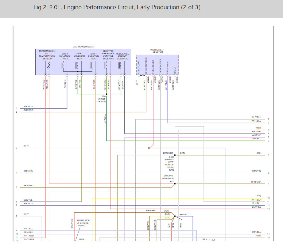

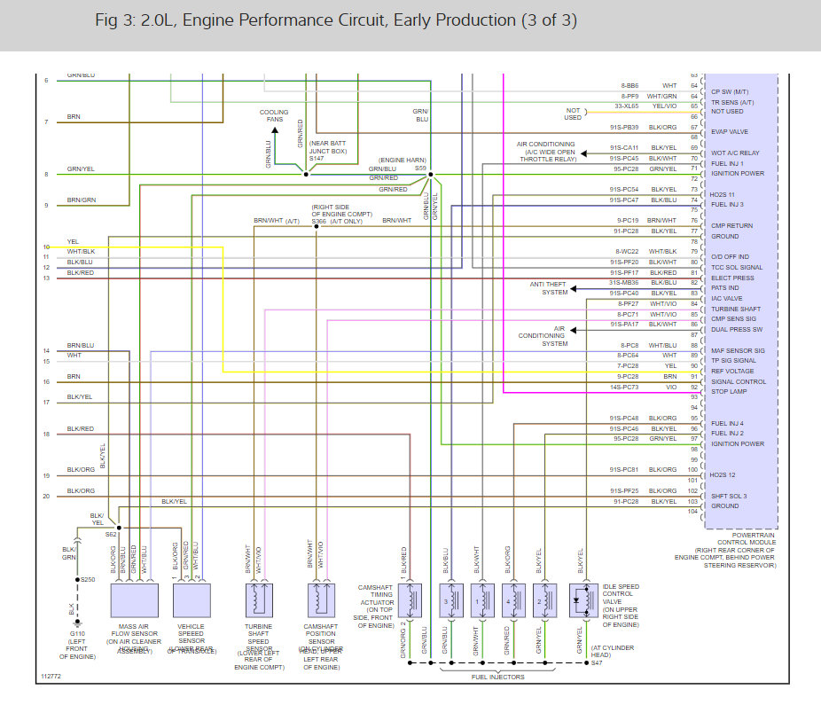

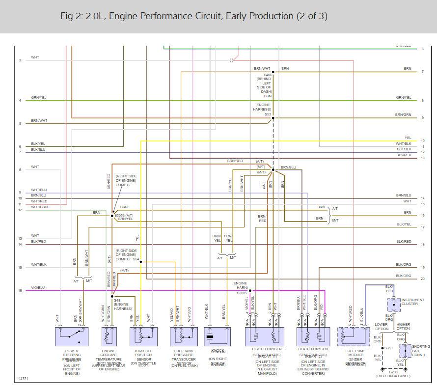

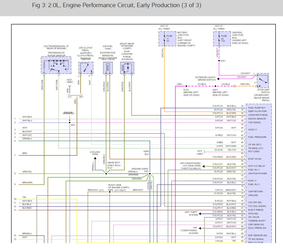

Here are the fuel pump wiring diagrams and a guide to help test the relay with the relay location as well:
Fuel Pump Relay Left front corner of engine compartment, in battery junction box.
