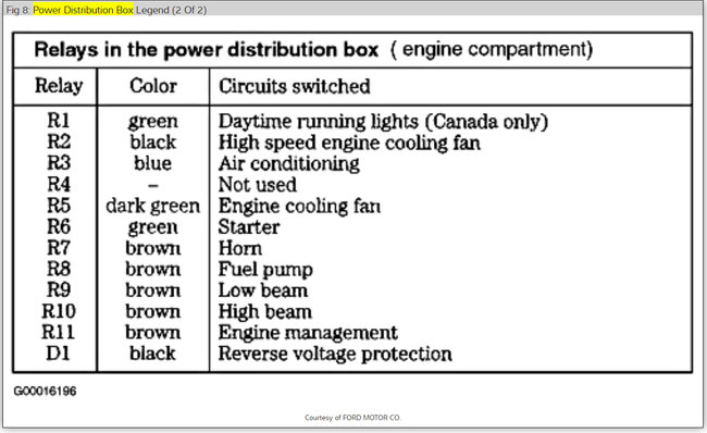

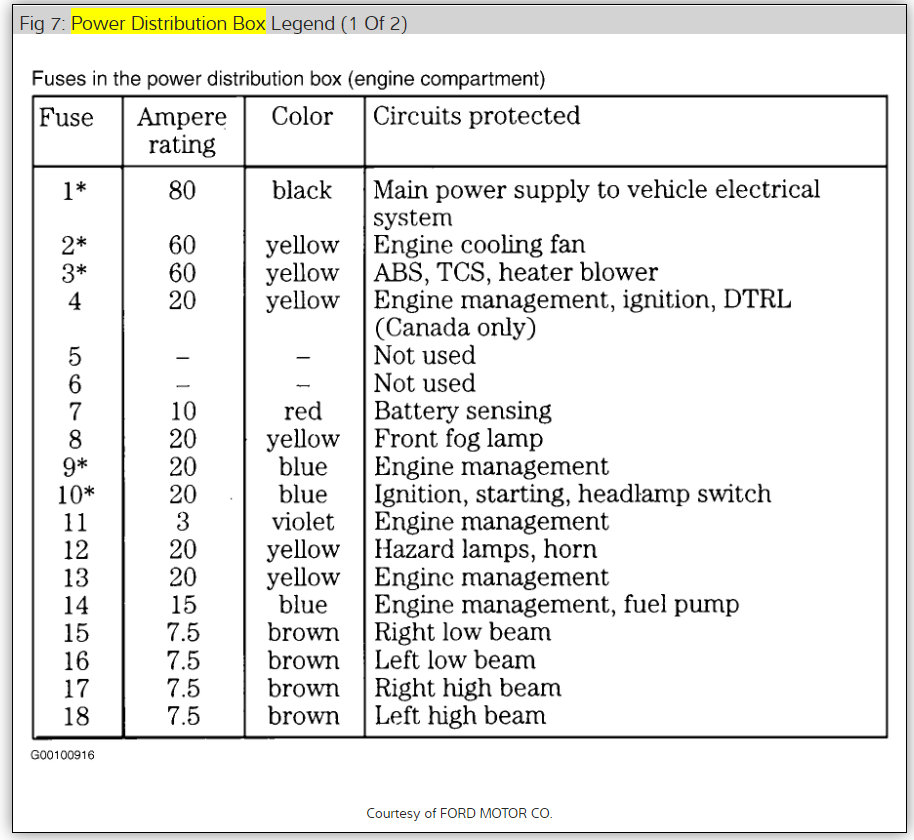

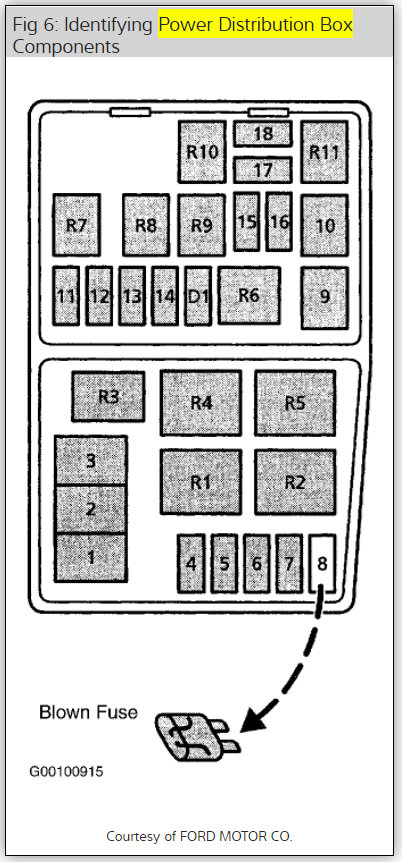

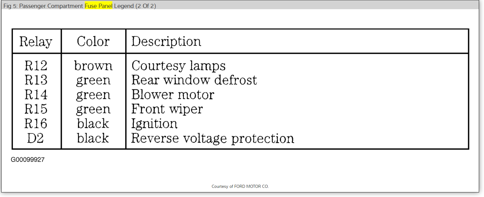

In the fuse box on a my car, which relay is the fuel pump relay? I do not have a layout of the fuses and relays. Thanks
Aug 14, 2010 at 11:20 AM
WRENCHTECH
  • 20,761 POSTS
Here is a guide to help you test the relay once you find it from the diagrams below:

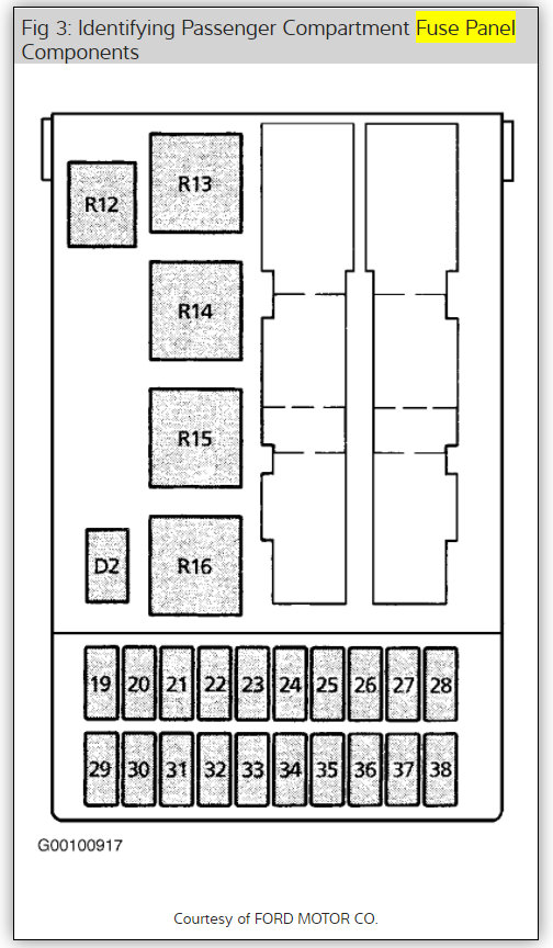

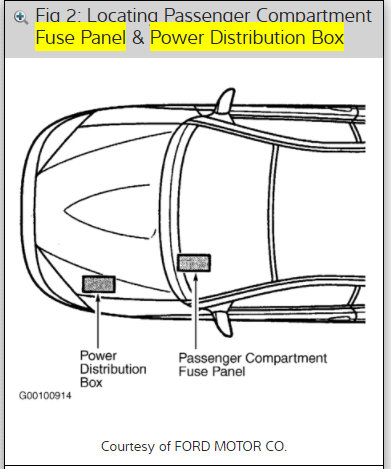

Here is the fuse panel and relay locations.
Cheers
