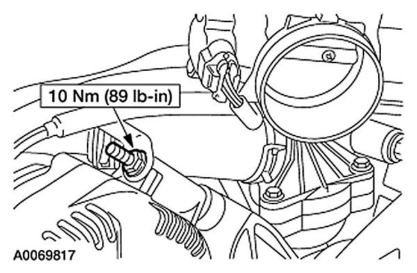

Here are directions specific to your vehicle. The attached pics correlate with the directions.
____________________________________________________
2001 Ford Truck Ranger 4WD V6-4.0L VIN E
Procedures
Vehicle Engine, Cooling and Exhaust Cooling System Thermostat Service and Repair Procedures
PROCEDURES
Thermostat
Removal and Installation
1. Drain the engine cooling system.
2. Remove the air cleaner outlet tube.
3. Remove the generator wiring harness bracket nut and position the wiring harness aside.
pic 1

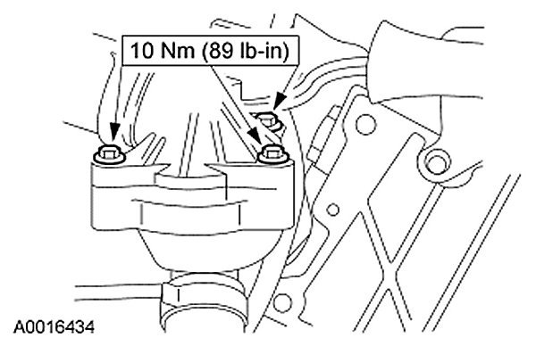

4. Disconnect the upper radiator hose.
pic 2

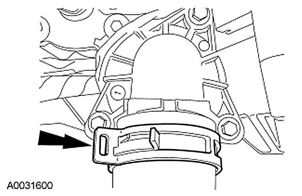

5. Remove the bolts, water outlet adapter, and thermostat.
- Inspect the O-ring seal, install a new O-ring seal if necessary.
pic 3

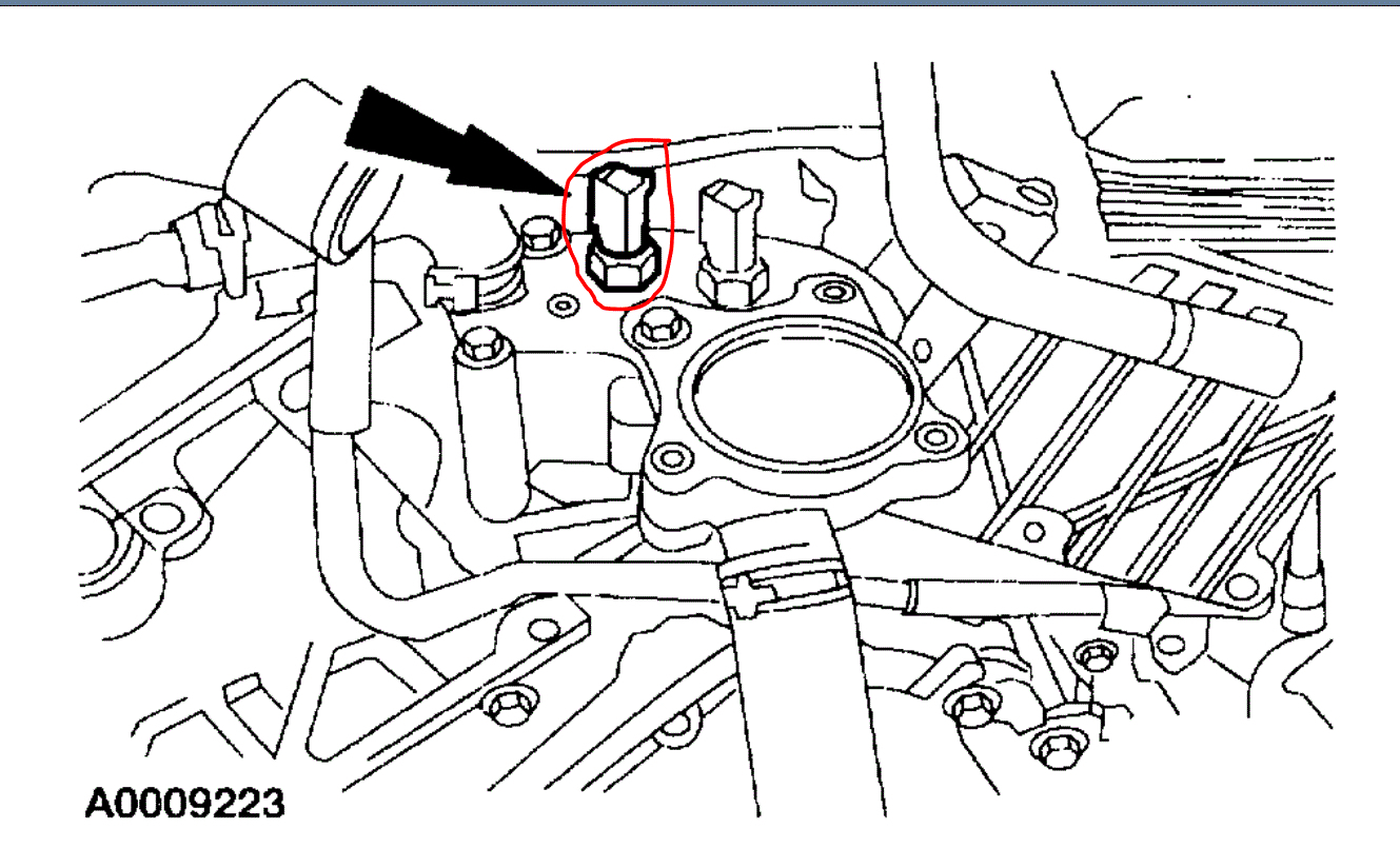

There are two coolant temperature sensors on this engine. One is for the gauge and the other is for the computer. I attached a pic. Let me know if that is the one you replaced.
May 2, 2020 at 2:50 PM
TRENTDUPE
Hi Joe! Looking at the engine from the front of the car I replaced the sensor further to the right on the drivers side. If that picture is the same orientation I would say I replaced the one not highlighted, I believe it was the one to the gauge but I could be wrong.
May 3, 2020 at 12:01 AM
  • 110,240 POSTS
The pic is from the front. I believe you replaced the wrong sensor. Do you still have the one you removed? I would switch it with the new on on the truck and then put the new one in the place indicated above.
