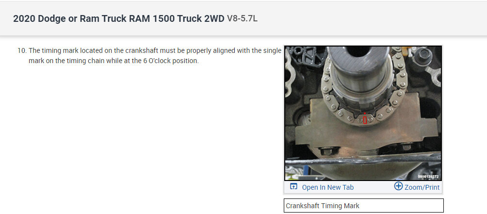

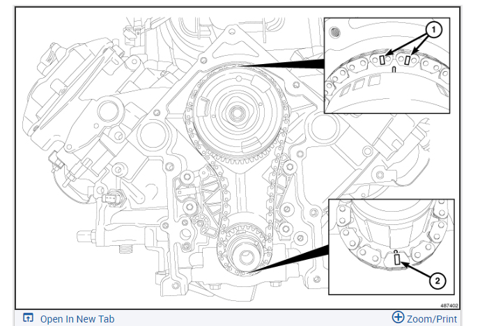

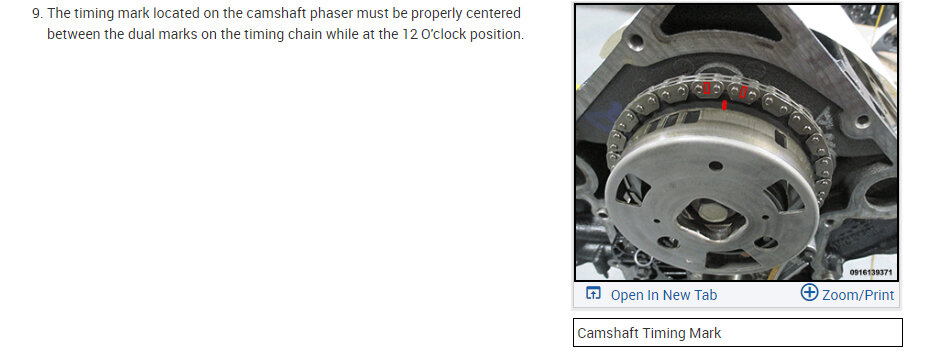

To check the timing chain, the cover needs to be removed. I attached three pics below. Picture 1 shows the timing marks for the 2011.
Pics 2 and 3 indicate the timing mark locations as far as the 2020 is concerned. Did you replace all of these things?
