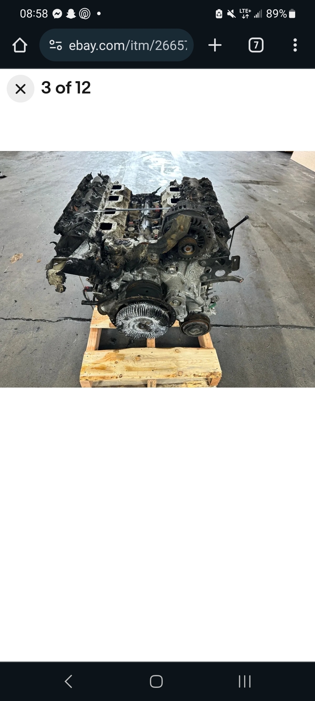

Also, this engine is a fire core that has debris what all should i look for when rebuilding doesn't look like it burned for too long.
Jan 22, 2024 at 11:59 PM
  • 110,244 POSTS
Wow, I didn't realize that happened. If you are planning a rebuild, make certain that the heads are straight and not warped. Also, I need to know what you plan to do as far as a rebuild. Do you plan to take the engine apart to the block?

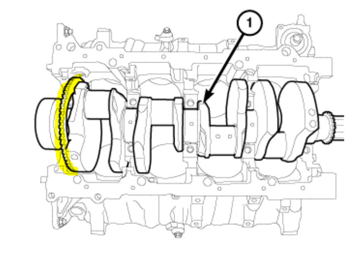

Update: getting heads milled block is good, but I have been searching the forms. And it says that I have to change out the tone ring. There's not many instructions on how to do this. Do you guys have any instructions also? Do I have to remove the pistons to remove the crankshaft? Thanks
Feb 8, 2024 at 2:31 AM
  • 110,244 POSTS
If you plan to remove the crankshaft, yes, the pistons will need unbolted from it. Physically, they don't need to be removed from the block. You just need to be extra careful when reinstalling it to avoid damage to the rod bearings. Take a piece of rubber hose and place it over each of the connecting rod bolts before installing the crankshaft. That will prevent damage.
What toner ring are you referring to? Is it the one for the crankshaft position sensor? If it is, that is bolted to the crankshaft at the rear. See pics below and let me know.
Feb 8, 2024 at 6:40 AM

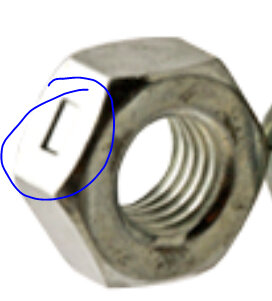

Yep, that what I'm looking for and thanks for all the useful information. Do i need to replace all of the bolts for the bottom end?
Feb 9, 2024 at 10:57 AM
  • 110,244 POSTS
Double-check for me, but I believe the original ones are staked (center lock type). See pic below. If they are, you should be okay to reuse them. Note that the stake may appear different than the pic. I tried to get you a general idea.
Let me know how things turn out or if I can help.

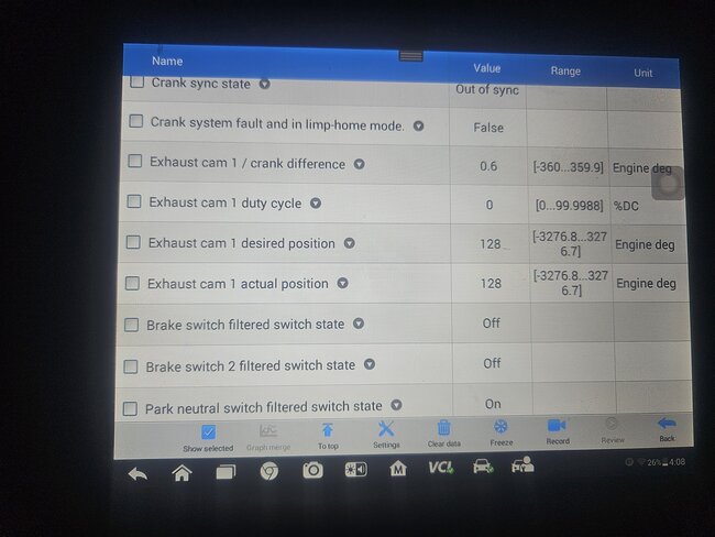

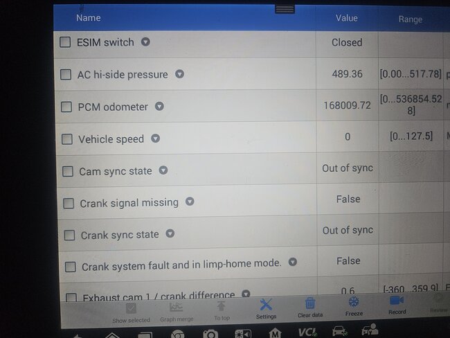

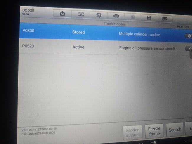

i went to go turn it on today and it ran fine for 3 minutes then it starts to misfire. i swapped all sensors from the old to the new and the old flywheel on my scan tool. It says crankshaft sensor is out of sync same for camshaft, but the timing is good i double checked.
Mar 16, 2024 at 12:39 PM
  • 110,244 POSTS
Let me know the codes that are present. I can check to see for possible issues and diagnostics. Let me know if this is the first start since replacement or if you have driven it prior to this happening.

First start, making a weird rubbing it almost sounds like its coming from flywheel noise on bank 2 it sounds like no oil leaking i am my oil pressure says 96 even with it being off so i assume it needs to be replaced but that wouldn't cause the random misfire?
Mar 16, 2024 at 2:10 PM
KINGJD123
  • 104 POSTS
Looking at that now, any thoughts on the exhaust cam 1 crank different value at 0.6.
Mar 16, 2024 at 2:32 PM
  • 110,244 POSTS
What is confusing me is the oil sensor code. For that to set, there needs to be less than 0 psi or more than 7 psi when the key is turned on / engine off. Do you notice any noises that would indicate an oil pressure issue? Something related could cause the cam to be off.
Is the oil pressure sensor new and for your model year?
Mar 17, 2024 at 12:49 PM

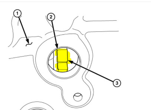

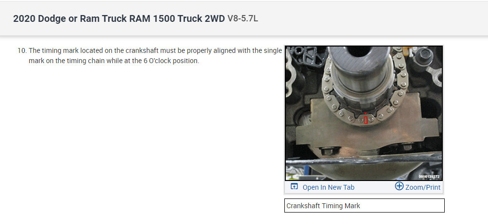

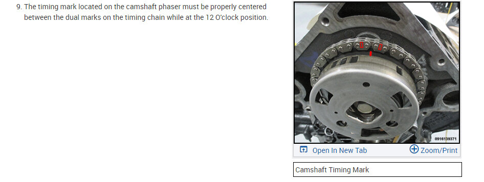

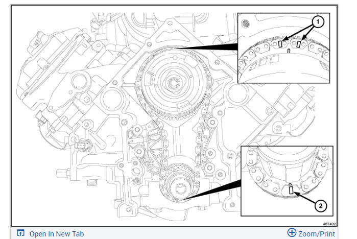

How can i tell if my engine is out of time?
Mar 18, 2024 at 6:39 AM
KINGJD123
  • 104 POSTS
Because it might just need to be off a tooth.
Mar 18, 2024 at 6:40 AM
  • 110,244 POSTS

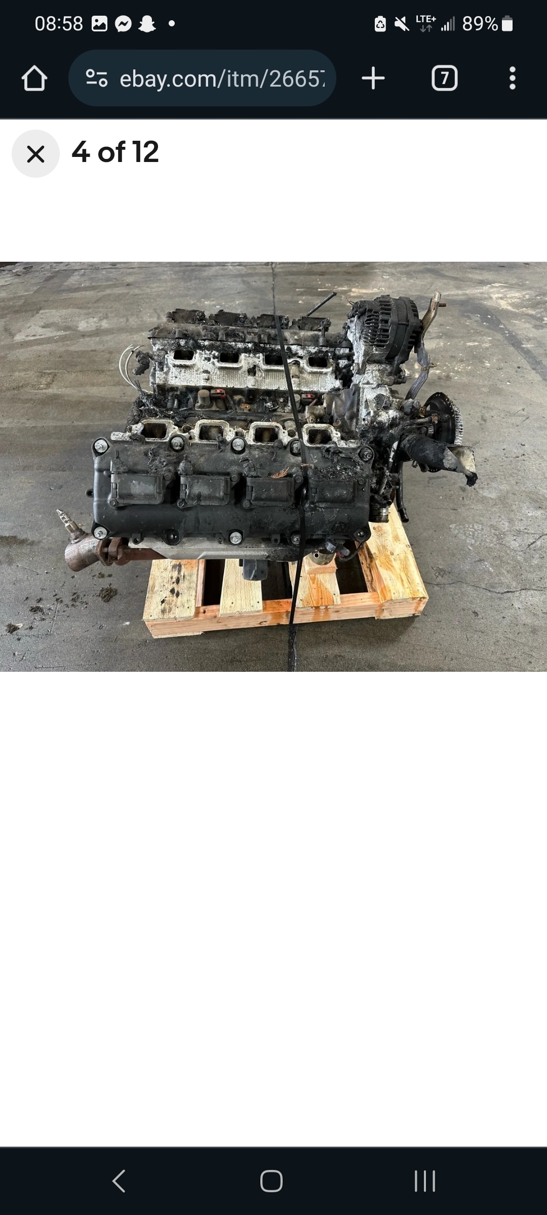

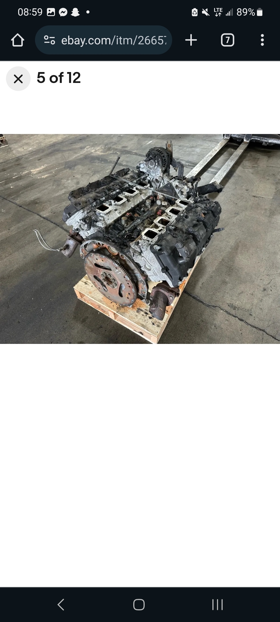

To check the timing chain, the cover needs to be removed. I attached three pics below. Picture 1 shows the timing marks for the 2011.
Pics 2 and 3 indicate the timing mark locations as far as the 2020 is concerned. Did you replace all of these things?
