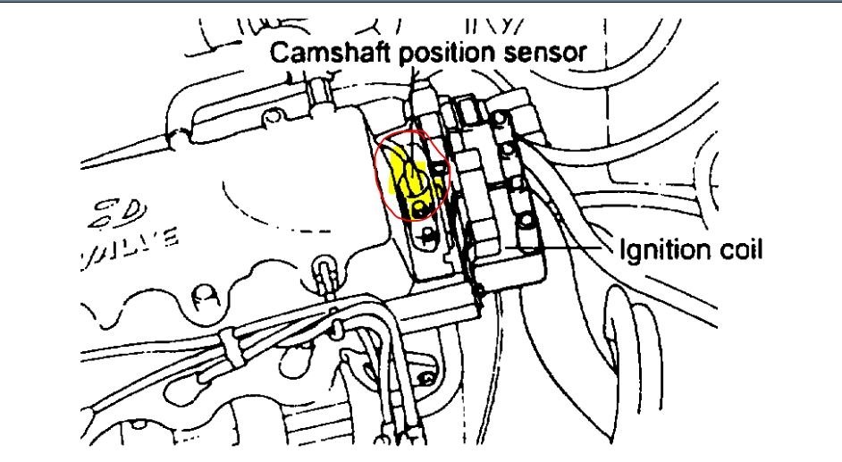

I was driving the car uphill. The car started ping knocking. Went down, at a certain point the engine stopped. I used the starter motor to move it on the side. Since then it worked very roughly some times, (not to a point to start moving). Now it does not start. When it was still turning on, I pulled off the pump relay. It stopped. I pulled the fuel pump tube and turned on the ignition: Fuel started coming into a bottle. Some days ago I used the starting spray into the air filter and cranked the engine: It started immediately. It stopped as soon as the starting spray finished. It does not present any fault code to the OBDII Creader 319. It does not seem to recognize the vehicle. ELM327 Android seems to find something, but not enough to present a fault code. Some years ago I had lost the keys. I made another key. The car did not work as the immobilizer did not let it start. I brought the car to a spooky mechanic and he fixed it. I do not know what he did. This is the story. Do you guys have any ideas? Thanks a lot.

The noise you heard when it first happened (ping) usually indicates an issue with ignition timing. Have you checked to make sure the timing belt hasn't broken or jumped time?
Also, when it started with starting fluid, did it sound normal until the starting fluid ran out? When it starts with starting fluid and not without, indicates the engine is not getting fuel. I realize you checked for fuel, but did you check fuel pressure? Also, have you checked for an injector pulse?
I'm asking because there are several things that can cause a no fuel issue to the engine. The fuel pump may be too weak to open the injectors, the power-train control module (PCM) may have failed and is not sending a signal to the injectors, a camshaft position sensor may have failed resulting in no fuel to the injectors, and so on.
Do me a favor. First take a look through this link. It shows how to check for an injector pulse. We need to know if they are getting power.
https://www.2carpros.com/articles/how-to-test-a-fuel-injector
and
https://www.2carpros.com/articles/engine-stalls
Do that first and let me know the results. Also, I attached a pic below of the cam sensor. Make sure wiring and the connection is good and not damaged.
Let me know what you find.
