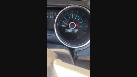

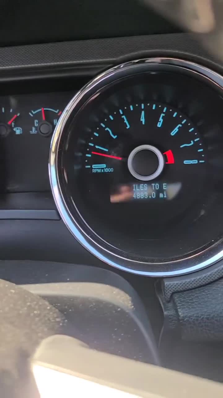

I have been having this issue where my car will stall or almost stall when placed in park. When I start the car there are no noticeable issues, and when I drive the car, or stop at lights there are also no noticeable issues. This only happens occasionally once I reach my destination and place the car in park the RPMs will drop significantly and go back up above 1000 to keep the car alive or stall completely. I have modified the car some with long tube headers and high flow catalytic converters, as well as a tune. There are two codes, P0420 and P0430, which I have been told is normal due to the O2 sensors having different readings of the high flow catalytic converters which is different than the stock readings, causing the codes. My tuner says my fuel numbers look great, and mechanics either can't replicate the issue or can't find what's causing it. Please help!!

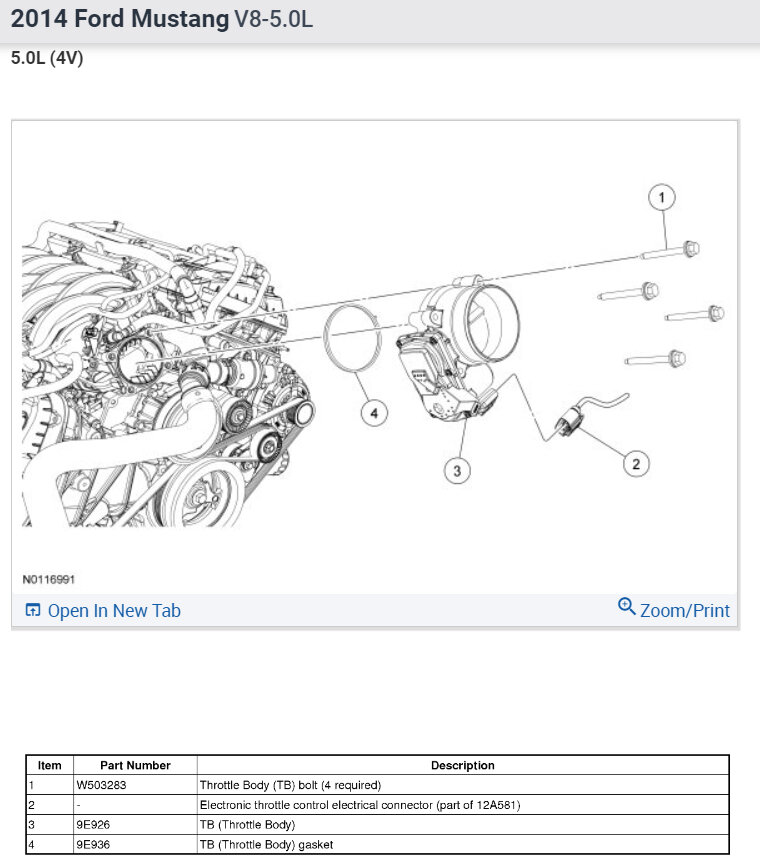

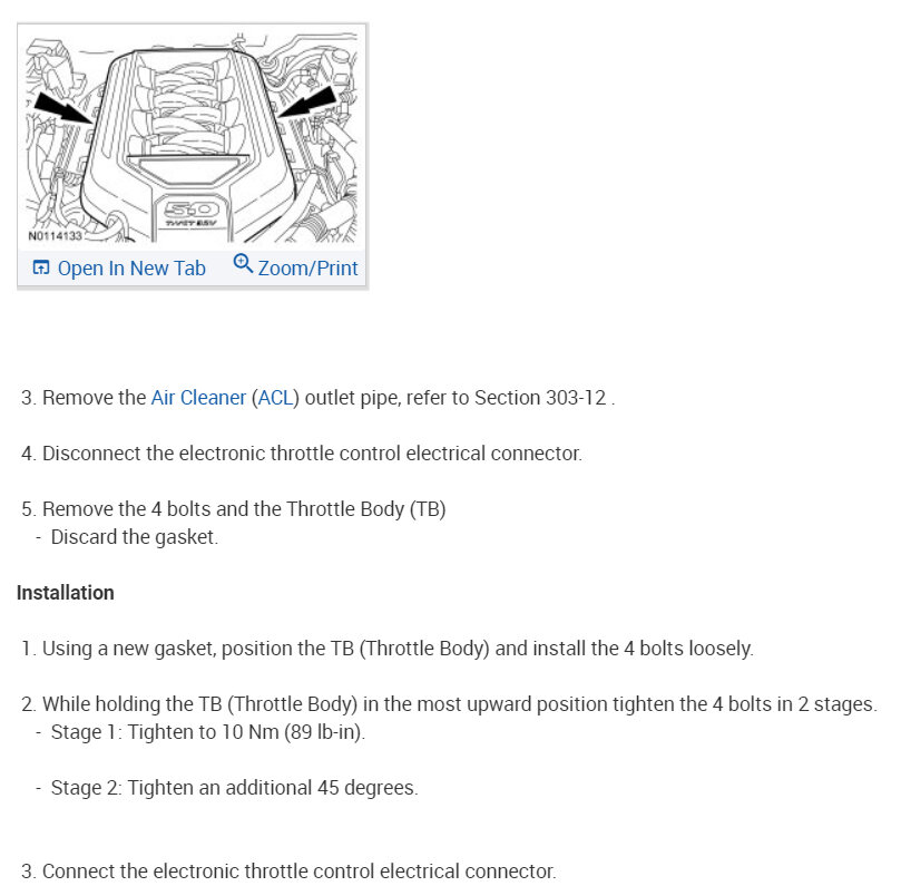

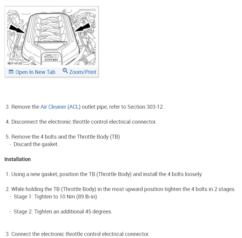

Thanks for the video, it helps. Does the car have 35,000 miles? If so, I would say there is something wrong with the tune. If it has more milage I would service the throttle bore and check for vacuum leaks, here are guides to help us see what's going on:
And use this guide when the engine is cold only:
Here is how to service the throttle bore:

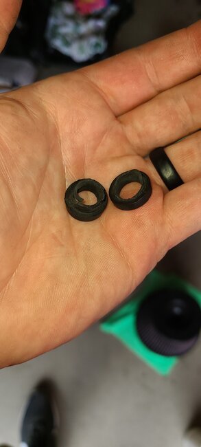

I think so. I decided to just clean my MAF and throttle body this weekend as well as check all hoses. I have the JLT II cold air intake. I guess the grommets were not the best quality and after lightly removing the connector this grommet split in half. It was in very rough shape. This is to one of the PCV hoses, so I believe it was a small vacuum leak.
Sep 23, 2023 at 9:51 AM
  • 110,244 POSTS
Certainly, that can cause an issue. Does it seem like the problem has been resolved since they were replaced?
