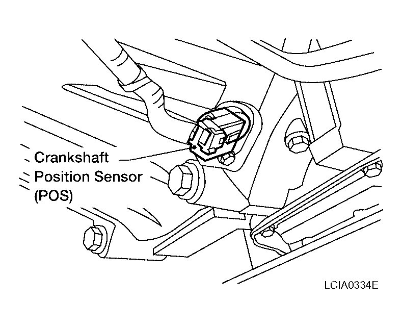

Where are the camshaft and crankshaft position sensors located?
Apr 18, 2017 at 5:26 AM
STEVE W.
  • 15,345 POSTS
Camshaft (phasing) sensor is in the rear of the left hand head. It reads the notches in the end of the intake camshaft.
Crankshaft (position) sensor is under the truck. It bolts through a hole in the transmission bell housing and reads the tone ring attached to the ring gear.

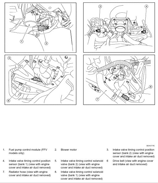

Is there another camshaft sensor as the Nissan Dealership here is saying there is 2 but we can only find 1? and now we have replaced the cam and the crank sensors but the truck is still running horribly (stuttering when going slow, backfiring and stalling)
Apr 19, 2017 at 7:56 AM
STEVE W.
  • 15,345 POSTS
There should be one cam sensor for ignition timing. There may be two other sensors if that engine is equipped with variable valve timing which became standard in 07 but? it's possible yours has it. Those would be at the front of the engine on each side at the ends of the intake camshaft locations, items 3/4 in the picture.
Is the check engine light on? The description doesn't sound like a sensor issue. It sounds more like the IPDM (smart fuse panel) is failing. You might want to try re-seating all the connectors on it. Disconnect the battery. Then release the two clips that hold it in place, remove and re-seat all the connectors. Re-connect the battery and see if things are better.

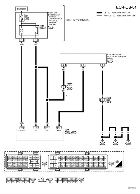

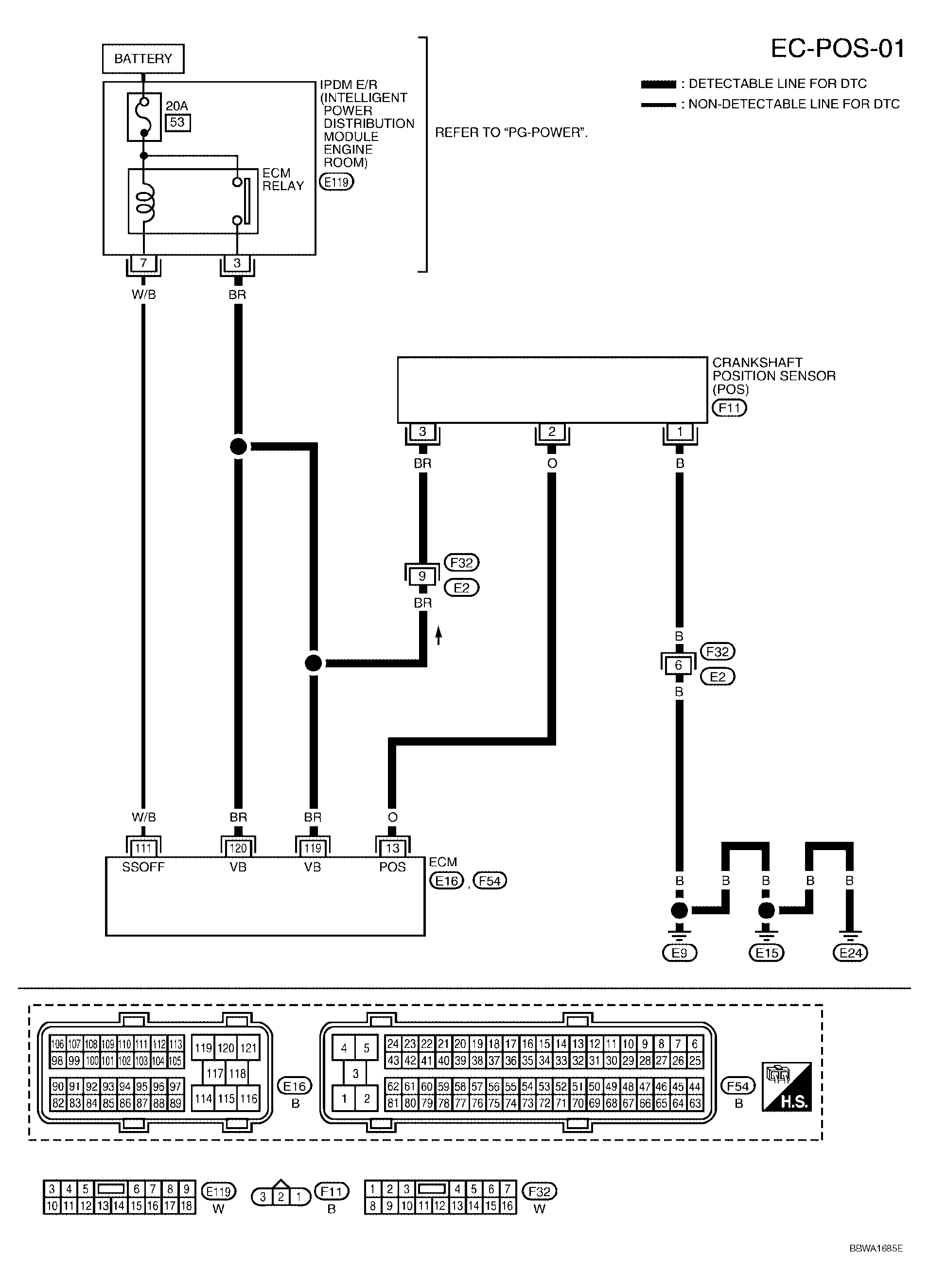

P0335 Crankshaft Position Sensor 'A' Circuit Malfunction =
This is the sensor under the vehicle, bolted into the bell housing on the transmission. Nothing to do with the cam sensors. Check the actual wiring from it for damage, breaks. Especially at the connector. The wires are easy to test with a simple volt/ohm meter. The Brown wire should have a 12 volt feed, the Black wire is ground and the Orange wire is the signal feed to the ECM. Images show the sensor and wires. While the sensors do go bad the wiring causes this code far more often.

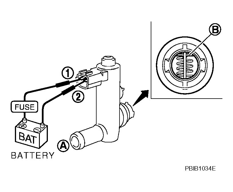

P0447 EVAP Vent Valve/Solenoid - Circuit Open =
Either a broken wire to the valve connector (common) or the valve itself. As it is nothing more that a coil of wire the same meter you used earlier and test it for continuity. Or use a 12 volt power source to apply power to the two pins on the valve. It should click open/closed as you apply and remove power. It's on the charcoal canister attached to the frame above the fuel tank.
