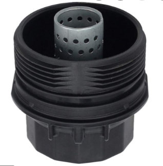

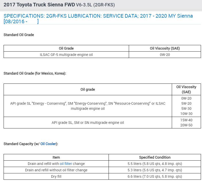

on a -20-degree day the check oil light came on, but the oil as well as all other fluids were full. Oil had less than 1,000 miles on it. I figured it was just a sensor problem, so I started to the garage to have it serviced when it started ticking, so I shut it down and had it towed. When it got there the engine had seized. The mechanic said the filter collapsed and sucked up toward the engine. The only thing I am worried about is if this could be caused by putting the wrong oil in during my last DIY oil change, if not I can probably get expenses paid under warranty. I'm pretty sure I put the recommended 0w-20 in but not 100 percent.

The type of oil is not the culprit here. The 0W-20 is the correct oil.
As you have mentioned that the oil was at the correct level, so we know it was not for being low on oil.

The recommended oil is 0W-20. But you can also use 5W-30, 5W-40, 10W-30 etc.
So, any of these oils will work.
Only way you might have this type of damage if you added gear oil to the engine. Which is significantly thicker and will not circulate properly.

I'm just wondering if the 2017 Sienna has an oil filter bypass valve to protect the engine if the oil filter gets clogged.

There should be a check valve that is inside the housing, which will allow the oil to flow if the filter gets clogged.
Keep in mind unless there are excessive amount metal shavings or significant amount of debris in the oil, the filter will still allow oil flow.
Excessive sludge build up can also cause that. But that is for an engine that has been poorly maintained and likely will have much higher mileage, also might not have been serviced for a very long time.

The dealer said that the center post for the oil filter housing was missing, so I guess when I pulled out the oil filter at the last oil change It was stuck inside and i put a new filter in without it, which caused the filter to collapse - my mistake. So, I'm going to have to shell out $8,000.00 for a new engine. I was just wondering if there was some kind of bypass valve that might have somehow failed that I could make a case on.

Without that center post it will not be able to have proper oil flow.
That center post is typically mounted on the oil filter cap, it might have have gotten loose and came off with the filter.
