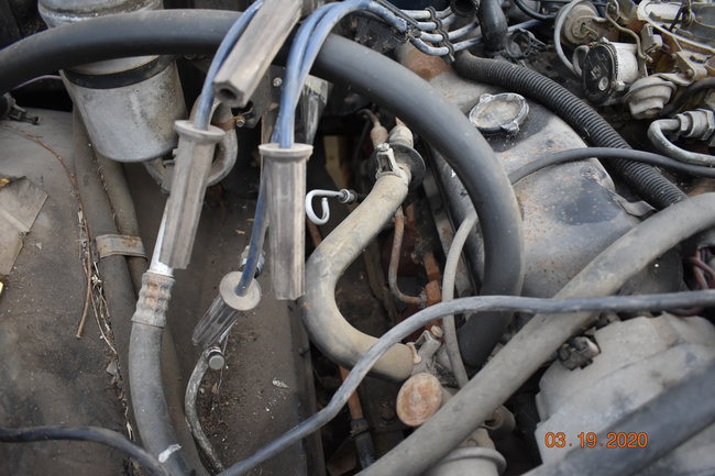

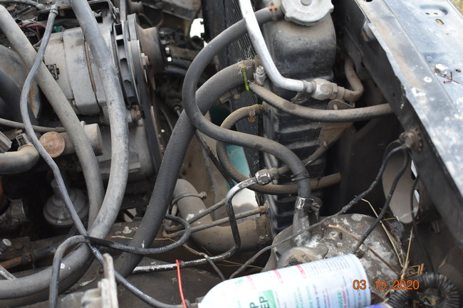

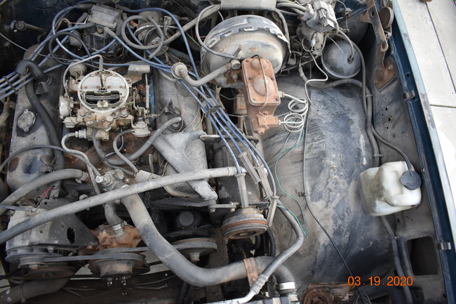

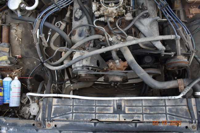

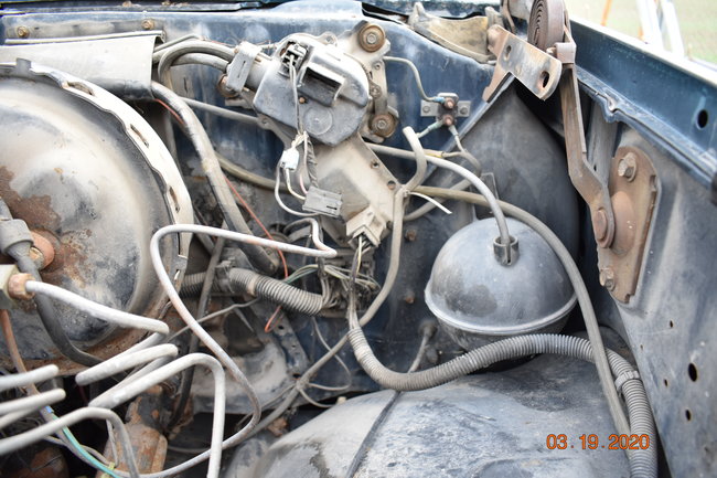

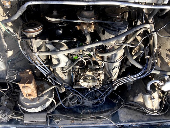

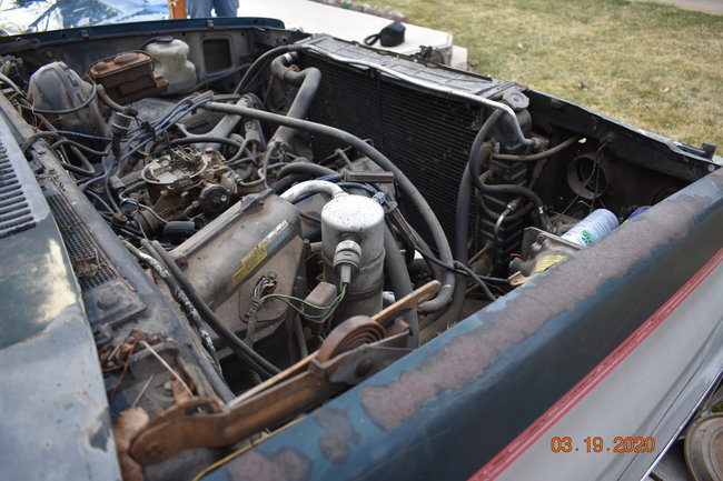

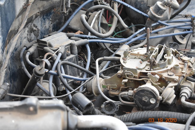

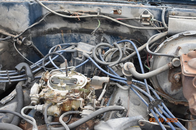

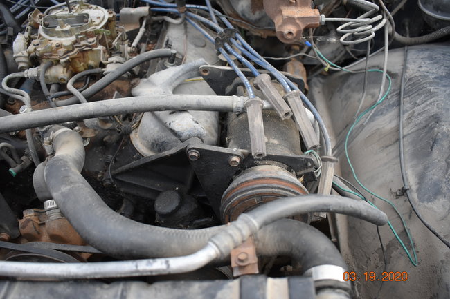

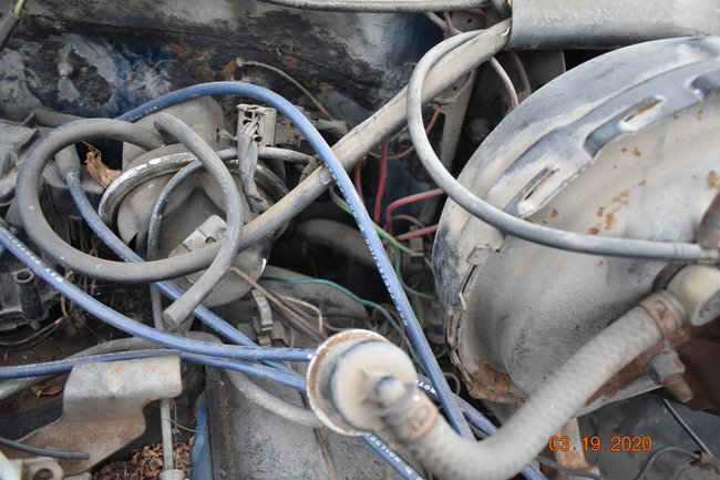

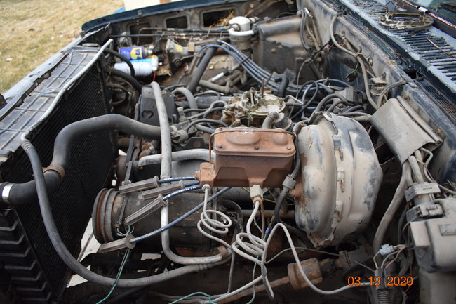

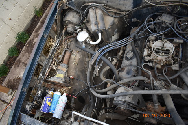

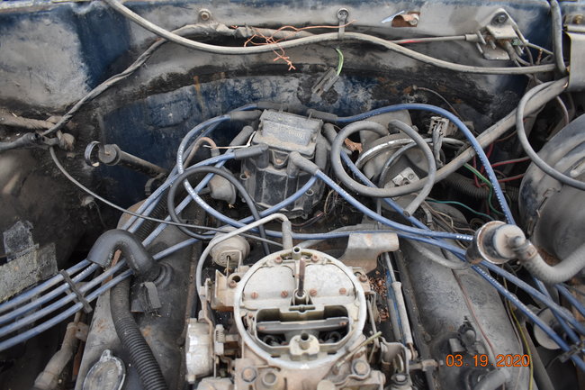

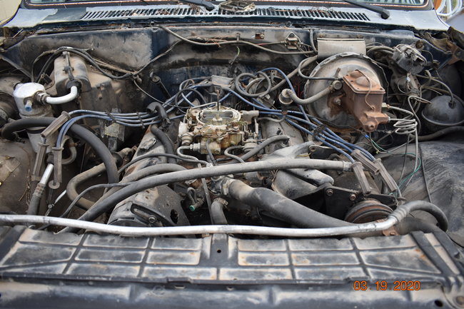

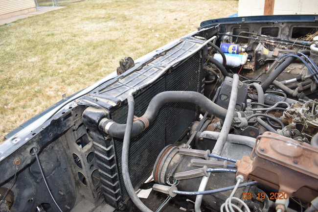

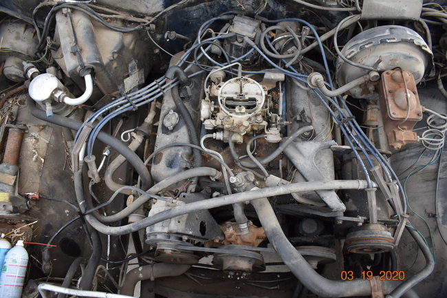

I'm currently rebuilding my 454 in my 1984 Chevrolet C20, and have been watching Ryan's video series on the process. I'd like to keep the build as stock as possible, including the oil/transmissions coolers, HEI ignition, etc. I realize this will give me a few extra hoses, cables, wires, etc. When Ryan got his engine running, his engine and compartment were much "cleaner" than mine ever was. I'm curious if there are any of the hoses and wires that can be safely removed without negatively affecting anything?
Dec 28, 2020 at 10:25 AM
Good morning,
Can you upload some pictures of your truck under the hood? There are some you can eliminate but not that many.

Sure thing! Here you go.

Secondly to answer your question. Ours is a custom build so it has a few things missing that something from factory you might want. On your rig the two things I could see cutting if you really want a cleaner look is getting a different carburetor with mechanical secondaries instead of vacuum. The other thing if you really do not use it is to take out the air conditioning. I know that last one is something most people would not want to lose.

Not a problem! So the secondaires on a 4 barrel carburetor add fuel when in a heavy throttle situation. There are two ways to achieve that. Either you rely on vacuum which requires a vacuum line from the intake manifold. Or you have a physical mechanical connection from the throttle actuation. You would need a different carburetor and to plug the vacuum line from the intake manifold.
I think the best and cheapest route for you to go is give the engine a nice wash, take off and paint the valve covers, then use zip ties to bunch everything together neatly. You would be absolutely shocked what a little elbow grease will do to the look of your engine bay.

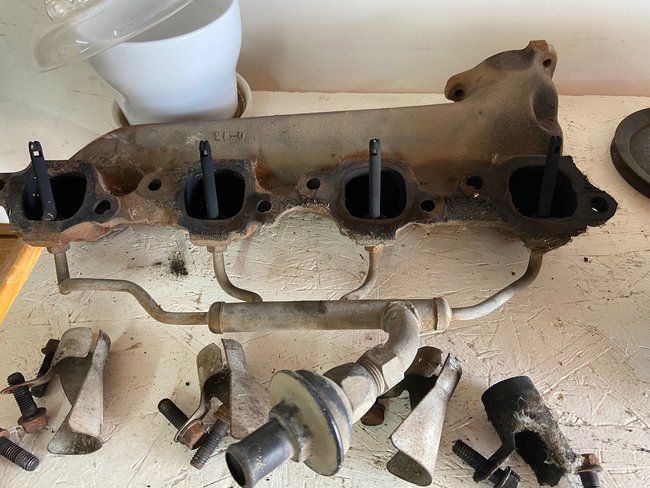

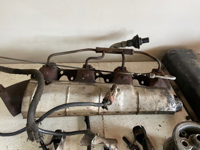

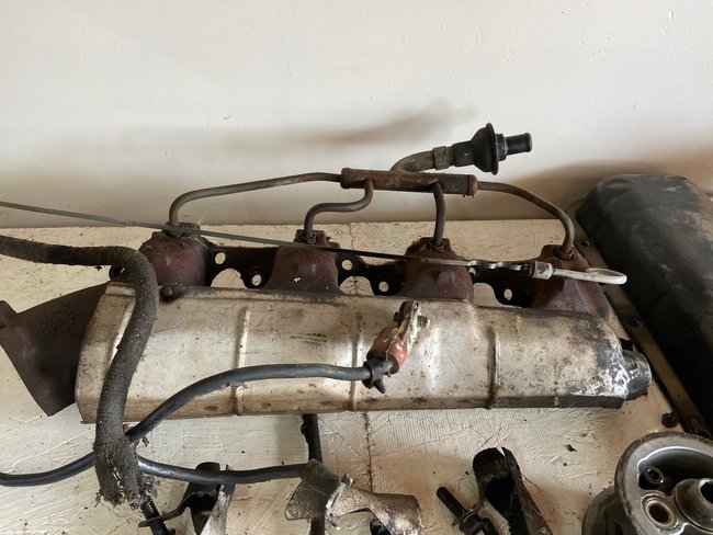

Another follow up: exhaust manifolds. Attached are the two I removed from my engine. Are they good to just clean up and reuse? Should I get new ones? Also, can you tell me what the probes are that are inside of them? Do I need those? What would they connect to?
Feb 7, 2021 at 12:57 PM
That is the tubes for the air injection system for emissions. If you are putting it back to stock, you can reuse them.
Otherwise, you can remove them and use plugs to insert in the manifold.

Regarding the emissions air injection tubes for the exhaust manifolds: I can find the tubes online to buy, but I cannot find the extension tubes that connected to the air tubes and went directly inside the manifolds. Do I need those extensions, or just the main air tubes as shown in my earlier pics of the exhaust manifolds? The pics I posted earlier show the extender tubes in question.
May 4, 2021 at 5:08 AM
If you are planning on the system working correctly, you will need the extenders.

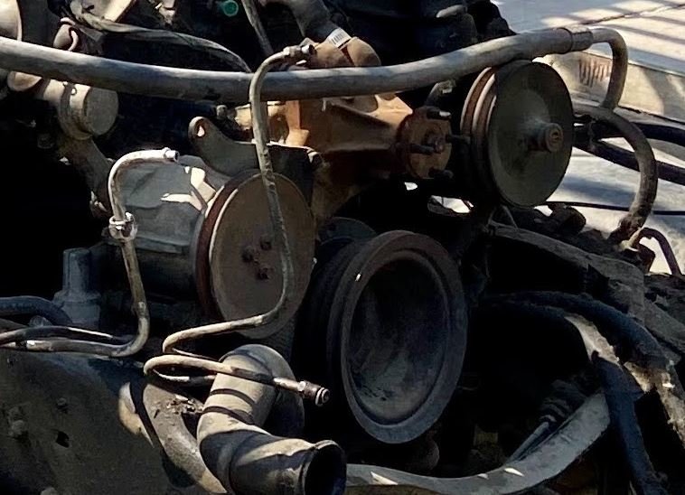

Can you tell me what the small pulley is used for, to the left of the water pump? Is that the 'air compressor' for the exhaust air system? Or something else?
Jun 2, 2021 at 5:50 AM
That is the air pump.
You will be removing that and not using it since you eliminated the parts in the exhaust manifold.

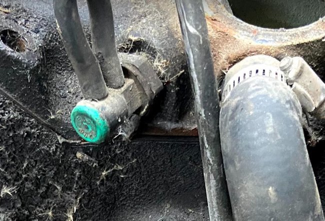

Any idea what this vacuum part is? It's on the intake manifold, right next to the thermostat. Obviously the tubing is wrong, but I'm trying to find out what it is, and if I need to replace it.
Jun 14, 2021 at 5:13 AM
That is a thermostatic switch. There is a vacuum on one side all the time but will only pass a vacuum when it reaches a certain temperature.
They used it for 2 reasons. It was for the EGR valve if it has one. It also controls the vacuum advance for the distributor if it has one.

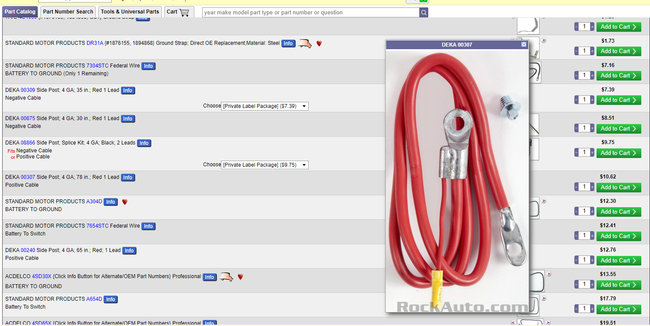

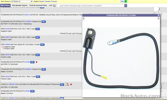

Battery/power/ground cables...I need to replace mine on the truck. Can you give me an idea of what, how many, how long, gauge, etc.?
Jul 2, 2021 at 2:23 AM
Okay, I attached the battery cables below for you. It lists the length, gauge and it has the ends already installed.
You have 2 cables. You can get them at a parts store if you do not want to get them from a parts store.
Jul 2, 2021 at 6:14 AM

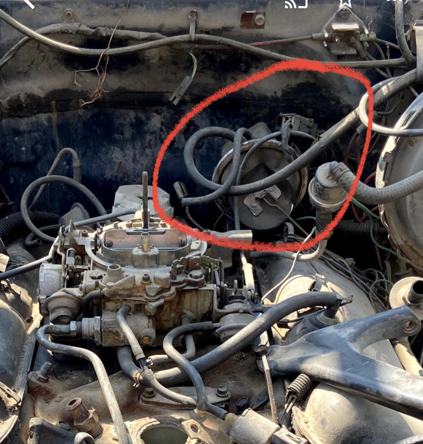

Can you tell me what this part is? It seems like some sort of vacuum thing…?
Jul 22, 2021 at 11:14 AM
It is for the cruise comtrol. Vacuum is applied and it pulls on the throttle to adjust vehicle speed.
