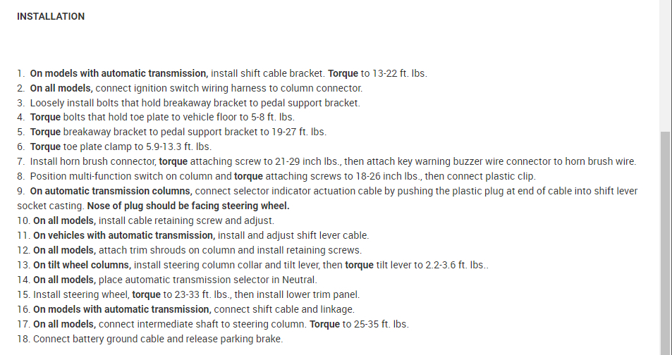

in am fuel pump stays on and won't start until i move shift up/down few tomes.....runs ruff for few min and engine light on then smooths out and light goes off......

I suspect you have two issues. One is a park neutral switch that is preventing the start. Then once it is started, you have a fuel or vacuum leak.

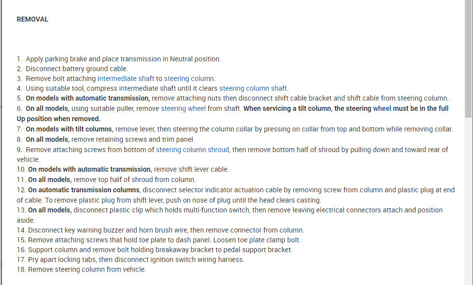

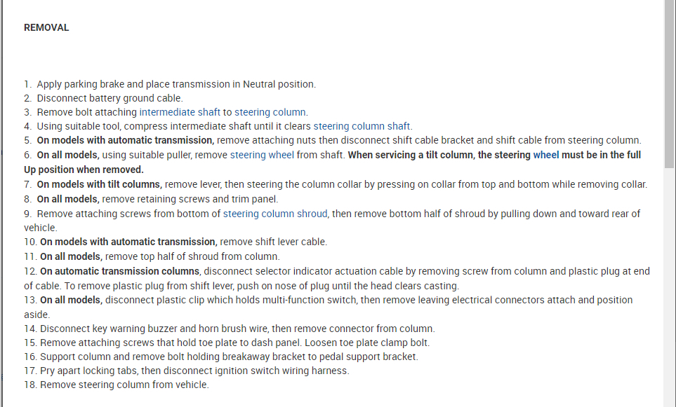

Couple things we need to start with on this. Let's deal with the no start issue which we will need to take the column apart to replace the switch but I am pretty sure that is the issue with the no start.
Then once it is started, we need to check fuel pressure and for a vacuum leak. Here are guides that will help with both:
Please run through this material and let us know what you find. Thanks
