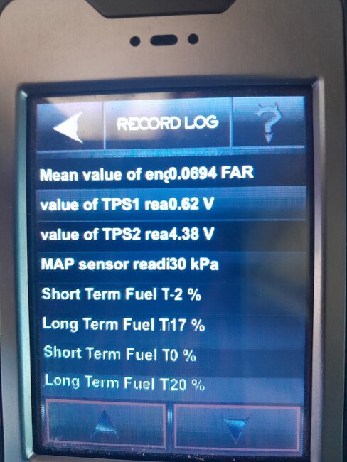

Well, my wagon fell on her face today as i started to pass another car for just a split second! Felt you know when someone is snoring really freaking loud with their mouth open and someone takes a straw and puts one of those plastic rubber bbs in it and shoots them in the back of their throat. They gasp really quick like. Like that. Also, the other day sitting in the drive through in part she almost quite running shot back to life idling high for a couple seconds then leveled out. No codes she didn't lurch forward just started to fall out then caught herself. I was going to compare parameters in air/fuel and corresponding sensors to start with.

As far as air/fuel mixtures, in a perfect world, the common target ratio for gasoline engines is around 14.7 parts air to 1 part fuel. If you have a live data scan tool, we can determine the fuel related issues using information which includes the short term fuel trims, oxygen sensor voltages and so on. Some scanners can identify the air fuel mixture.
Let me know if you have one and if the problem happens when the engine is warm. If that is the case, we may have a crankshaft position sensor in the process of failing. Additionally, make sure the engine coolant temp sensor is sending the proper signal. The easiest way is to check it cold. Check it before starting and the signal should be very close to the ambient temperature.

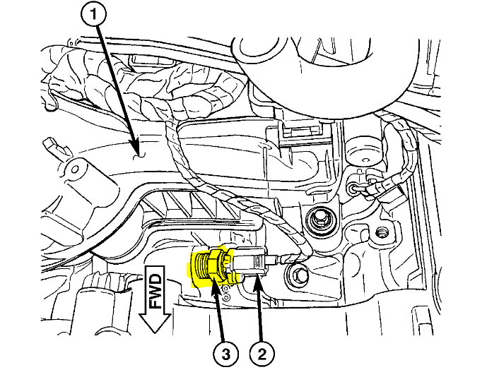

  • 110,244 POSTS
The engine coolant temp sensor on the 5.7L engine is located under the air conditioning compressor. It is installed into a water jacket at the front of the cylinder block.
I attached a pic below showing the location. Note, the compressor mounting bolts need removed, but you don't have to remove any hoses.
See pic below.
Mar 22, 2024 at 2:22 PM

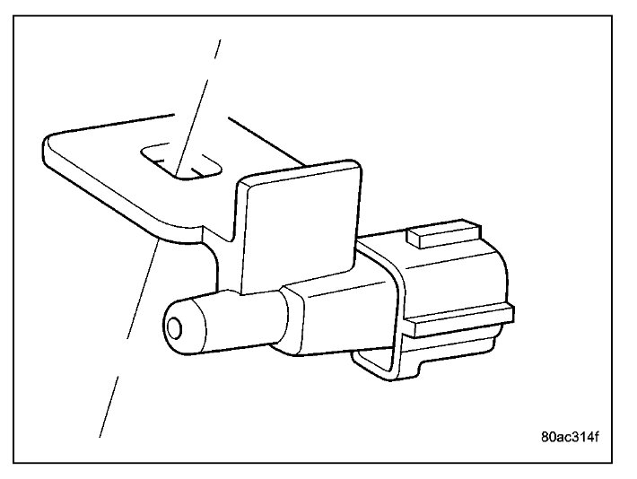

  • 110,244 POSTS

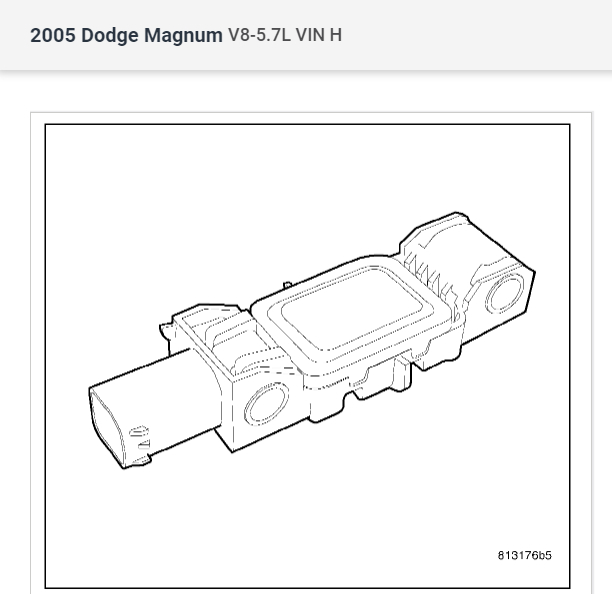

I believe you are referring to the ambient air temperature sensor. I attached a pic below. Is that what the sensor you are referring to looks like?
Mar 23, 2024 at 12:12 PM
WILLIE HURLOCKER
  • 83 POSTS
there are two of them on both sides.

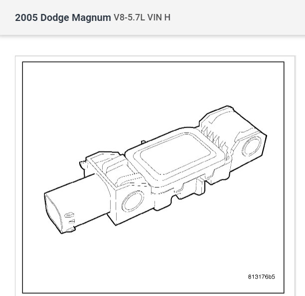

  • 110,244 POSTS
Wow, you really have this taken apart. LOL As far as the sensors are concerned, they appear to be the impact sensors for the passive restraint system. I attached a pic below. Is that what you have? Also, can you read a part number on the sensors you have? That way, I can confirm it for you.
See pic below.
Mar 23, 2024 at 1:29 PM

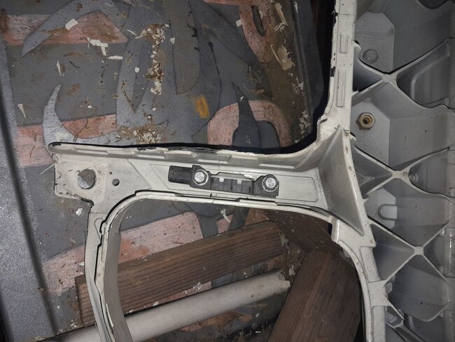

WILLIE HURLOCKER
  • 83 POSTS

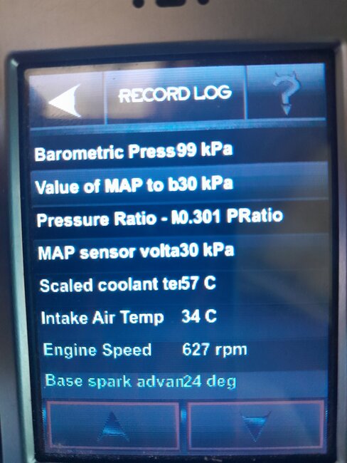

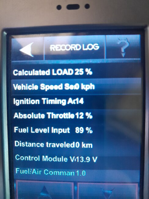

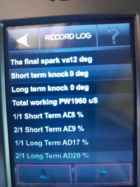

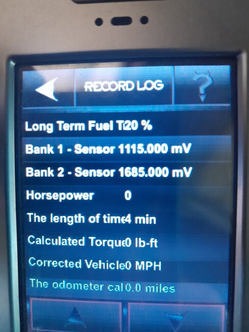

Yes, that is it. every pic i see doesn't show 2 sensors upfront, just shows one near the cab! these wouldn't have any impact on air/fuel, would they? i also have pics of my live data. can you compare them with manufactures data on a 5.7 hemi?

Reading through this you say that you can be driving along, and it just shut down. Check the O2 sensor harness where it comes up over the rear of the block. Had an almost identical issue a few years ago on an 02 Ram with the 5.7, On it the O2 harness had rubbed partially through and it would trigger the PCM to reset and you would get a 2 second shutdown. Have also seen it with a damaged O2 sensor that was shorting internally. Didn't set any codes but you couldn't drive it reliably for any distance. Didn't catch it until I put a scope on it and set it to capture. Then it showed up.

my o2s are fine you can see from the pics i sent. the b2s2 dosent read though. but it's been that way since i bought the car 4 years ago and don't seem to bother it! i say that because it's not sluggish, accelerates fine and in town I'm getting 15 MPGs hmy 18/19 mpgs! but on live data it shows hrt/air are red on the omi ready i think its called?
Mar 24, 2024 at 6:02 AM
STEVE W.
  • 15,357 POSTS
The scanner data never showed anything on those either. The glitch happens faster than the scan tool updates. That was why I had to use the scope to record it long term. I think I had one time where the scan tool showed anything abnormal but it didn't set any codes.

So, do you know if the impact sensors would have anything to do with the rough idle? i know they turn gas off if you're in a wreck but was just wondering if maybe?

Nope, impact sensor does 2 things in a wreck, it will turn off the pump and set off the air bags at the same time.
