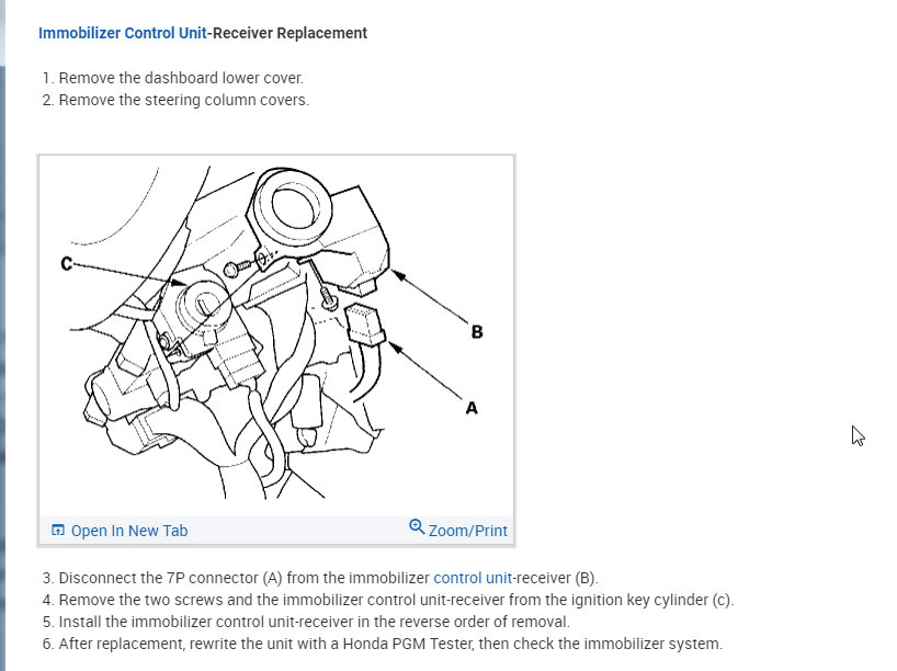

Drove car home, two days later car will not start. I notice passive anti theft system not working.

Light doesn't come on at all. No codes found with code reader.

No light when turning key. Engine will turnover but will not fire.
Jan 2, 2021 at 2:34 AM
Okay. This means then key ID is not getting to the ECM to turn off the system. When you put the key in and it is a good key, it should blink twice and then turn off. If it is a wrong key it will blink twice and then blink rapidly.
The fact that it doesn't come on at all, points to an immobilizer issue. Did this just happen one day or is there more to the story before this started? Did you just buy the vehicle? Do you have another key that you can try?

This just happened. I have owned this car for three years with no problems. I have another key someplace but do not recall where they are at this moment. I have been using this key the entire time.

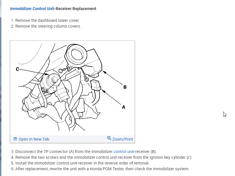

Okay. I suspect the immobilizer is the issue but let's just rule out a weak or drained battery. Sometimes this can cause some odd issues especially since it was sitting for a couple days.
As long as the battery tests okay, I would suspect the immobilizer is not picking up the key.
