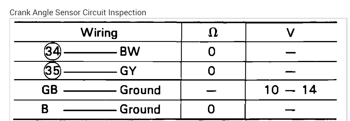

Ran codes using a jumper wire. Got a code 41. Crankshaft position sensor error. Can't locate the sensor on the engine.

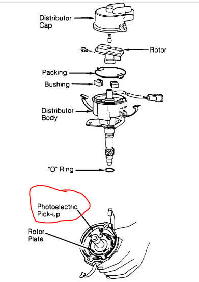

What I need is the location of the crankshaft position sensor. 1992 Isuzu amigo 2.6 5 speed.
Apr 24, 2024 at 11:23 AM
  • 110,244 POSTS
This doesn't have a traditional crankshaft position sensor. On this vehicle, it is a pick up coil inside the distributor. See pic below.

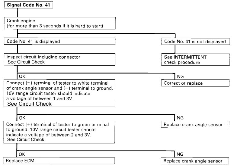

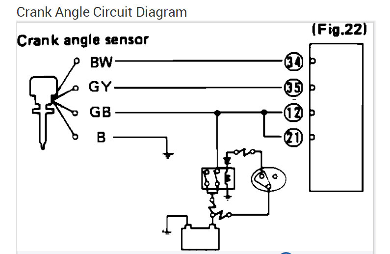

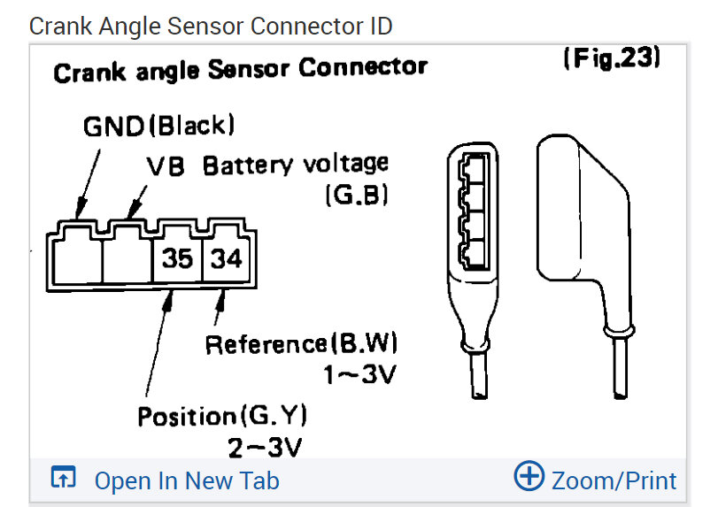

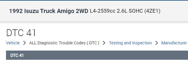

You are very welcome. As far as the code is concerned, it is related to the sensor you mentioned.

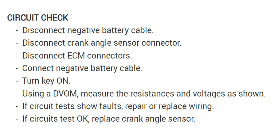

If you look below, I attached the diagnostics specific to the code. Take a look through them and let me know if you are comfortable performing them.
Let me know what you find.

No problem. The diagnostics are to determine if the pick-up/crank sensor is working properly.
If you are uncomfortable performing the test, by any chance do you have access to a different distributor?
If not, try this. Disconnect the battery for approximately 30 minutes. When you reconnect it, the code should be cleared. At that point, crank the engine a few times and see if the code comes right back. If it does, I suspect the distributor may need replaced.
