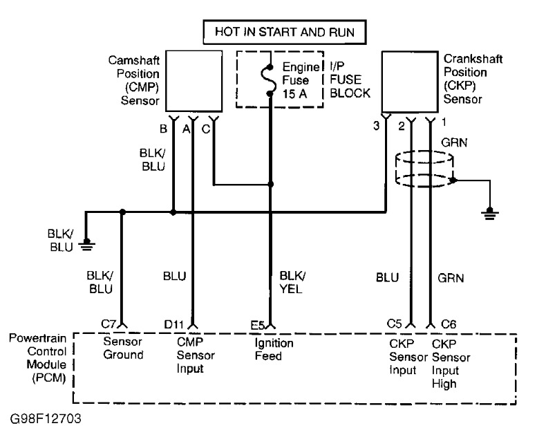

1998 Isuzu Amigo 2.2L
Only receiving 1.1 volts on the crankshaft position censor circuit, rather than the required 5 volts. Why?
On the CKP plug coming from the PCM, the ground terminal is good. On the other two terminals I only receive 1.1 volts. Best I can tell, that indicates a PCM problem. Also, I thought one of the three wires on the CKP sensor was supposed to be ground but I have no continuity with ground on the CKP sensor plug/harness.

Here is how to check it see schematic as well.
Perform On-Board Diagnostic II (OBD-II) system check. See TESTS W/CODES-INTRODUCTION article. Go to next step.
Turn ignition off and disconnect CKP sensor. Turn ignition on. Connect DVOM between 5-volt reference and sensor ground terminals at connector harness. If DVOM reads 5 volts, go to step 5). If reading is not as specified, go to next step.
With ignition on, use DVOM to backprobe PCM connector reference and ground terminals. If DVOM reads 5 volts, go to next step. If reading is not as specified, go to step 9).
Using DVOM, check resistance at reference and ground circuits at CKP harness connector. If an open or short is discovered, repair circuit. Retest system.
Turn ignition off and disconnect PCM and CKP sensor. Check for an open or a short in 58X reference circuit between CKP sensor connector and PCM harness connector. If a problem is found, repair as necessary. Retest system. If no problem is found, go to next step.

Thanks for the quick reply. Back-probed the PCM ground and reference terminals: Got 1.2v. PCM replacement is necessary.
Ohming out the CKP sensor I get an open circuit. Should I see a particular resistance or does this mean the CKP sensor is bad as well? Wiring looks normal and undamaged, CKP sensor was working fine yesterday.

Repaced the PCM with a used one which had the same identical 10 digit serial number. First thing I did was check for codes on the replacement PCM. They were long gone if there were any. Turned the key on and checked for reference voltage on the CKP harness. Only had 1.2v. That was.1v more than the old PCM. Backprobed the PCM, again only 1.2v. Decided to try to start it and it actually fired-up and ran, although a bit rough. Wouldn't even hit at all with the old PCM.
Additionally, I receive 5v on one terminal of the CMP harness and 7.3v on the other terminal of the CMP harness. Is there a chance that something in the wiring could be dragging the voltage down from the required 5v reference on both the CKP harness and PCM plug? (Terminals 5.6 &7?)

It could be a bad connector or a wire hitting someplace against the block or partially grounding out. Have you done the simple stuff like check the ecm main relay as that may not be supplying enough power to pcm to begin with. You should have battery voltage on one of the cmp connections so if it's not then there may be a short in harness or the ecm main relay isn't working very well and causing this. What were the original codes anyhow as you just started giving figures of voltage readings. Here is the way to check cam sensor power which you already have the pic I sent earlier if there is not up to snuff that is probably your problem but check the ecm main relay first.

I simply gave the correct voltage I was receiving in the CMP harness as a comparison the the incorrect voltage I was receiving in the CKP harness. There are no problems in the CMP circuit. Part of the problem is that I have "NO CODES". It seems that the CKP circuit is malfunctioning and not generating a code.
I am receiving 12.3v on two terminals of the ECM relay and 3.9v on the third terminal of the same relay. Currently looking at the schematic to see if it should be more than 3.9v on the third terminal of the ECM relay.

Again, for anybody else reading who may be having related problems: here are the "knowns" so far:
1998 Amigo 2.2L, 2WD, MT
1. PCM puts out 1.2v instead of the required 4.98v or 5v on two 'non-ground' pins of the CKP feed harness.
2. Pin C8 on the PCM connector is deader than a doorknob. No continuity with ground whatsoever. Any ground anywhere.
3. When back-probed at the PCM connector, the voltage to the 'non-ground' CKP pins is still 1.2v.
4. When the green H-5 connector below the brake fluid reservoir is unplugged, ( or what I believe to be the H-5. Not sure) and voltage read from the CKP pins of that connector, then the voltage jumps up to 7.1 volts.
5. When CKP pins are back-probed on the PCM connector with the H-4 connector disconnected, the voltage is still 7.1v.
6. The two wires responsible for the problem/voltage jump seems to be the black/blue and blue/red wires on the bottom of the H-4 connector. (Pins 13 & 14)
