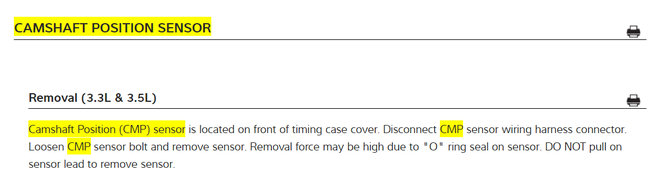

My car 1994 Chrysler eagle vision. It suddenly refuse to start even though the ignition coil is working, spark plugs are good, fuel pump is in a good condition, but the car doesn't start.
Tuesday, August 20th, 2019 AT 7:17 AM
4 Replies
SCGRANTURISMO
  • 4,897 POSTS

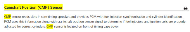

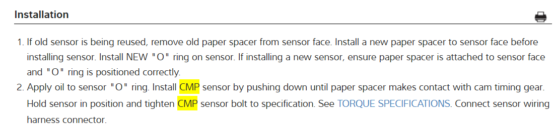

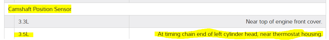

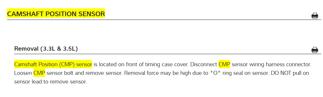

This could be a problem with your Camshaft Position Sensor (CMP). Your vehicle's Power-train Control Module (PCM) or "computer" uses the signal from the CMP and the Crankshaft Position Sensor(CKP) to fire the spark plugs and the fuel injectors at the proper time. In the diagrams down below I have included a description of the CMP's operation, a description of it's location, and the factory guide for the removal and installation of the CMP. Please go through these guides and get back to us with what you are able to find out.
