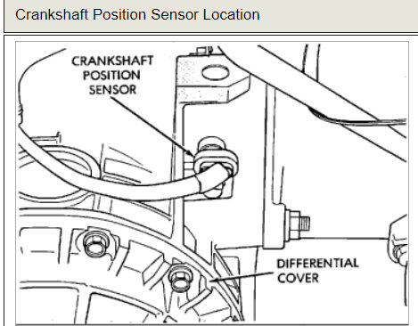

I have 94 chrysler concord it wont start it also is not getting a spark i had the camshaft sensor changed but it wasn't the problem what should i try next?
Dec 21, 2007 at 1:34 PM
  • 54,837 POSTS
This sounds like a classic crankshaft angle sensor that has gone out. Here is a guide to give you an idea of what you are in for when doing the job.
Here is how it is done on your car (Below)
The crankshaft position sensor at the transaxle bellhousing. That checks out time to go thru all ignition components such as the coil, distributor pick-up, ignition control module and cam and crankshaft sensor. Or the computer itself. Do you have power to the coils?
Here is a full guide
