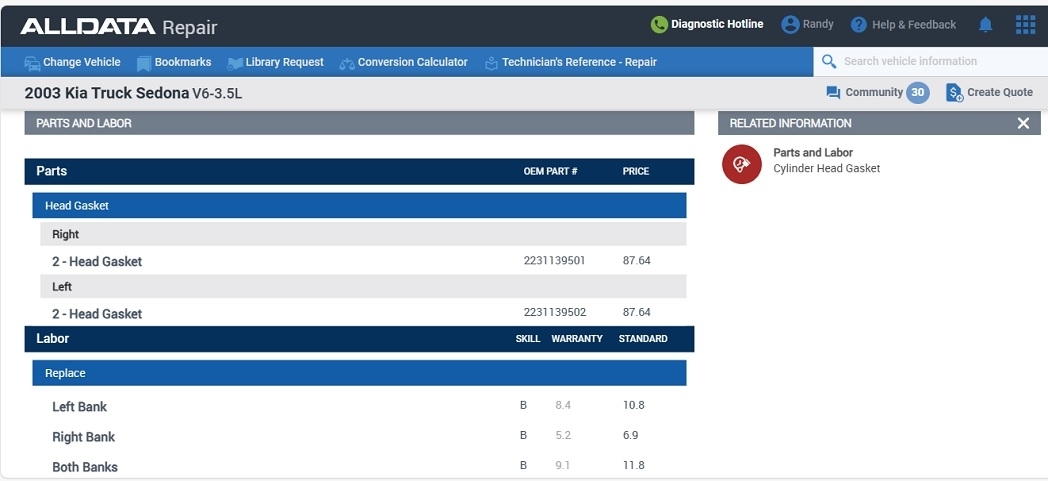

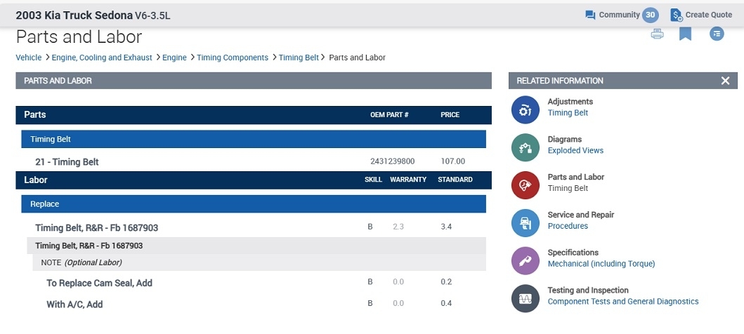

Enough for blowing my own horn. I was mulling over another comment of value last night regarding the $800.00. I don't know yet what that was supposed to cover, so I looked up the various procedures that might be part of this story. For a 2003 Sedona, replacing the timing belt is supposed to take 3.4 hours with an additional 0.4 hours if the vehicle has air conditioning. (There's more to take apart if there's AC). If a camshaft oil seal is found to be leaking, or if the mechanic thinks it's a good idea to replace it due to high mileage, that's another 0.2 hour. Total is four hours. The belt is listed as costing $107.00. That is usually cost from the dealer's parts department. Aftermarket sources usually cost less and are perfectly fine as far as quality. I know it sounds expensive, just like with veterinary bills and doctor bills, but I don't know how shops are able to survive when they "only" charge $125.00 to $150.00 per hour. I wrote up a list years ago of all the taxes, insurances, costs to meet government regulations, and all the expenses they have to pay before even considering wages and benefits. It was a two-column list that filled the page. Even if they charged $100.00 per hour, you'd have a $500.00 bill just for the timing belt. That is on the low side of other bills I've seen.

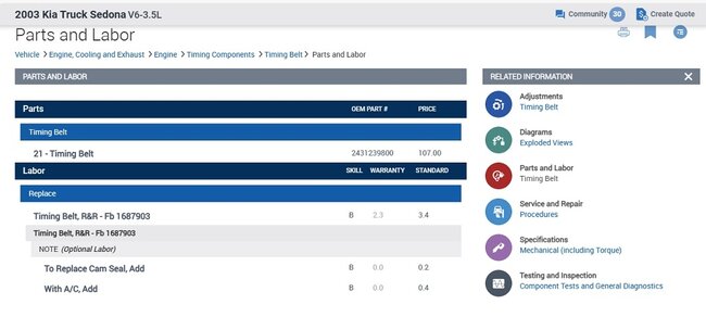

Now when you get to cylinder head gaskets, the "left bank" is listed as taking 10.8 hours. The right bank takes 6.9 hours. It is standard practice to do both sides at the same time, just like you do not buy just one shoe at a time. A large part of each cylinder head involves parts that have to be removed for each side, so those are only done once in the procedure. The total to do both cylinder head gaskets is 11.8 hours. To say that a different way, once the left bank is disassembled, it takes just one more hour to do the right bank at the same time. The head gaskets are listed as costing $87.64 each. I posted what we look at from the Flat Rate book below. By using that as a guide, it ensures you're quoted the same amount of time from multiple shops. The only variable is their hourly shop rate. Mechanics get paid by those listings too. If one invests in expensive, special tools, or advanced training, he might get done faster, but you pay the same amount. If he works slowly, like I did, or has less experience, it will take him longer than the times given, but he only gets paid for the times listed, and you do not pay more. Think of a barber with a set rate for a haircut. Doesn't matter if you're almost bald and he has to cut three hairs, or if you look like a hippie and he spends all afternoon slicing the locks off. Both pay the same amount.
The point I haven't made yet is replacing the head gaskets is usually over a $1500.00 job. Part of that job involves removing the timing belt, so that procedure is already partially done. If a new belt is needed, the additional labor time will be less than what's listed for just the belt. $800.00 isn't going to cover the head gasket job. That's why I'm questioning what was done already. There's usually a plastic dress-up cover on top of the engine, then the intake manifold must be removed. Those two parts alone can look like major engine work was done. The closest I can come to calculating a legitimate cost of $800.00 is to replace the timing belt and reassemble the intake manifold. I would sit down and negotiate that with the shop owner as it suggests the intake manifold did not need to be removed. The exception would be if that is what was necessary to inspect other parts, namely the lifter you mentioned, but that too is suspect. One collapsed lifter will make a ticking sound, and you might notice a slight misfire or engine vibration, but that will not cause the engine to stall.
What I'm hoping this boils down to is the legitimate repairs, once we know what those are, will cost around $800.00, leaving you with a properly-running engine. If that turns out to be true, neither mechanic is really at fault for their services. What does leave the sour taste is you were not kept informed of what was needed. We really dislike surprises except when we hand someone a final bill that's less than they were expecting.
I'm afraid I still might not have provided the help you need, so if you can post a photo of any paperwork, or if you can obtain a written list of the parts that need to be reassembled, those might help. One thing I do want you to watch out for is if other work is needed, lets say the cylinder head gaskets, it is to your disadvantage to insist the engine be put back together, then taken apart again by a third shop. You would be paying multiple times to have the same work done over and over.
I should mention too the water pump is driven by the timing belt. As such, it is no longer a one-hour job to replace it. Every conscientious mechanic in the world who has your best interest at heart is going to want to replace that water pump along with any critical tensioner or idler pullies and adjusters. Those parts and the additional labor aren't included in the labor times I posted. To not replace those parts while they're down in there would be like buying a whole new wardrobe, but continue wearing my old, smelly socks. It doesn't make economic sense to ignore them and take a chance one of them won't fail soon. Going in a second time would cost just as much as it does to do the timing belt.

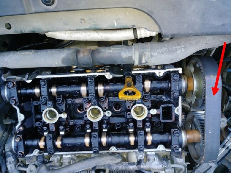

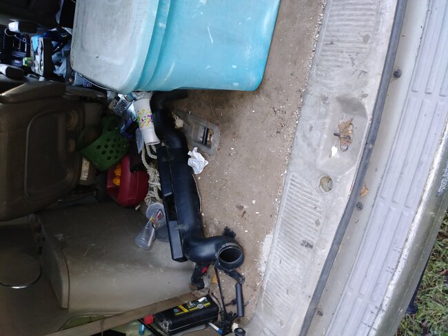

So, I had a flatbed come bring my van home to me the other day and this is how it came back. My question is still this, will another mechanic be able to put it back together properly and be able to diagnose what is actually wrong with it and fix it?? As I am sure I said before, the second mechanic who took it apart like this had already agreed not to touch it and to tow it back to me and refund me the cash I had paid him in advance. When he did not bring my van back as promised and over a week had gone by, I hired a flatbed to bring it back to me last week. I was and am really upset that he didn't keep his word, which was in writing in several texts, and instead chose to dismantle my vehicle. I am sure he did this in an attempt to run up a bill so he did not have to give me back any money. And the reason I did hire a flatbed to retrieve my van was because I was getting bad vibes from the guy and had started feeling like I couldn't trust him and i guess that was rightly so. So, my question is still this, will another mechanic be able to put it back together properly and be able to diagnose what is actually wrong with it and fix it?? I see several loose bolts in the back of my van which worries me. Also, what about dirt or debris getting into the cylinders since the engine which was left open like that??

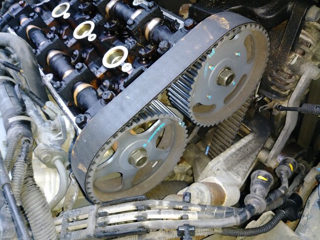

I don't know if the pictures show the timing belt clearly, but I did look at it while taking the pictures and it looks absolutely fine with no missing teeth or damage to any of the visible parts, although I do realize some areas cannot be seen.

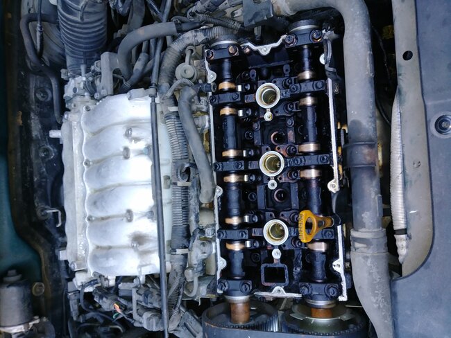

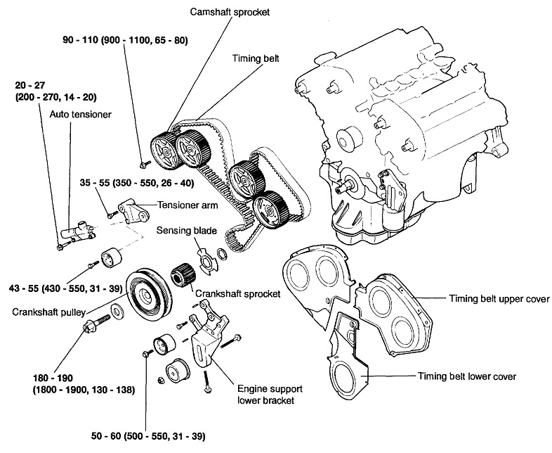

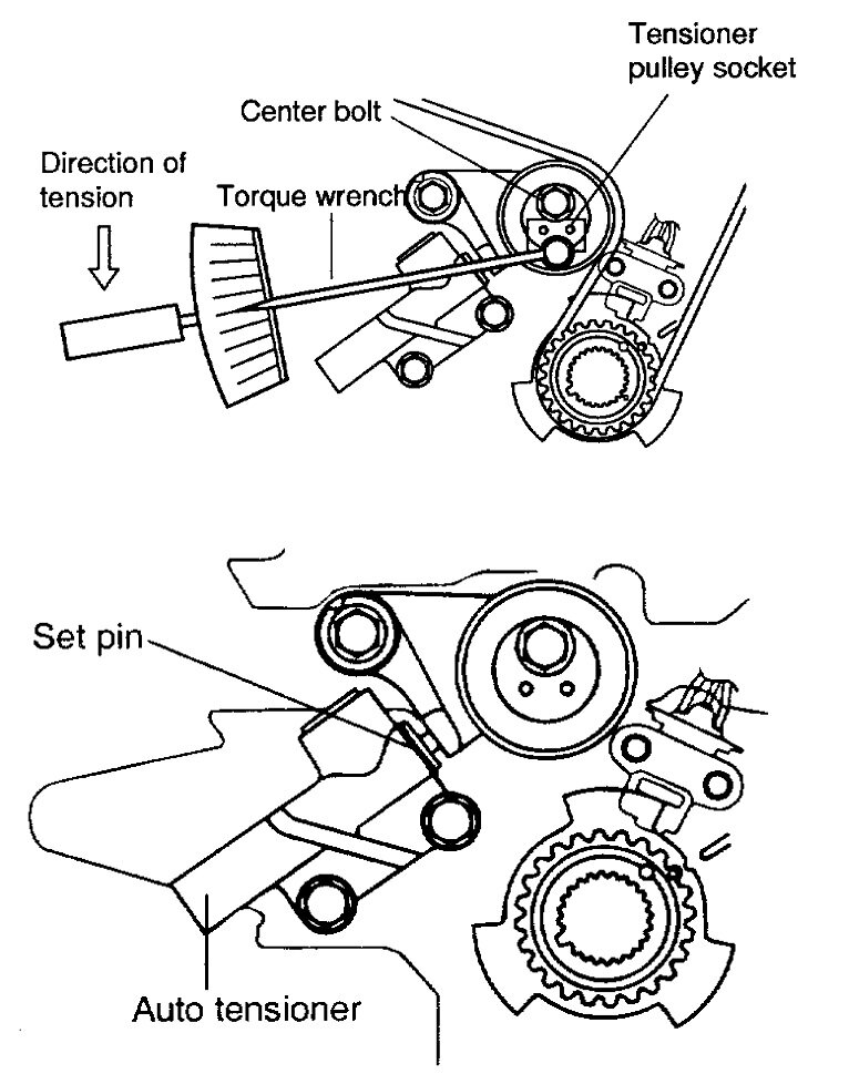

Thank you. I'm feeling better now. In the first two photos, we're seeing the cylinder heads still bolted to the engine block, so those were not removed. It's only the valve covers that have been removed. That may be necessary to get to the timing belt. It depends on the engine. There's nothing unexpected or inappropriate there. I added a red arrow pointing to the timing belt. Feel and look at it as best you can to see if any teeth are missing. That's one of the first signs it's overdue for replacement. Next, push up and down on it right between the two sprockets, (just below the point on the arrow). You should not be able to flex it more than about 1/4" with hard pressure. If it is loose or flexes easily, a tensioning device is worn out. That will allow a good belt to jump and possibly lead to expensive valve damage.

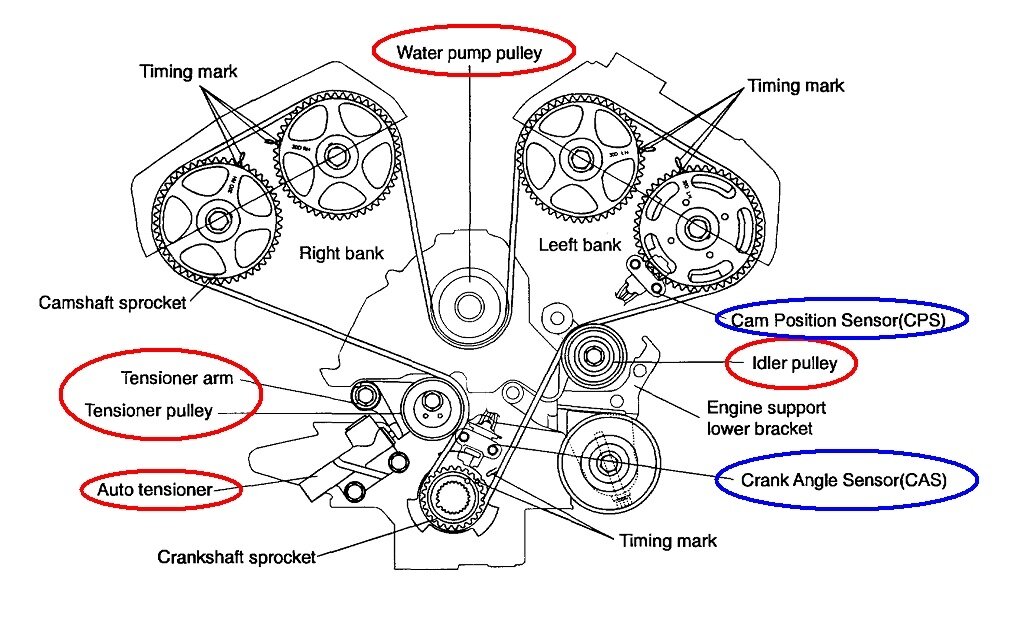

In the second drawing, I circled in red the additional items every conscientious mechanic is going to want to replace. To not replace them suggests he is more interested in saving you a few dollars today while risking another expensive repair later. I can rub two nickels together until they squeal, but even I would replace these parts on my vehicles. I added the last two drawings just because they showed up under this topic.

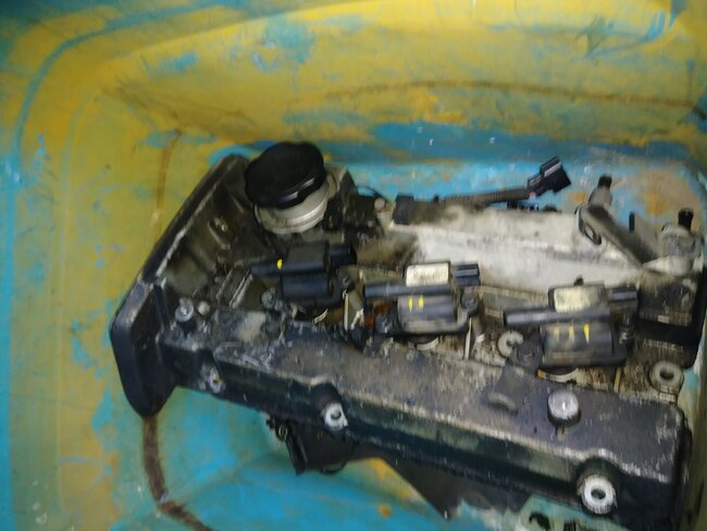

Your third photo just shows the fresh air intake tube. That's a minor part that takes about a minute to reattach. Your fourth photo shows one of the valve covers. Having the "Oil" cap suggests that one goes on the front of the engine. While that looks like a big part, and there should be two of them, it is light enough to be lifted by one strong girl or two weak boys. Woops. That comment was meant for a cylinder head. Yours will be made of aluminum and could weigh perhaps 40 to 50 pounds each. A small boy can carry two valve covers. They're light but will be greasy or oily.
Everything I see here so far can be reinstalled in less than an hour by a mechanic familiar with this engine. Being unfamiliar with this one specifically, I would probably take an hour and a few minutes. The next question has to do with the front of the engine. If that is apart to the point you can see most of the parts shown in the drawings, that 4.0-hour job is half done. The other half is to put the parts back together. It depends on whether any new parts were already installed.
If the second mechanic wants $800.00 to replace the timing belt, and all the components I circled in red, I'd suggest you were given a fair quote, although it could have been presented and handled a lot better, meaning more professionally.
One thing that I find very discouraging is the two parts I circled in blue. One is the camshaft position sensor, a part with a known failure record on all car brands. The other is the "crank angle sensor". That's a fancy name for the crankshaft position sensor, another part that fails regularly. Depending on the engine and the model year, the engine will not run if one or both of them fail. 2003 is right in the middle of where both sensors must be working for the engine to start, but then if one fails while running, the engine will continue to run until it is stopped, then it won't restart. On many newer models the engine will always restart with one failed sensor, but power or top speed might be limited. On most other engines, including my Ram truck and Dodge Caravan, those are both very easy to get to, so they only get replaced when necessary. Each one takes about five minutes to replace. With this design with the sensors behind the front engine cover, replacing the camshaft position sensor calls for 1.1 hours, and the crankshaft position sensor calls for 2.5 hours. Now you have a tough decision. With two greatly different times listed, it suggests the front cover is in two pieces with only the top half being removed to get to the cam sensor. Regardless, replacing either one is a big job that most competent do-it-yourselfers aren't equipped to handle. Do you wait for one to fail, then call a tow truck and pay another expensive repair bill, or do you have them replaced right now while they're out in the open? Logic would dictate replace them now, like with the timing belt tensioning parts, but unlike with those mechanical parts, new electrical parts also have a very high failure rate. You might be removing a properly-working sensor to replace it with one that is just as likely to fail in short order. This is where I would defer to a Kia specialist to find out what kind of experience he has had.
If there's no one to ask, I would have both sensors replaced for one simple reason. The engine stalled, but it ran okay later. To me that says it is time to replace the timing belt based just on mileage, and given the difficulty if you wait, and the chance one of them caused the stalling, get them replaced now. I don't like spending other people's money, but you won't remember that small. additional cost when you're sitting on the side of the road in a pile of tears, ... in the middle of winter, ... on a Saturday night.
As for right now, it's a good idea to cover the cylinder heads and camshafts to keep dust and dirt out. Newspaper works well, as does rags like from old pillowcases. Most mechanics get pretty excited about dirt in this area, but if you keep leaves and bugs out, minor dust will get carried away by the oil to the oil filter. A bigger concern is mice. They love all the little holes in the cylinder heads. I have a number of cars sitting outside, so I have cats to protect them. A telltale hint to your mechanic is if he sees acorn chunks. He will check a little closer before closing things up.

I'm back. Our replies are out of sync, so you may have seen some of my wondrous comments by now. Since the cylinder heads have not been removed, the cylinders are not exposed so no dirt will get in there. You can use newspaper or an old pillowcase to cover the cylinder heads, but the bigger concern is mice. They love to build nests in there. I have multiple cars that sit outside, so I keep a platoon of cats to patrol the area.
Reinstalling the two valve covers will not take long. Yours look very similar to those on older Mitsubishi engines built for Chrysler. I had one of them in my '88 Grand Caravan. The valve cover gaskets are rubber and are reusable. It's the front of the engine that will be more involved. If the timing belt was replaced at around 60,000 miles, leave it alone. I would recommend replacing the two sensors since you're right down there, and given the symptoms.
