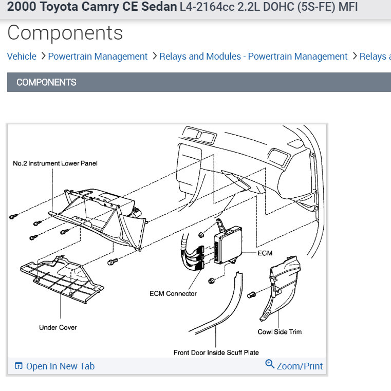

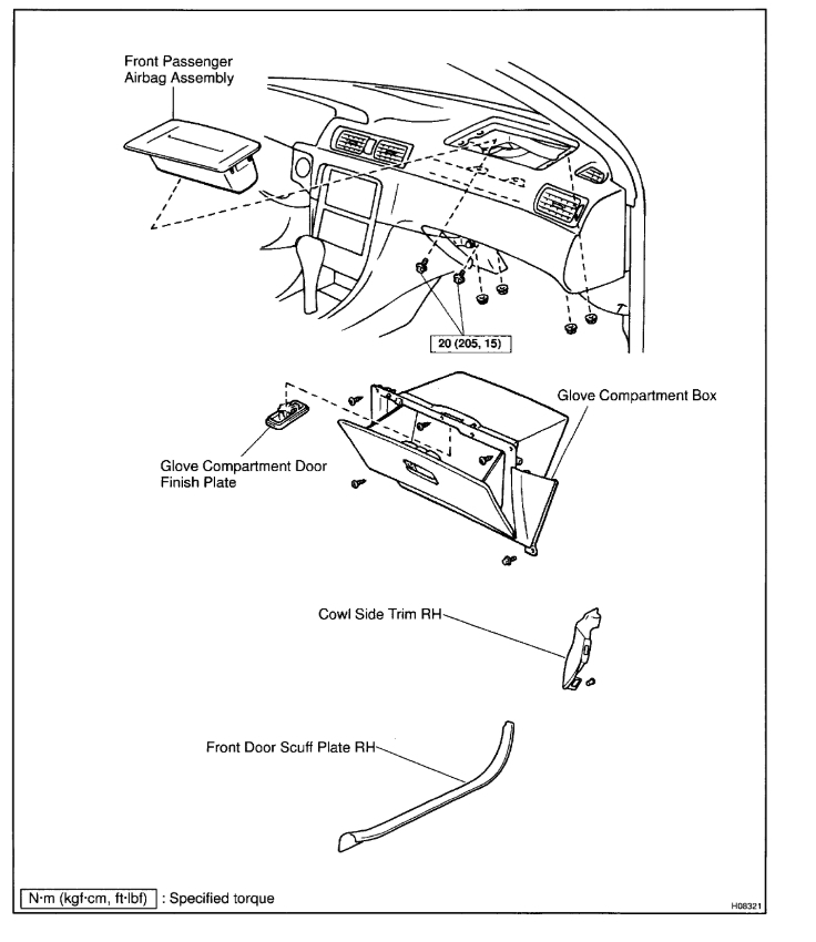

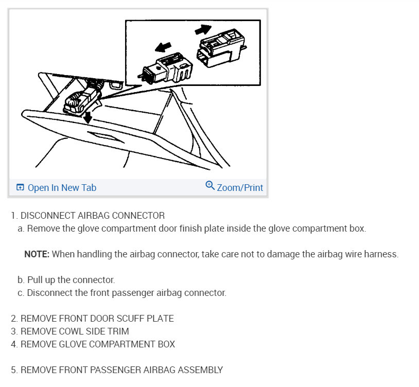

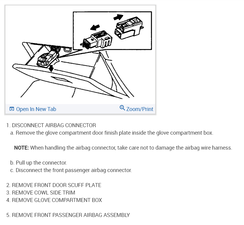

P.S. On the left side of the glov box there is a screw with a string connected. Do I need to remove that screw and string assembly?
Monday, June 17th, 2019 AT 10:44 AM
KEN L
  • MASTER CERTIFIED MECHANIC
  • 48,296 POSTS
I think so. Here are institutions and diagrams to help you get the glove box out. Check out the diagrams (below). Please let us know what you find.

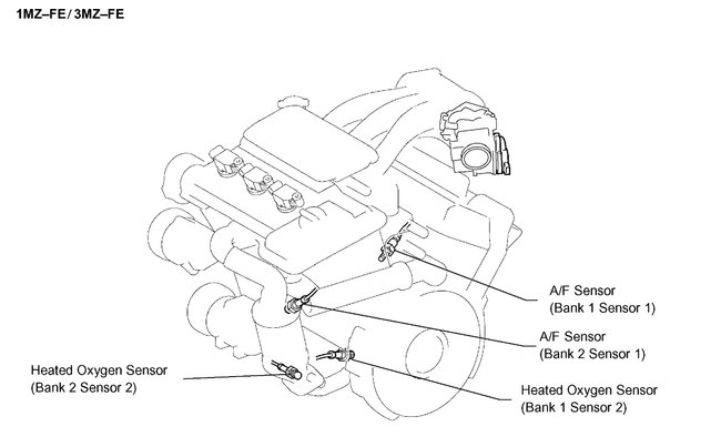

The code is for the air/fuel sensor still and you said you replaced it or? If not start there and if that doesn't fix it I would try a used/rebuilt ECU here is the location. Check out the diagrams (below). Please let us know what you find.
Tuesday, June 25th, 2019 AT 11:47 AM
ZORRO9099
  • 24 POSTS
When you say air/fuel sensor, are you referring to the O2s? I didn't change any as we were doing these tests. Is bank 1 the side closer to the firewall?
Tuesday, June 25th, 2019 AT 1:37 PM
KEN L
  • 48,296 POSTS
Here is the oxygen sensor locations and a guide to walk you through the replacement.

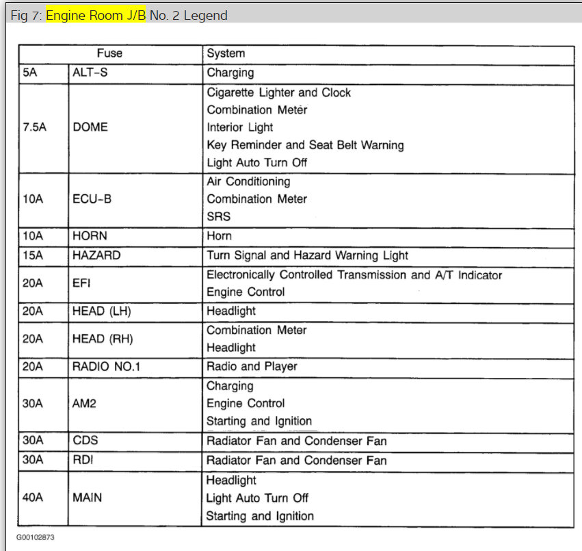

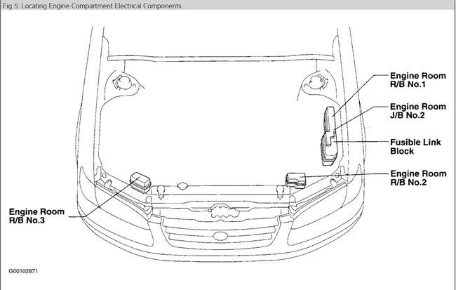

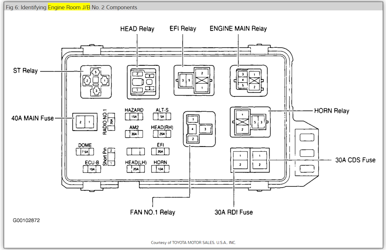

Update: Things went from bad to worse: The OBD reader suddenly "failed to link with vehicle" and the car stopped starting at all, cranks, but no spark. I took a break these past months. Here we are now: tested crank sensor voltage. I only got.77 volts at the ECU black/red wire (to crank sensor) and at the crank sensor socket only got.77 volts. Then,
I swapped the ECU with a used one and here are the results: only got.77 volts at the black/red wire at the crank sensor, the first time, then I couldn't repeat that rending at sensor. I also got the.77 volts at the ECU black/red wire, still not the 5 volts needed. In other words, the same readings as with the other ECU. Now what? Still fails to link to OBD reader.
Monday, December 30th, 2019 AT 9:57 AM
KEN L
  • 48,296 POSTS

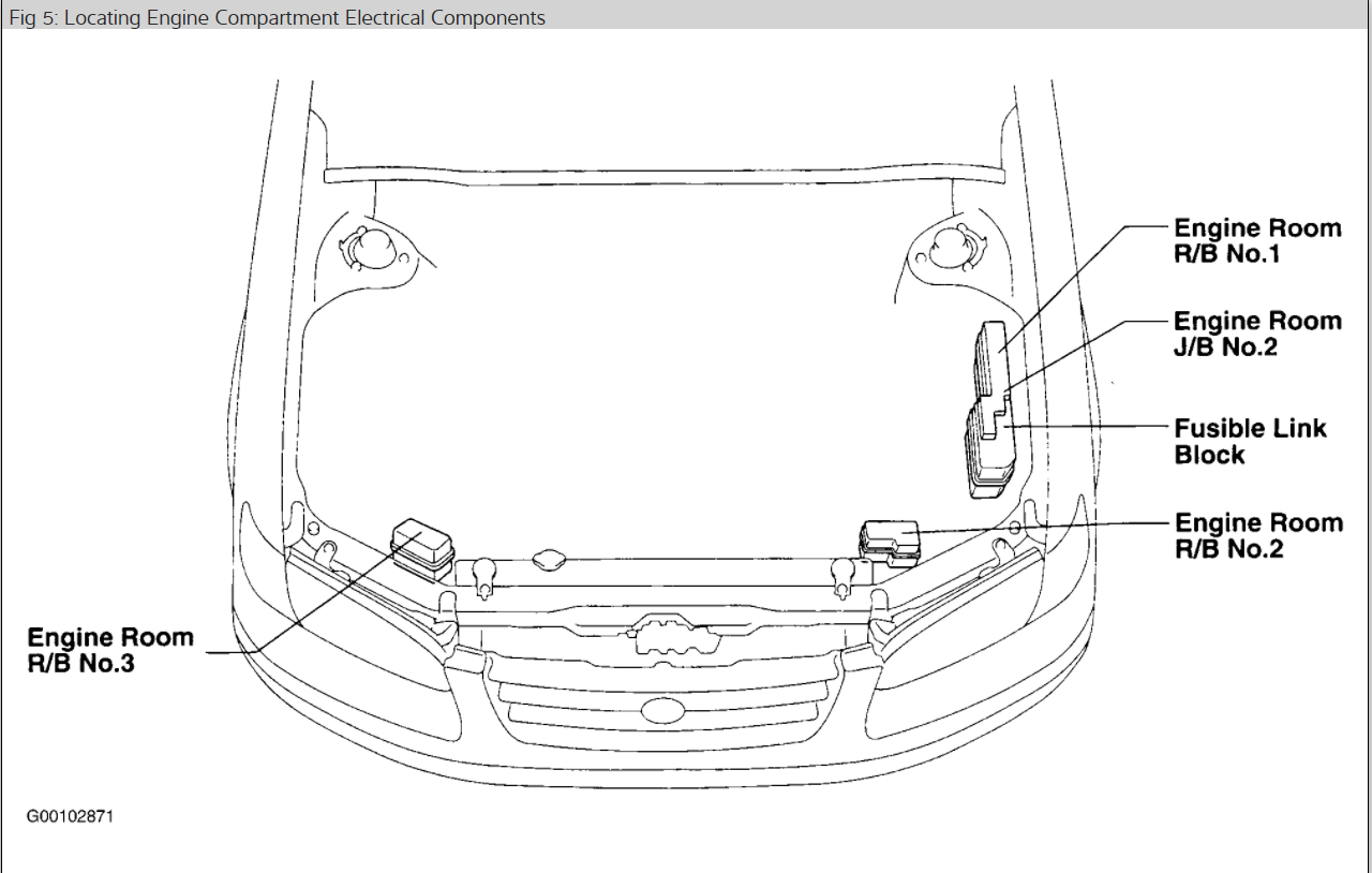

Have you checked the EFI and main relay? here is a guide to help and the location of the relay. Also the security light is not flashing correct?
Monday, December 30th, 2019 AT 5:33 PM
