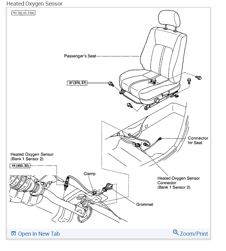

I think we have found it the P1135 is a oxygen sensor heater which when shorted can cause the engine to stall out. lets unplug the oxygen sensor and restart the engine to see if it stalls. don't worry about the way it runs when the sensor are disconnected. here are the locations and a guide to help change them out:
https://www.2carpros.com/articles/how-to-replace-an-oxygen-sensor
Jun 4, 2019 at 4:20 AM
ZORRO9099
  • 24 POSTS
Are you suggesting the engine shouldn't turn off with the O2 sensors disconnected? How will I know the difference since sometimes the engine does run and does not shut off?
The codes seem to say both upstream sensors are bad. Is that likely? What is the P1411 code or is that related to the O2 codes? Also, is this one of those vehicle that requires OE branded O2 sensors in order to clear the codes in the ECU and/or turn off the check engine light? (I've come across stories where people claim a certain brand is required.)
Jun 4, 2019 at 4:34 PM
  • 55,721 POSTS
Yes, use OEM sensor you can run the car without the sensors connected it will run from the base program. This is to see if one of the sensor heaters is causing the engine to stall which is probable.

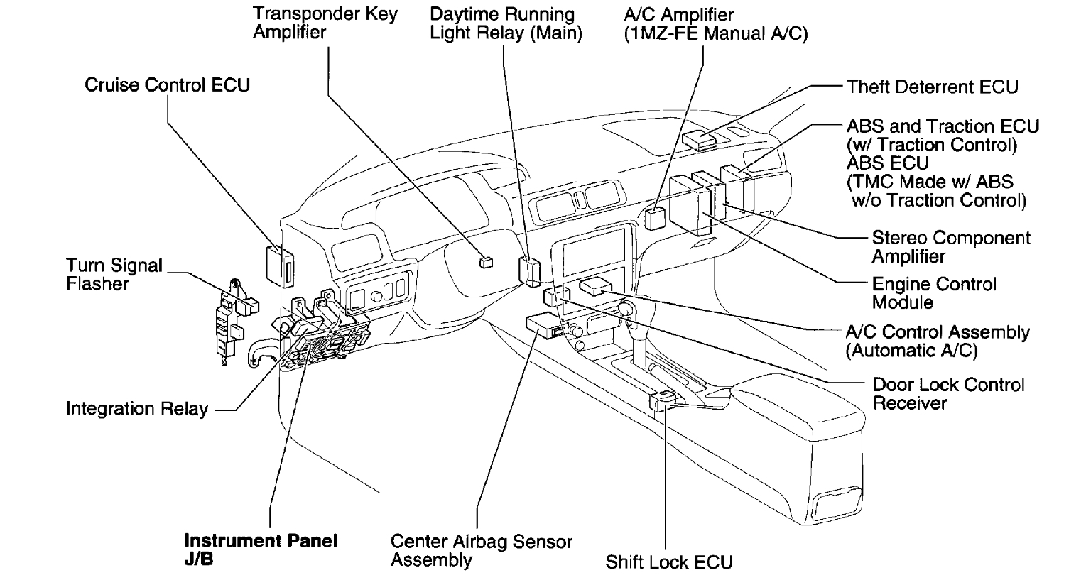

The only way to be sure is when it stalls use starting fluid to see if it will run, but to me it sounds like the ECM is bad which will not have a code. Also when it stalls, turn the key off and then back on again without cranking the engine you should hear the pump prime for 5 seconds.
Jun 12, 2019 at 4:43 AM
ZORRO9099
  • 24 POSTS

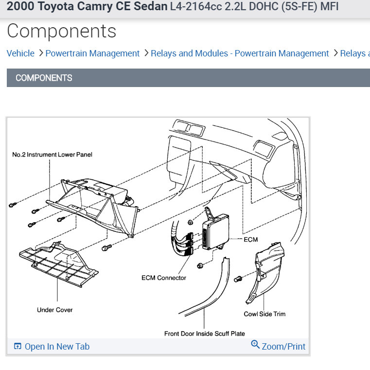

When you say use starting fluid, do you mean I should have the throttle body area ready/open to spray in the fluid around the 15 second mark and see if the engine keeps running? Is getting to the ECM as easy as popping off the glove box door as the diagram shows?
Jun 12, 2019 at 4:20 PM
  • 55,721 POSTS
Yes and yes, you may need to remove some additional parts to get the ECM out. Check the electrical connectors for corrosion as well.
Jun 14, 2019 at 4:29 AM

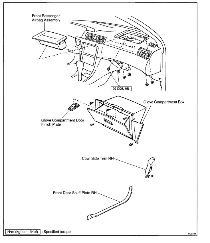

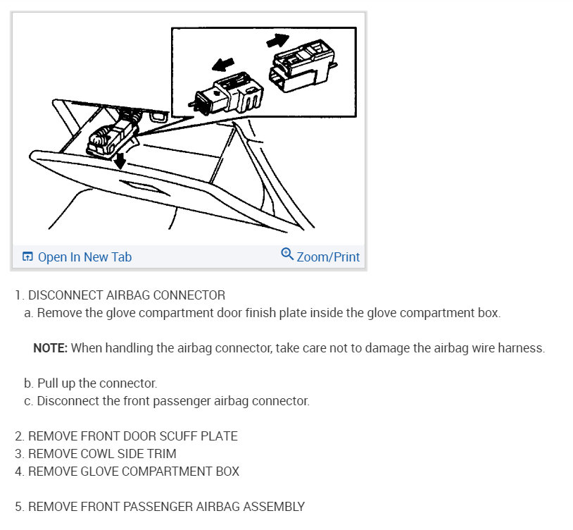

As for removing the glove box, are there any screws or just squeeze real hard the sides?
Jun 17, 2019 at 1:55 AM
ZORRO9099
  • 24 POSTS
p.s. On the left side of the glov box there is a screw with a string connected. Do I need to remove that screw and string assembly?
Jun 17, 2019 at 3:44 AM
  • 55,721 POSTS
I think so. here are institutions and diagrams to help you get the glove box out. Check out the diagrams (below). Please let us know what you find.
Jun 17, 2019 at 4:27 AM

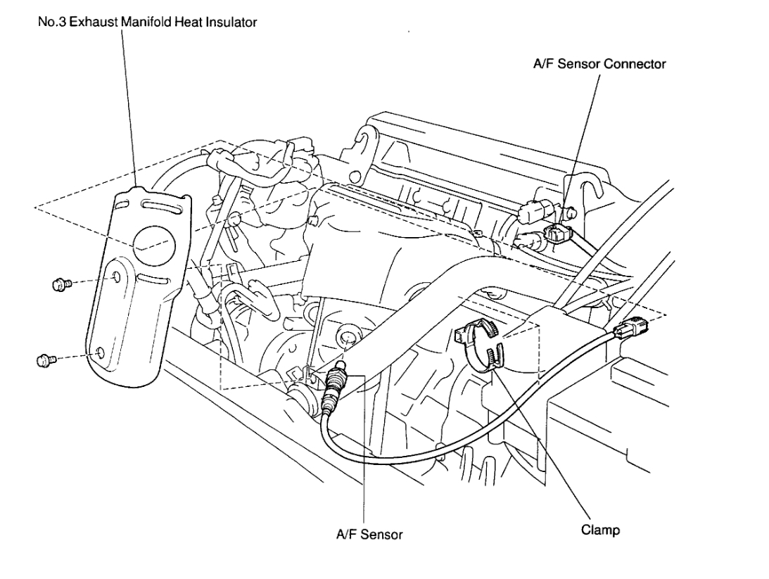

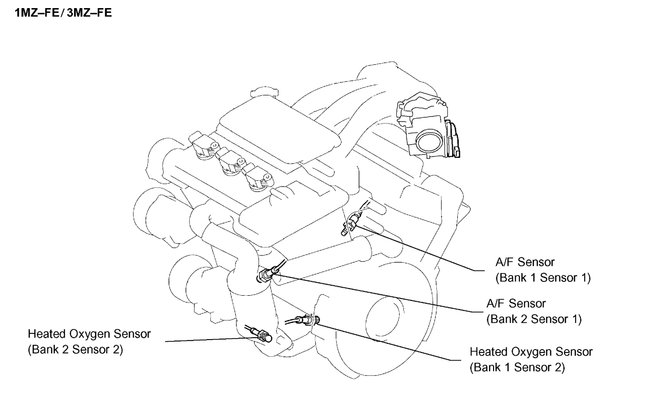

The code is for the air/fuel sensor still and you said you replaced it or? If not start there and if that doesn't fix it I would try a used/rebuilt ECU here is the location. Check out the diagrams (below). Please let us know what you find.
Jun 25, 2019 at 4:47 AM
ZORRO9099
  • 24 POSTS
When you say air/fuel sensor, are you referring to the O2s? I didn't change any as we were doing these tests. Is bank 1 the side closer to the firewall?
Jun 25, 2019 at 6:37 AM
  • 55,721 POSTS
Here is the oxygen sensor locations and a guide to walk you through the replacement.

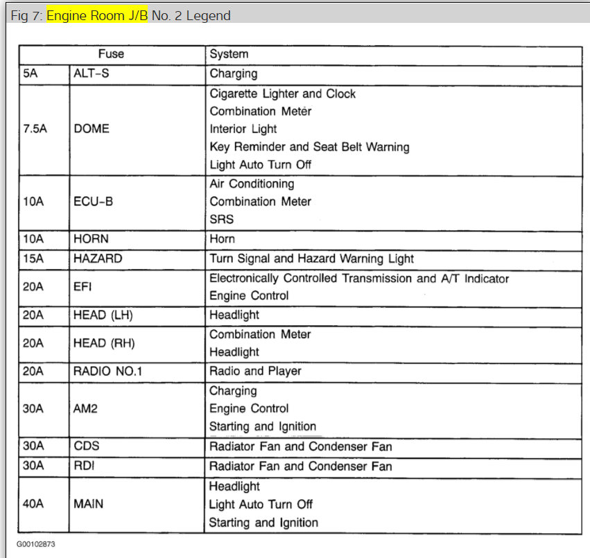

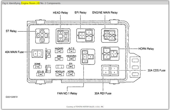

Update: Things went from bad to worse: The OBD reader suddenly "failed to link with vehicle" and the car stopped starting at all, cranks, but no spark. I took a break these past months . Here we are now: tested crank sensor voltage. I only got .77 volts at the ECU black/red wire (to crank sensor) and at the crank sensor socket only got .77 volts. Then,
I swapped the ECU with a used one and here are the results: only got .77 volts at the black/red wire at the crank sensor, the first time, then I couldn't repeat that rending at sensor. I also got the .77 volts at the ECU black/red wire, still not the 5 volts needed. In other words, the same readings as with the other ECU. Now what? Still fails to link to OBD reader.
Dec 30, 2019 at 1:57 AM
  • 55,721 POSTS

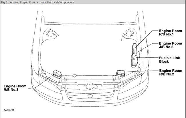

Have you checked the EFI and main relay? here is a guide to help and the location of the relay. Also the security light is not flashing correct?
