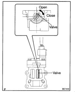

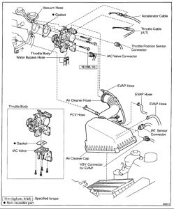

Well - let's get the IAC checked so we can get that off the question/answer board. You can do this, I have attached the check for you and the location.

IDLE AIR CONTROL (IAC) VALVE
INSPECTION
INSPECT IAC VALVE OPERATION
https://www.2carpros.com/forum/automotive_pictures/248015_IAC_1_1.jpg
Check that the IAC valve is half opened.
Connect the IAC valve connector to the IAC valve.
Turn the ignition switch ON.
Check that the IAC valve moves in 0.5 seconds by order of fully close, fully open and half open. If operation is not as specified, replace the IAC valve.
Turn the ignition switch OFF.
Disconnect the IAC valve connector from the IAC valve.
Location
https://www.2carpros.com/forum/automotive_pictures/248015_IAC_2_1.jpg

I would have thought the dealer would have checked it. There is an in the vehicle check they can do from what I see. But you did not indicate that and from what you said they said, they didn't either which bothers me. I wasn't there to ask them certain questions but to me they should be able to say we checked it and it is okay. Not, we are not sure so replace it and maybe it will or will not fix the problem. Gee, we can do that. You took it to them so that their certified trained mechanics can use the specialized test equipment that most of the time only the dealer can afford and has so they could perform all of the tests and tell you what is good or bad, in this case if the IAC is good or not.
So based off of what you said to me, they have not properly checked the car out and treated you correctly.
So I figured okay, then you do the check. It involves removing it, doing the check I have provided and then you will know if it is good or bad so we can take that off the list.
I am not saying take it back to them and have them check it out. Based off of what you said I would find a different auto shop to take the car to.

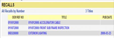

By the way, it looks like you may have some recalls on your vehicle. The dealer may fix these for free. Please contact the dealer service department, give them the VIN number of your car and have them check on these to see if they apply to you.
https://www.2carpros.com/forum/automotive_pictures/248015_Recalls_14.jpg
