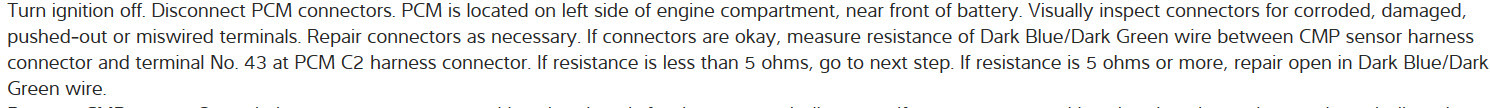

see pic for instructions on checking wiring . also look near pcm for battery corrosion loose pins and poor connections. It may be a bad pcm but have a pro check it because he will have to program the anti theft as well as other things to install it. Also check for a vacuum leak as well
