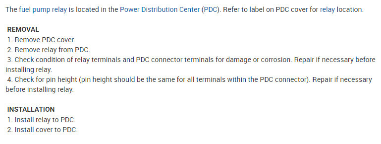

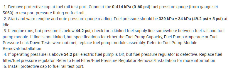

As you know you will need spark and fuel to start the engine (and compression).
If the fuel pump is not coming on that could be issue.

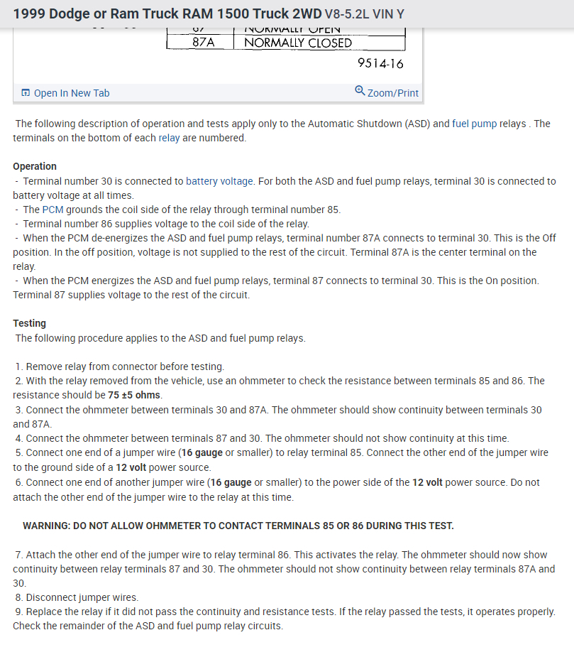

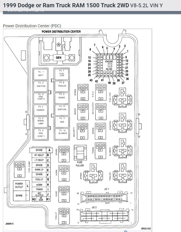

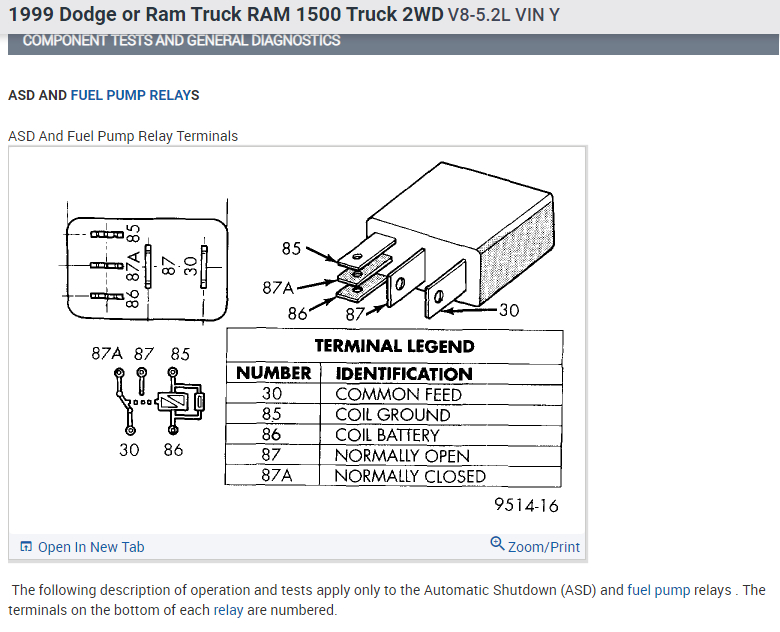

Have you tried swapping the fuel pump relay?

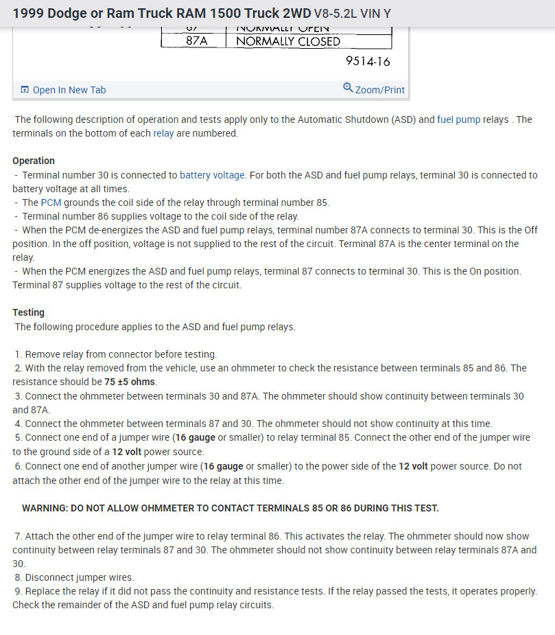

You can also test that relay as well:
Just to clarify, you did not have this no start issue before you did the freeze plug, right?
The crank sensor could be the culprit but first make sure that you are getting fuel to the injectors. As I don't see any reason for the crank sensor to go out, unless it was bumped or something not aligning properly.
Have you checked to see if you are getting spark?
Please let me know what you are experiencing.

Thank you for responding. So, to answer your question, no spark or fuel to fuel rail. Bypassed the fuel pump relay and was able to get fuel that way but only by bypassing otherwise nothing for fuel or spark. I did some further inspecting though and found that a three wire plug that I believe to be transmission neutral safety switch had frayed wires that were making contact with one another. Only by assumption I'm thinking this could also be the culprit. It may have caused this chaos. There was no problem whatsoever though before the freeze plug was replaced and transmission pulled back a little bit while doing this repair. All plugs were pulled before moving transmission, so these are likely suspects now, crank sensor, neutral safety switch. I'm going to repair frayed wires for neutral safety switch then reconnect it after resetting pcm and keep fingers crossed. If that doesn't solve problem, then I will be back to stage one again and in need of further assistance if possible. I'm grateful for all time taken to help me so again thank you. Lee
