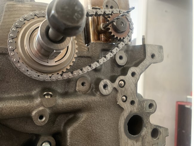

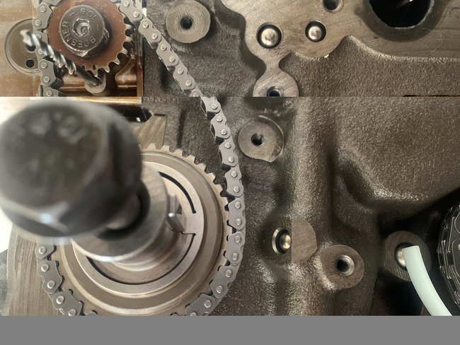

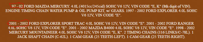

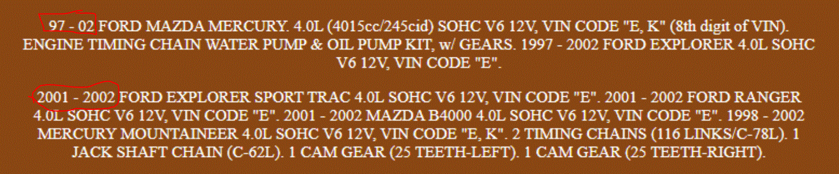

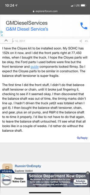

I just found this on an online forum. So perhaps I need a new timing set.
Thursday, September 30th, 2021 AT 11:02 AM
ARIANADANIELLE5345
  • 323 POSTS
Which gear? The one on the crank?
Thursday, September 30th, 2021 AT 11:04 AM
ARIANADANIELLE5345
  • 323 POSTS
Okay.
  • 52,797 POSTS

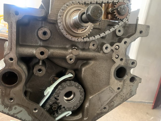

Did you replace the chain and gears or are they the old ones?
Thursday, September 30th, 2021 AT 3:25 PM
ARIANADANIELLE5345
  • 323 POSTS
All of them are new except the crank and balance shaft gears because those two don’t come off. But I fixed it. Apparently my number one piston was not 100% at top dead center. It was at like 99.7%. So, I rotated it just slightly and now everything fits.

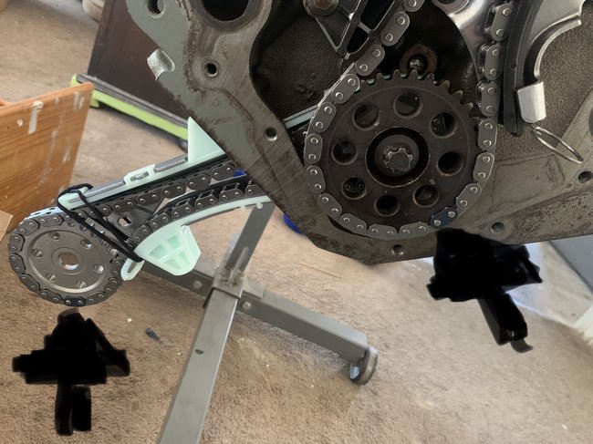

There’s one black link on each chain and I’m assuming it’s there for a reason as a timing mark or something. Where is that black link supposed to sit?
Friday, October 1st, 2021 AT 8:58 AM
  • 52,797 POSTS
When you set the initial set up for the chain, it or they will go on the timing marks. After you rotate the motor, they will not line up at any other time.
Friday, October 1st, 2021 AT 9:36 AM

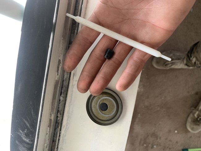

What are these in my hand? They came with the rear jackshaft plug.
Thursday, October 7th, 2021 AT 10:23 AM
  • 109,896 POSTS
To the best of my knowledge, there was an issue with the 4.0L pre-2003 where oil would drain too fast and much from the cylinder heads. The parts in your hand were used to restrict how quickly they drained.
The threaded plug was used to stop oil flow in one of the oil galleries, and the thing that looks like a candle was used to restrict the drain in the cylinder head.
If you look below, that is the only thing we could find related to these parts. Also, note that they appear to come in all timing chain kits for the 4.0L, but they all don't require their use.
If nothing was found when you took things apart, chances are it isn't required on this vehicle.
Let me know if this helps.
See attached pic.
Thursday, October 7th, 2021 AT 6:51 PM

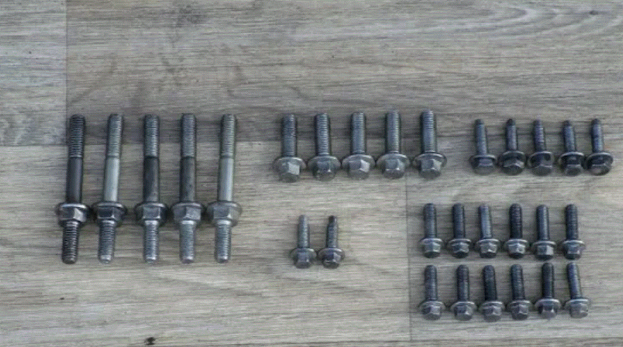

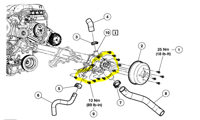

I fixed it. I just put the old bolt in and tightened it. It worked. Can you show me what the timing cover and water pump bolts look like?
Friday, October 8th, 2021 AT 11:20 PM
  • 109,896 POSTS
I don't have actual pics of the bolts. However, there are 12 of them that hold the water pump on. I attached a pic below showing what I have. Also, if I recall, there will be a few longer than the others.
The timing chain cover bolts will be smaller in diameter and shorter in length.
I hope this helps.
Saturday, October 9th, 2021 AT 5:52 PM
