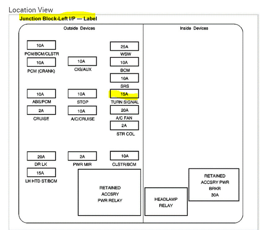

i checked the fuses and they are all okay. i have checked all the harnesses and they are also connected. i don't know what to do.

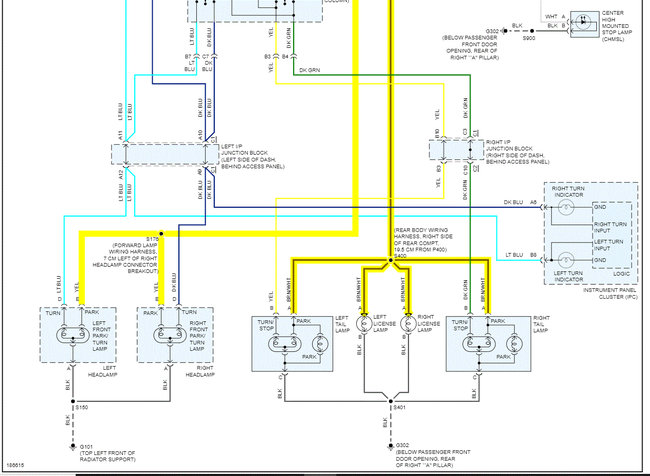

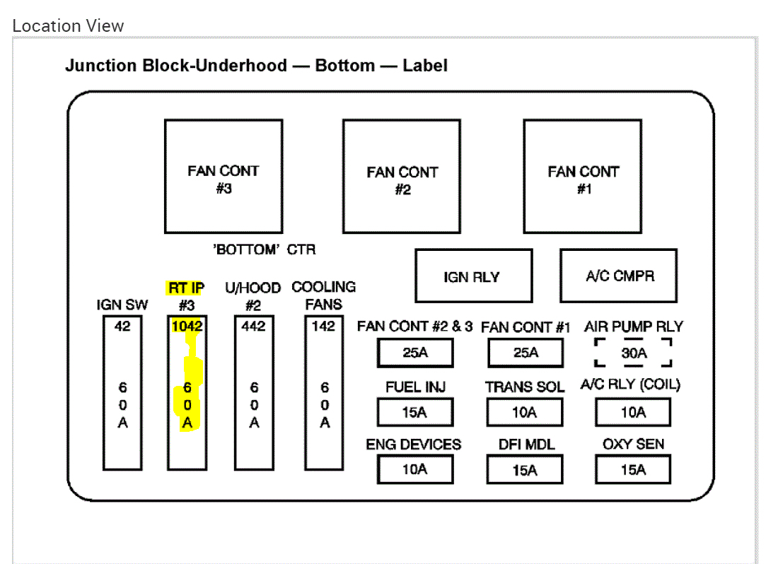

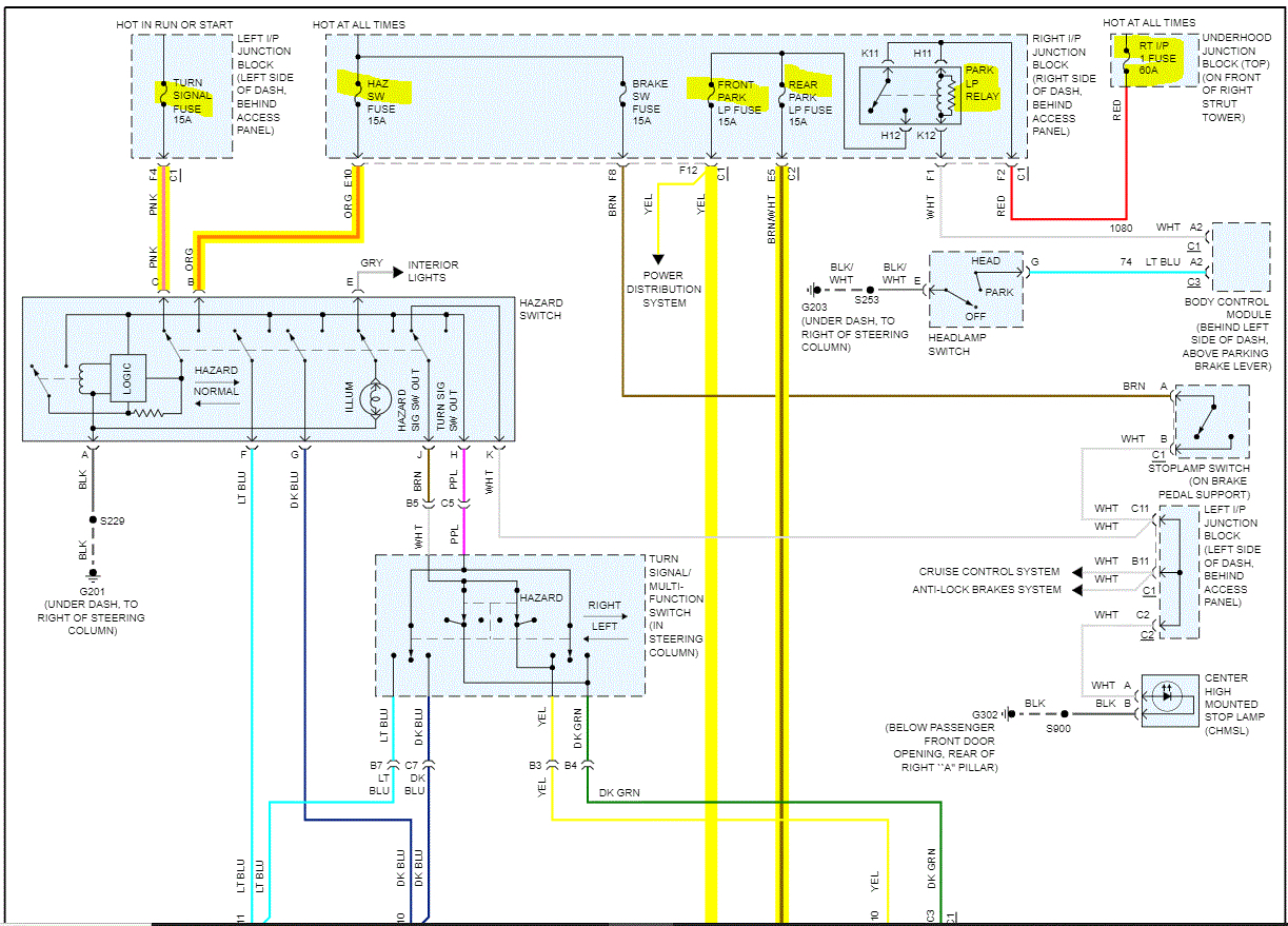

First, I attached the wiring schematics below for your reference. I need you to check the following fuses. Pic 3 is under the hood. This is where I would start because it sends power to the fuses related to the problem areas. I highlighted the 60-amp fuse to check.

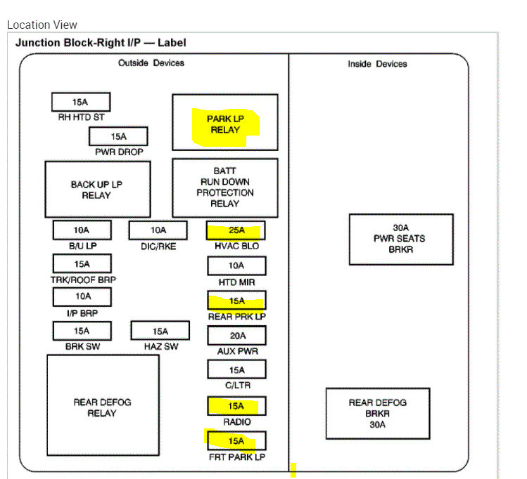

Pic 4 is the fuse box at the left end of the dash and pic 5 is the fuse box at the right end of the dash.
Here is what I need you to do: In addition to checking the fuses, it is important that we confirm there is power to them. Follow the directions in this link when testing:
If all fuses are good and have power to and from them, I need you to check the parking light relay identified in pic 5. If there is another relay with the same part number, switch them. If there isn't, here is a link that explains how to test a relay:
