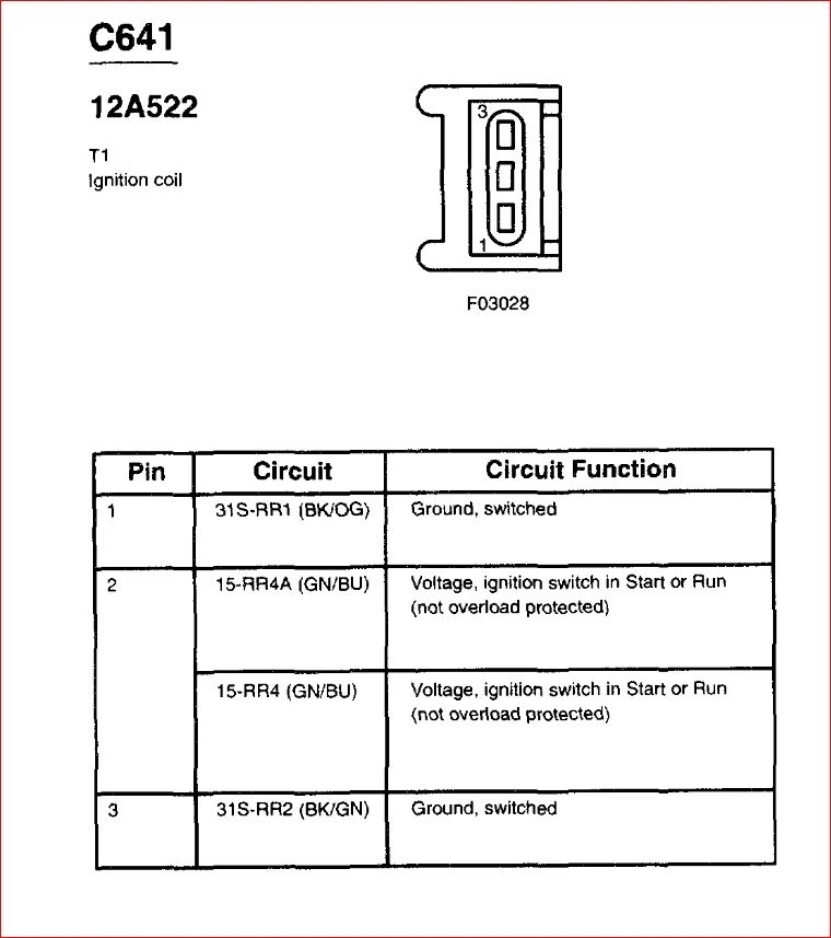

Yes, i am replacing the ignition coil plug that burned and when i removed it the wires came out from the butt connectors and now i am not sure which wire to connect to what. Because on the new plug they are all black but on the car they are green and blue green and black and orange and black. can you tell me which is first, second and third please?
Jun 18, 2019 at 2:17 AM
Okay. Just want to make sure but your wires should be black and orange, green and blue, and black and green.
Here is the pin out chart for this connector.

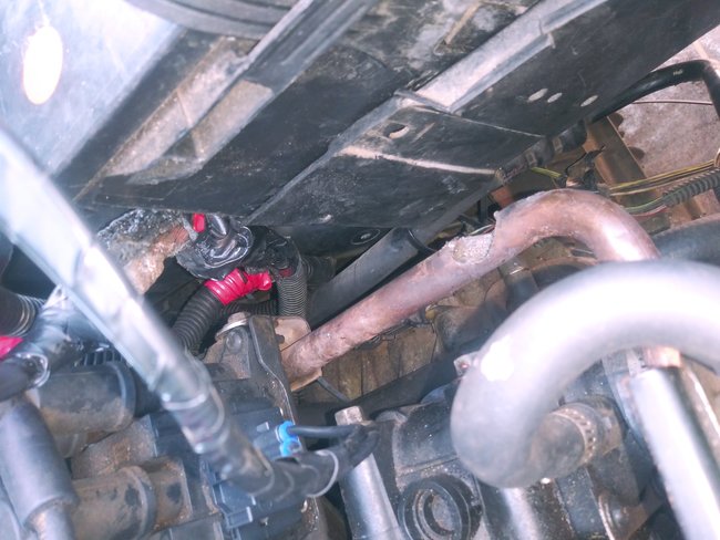

Here is what the hole looks like .is it possible to patch some how?

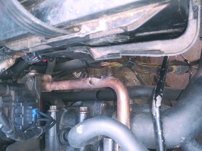

Here is another shot of it:
Jun 21, 2019 at 3:19 AM
That looks pretty significant. I would not try to repair it. I would just replace it. It is possible to repair but it will take welding a patch piece on this pipe but by the time this is done, it could have been replaced..
However, before you do that, I would make sure we secure that cable so the new pipe or something else doesn't get damaged.

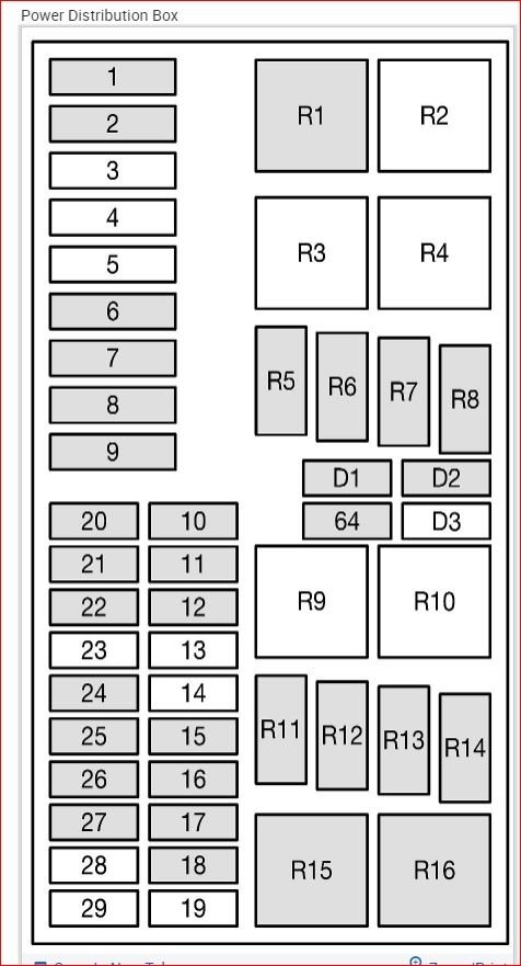

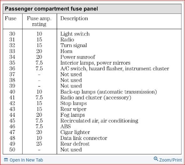

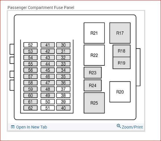

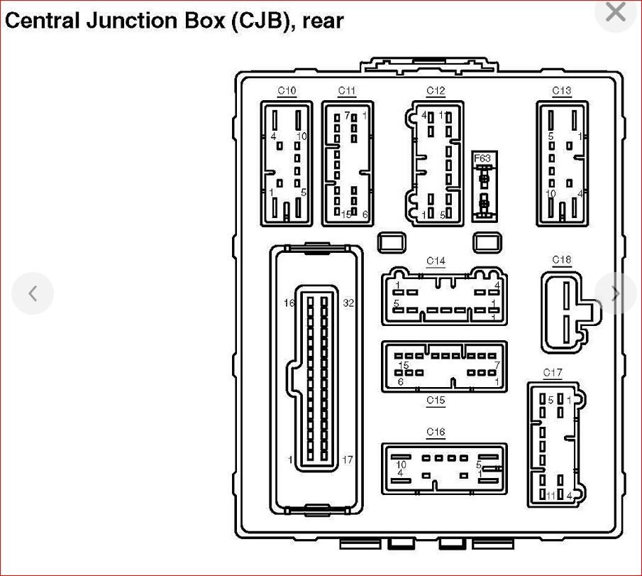

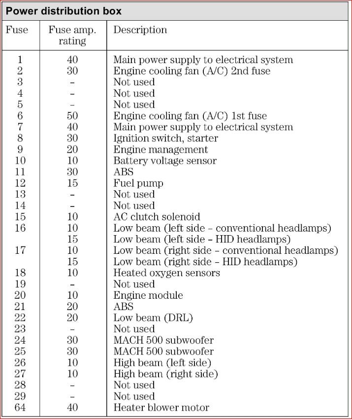

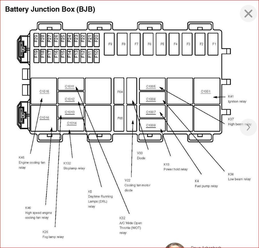

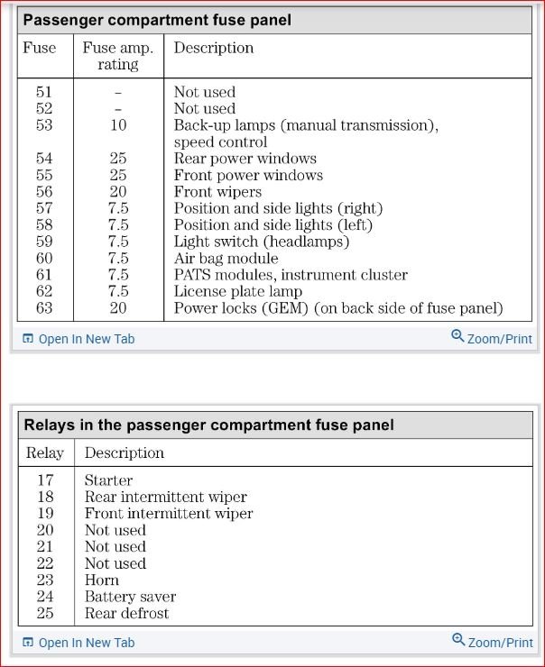

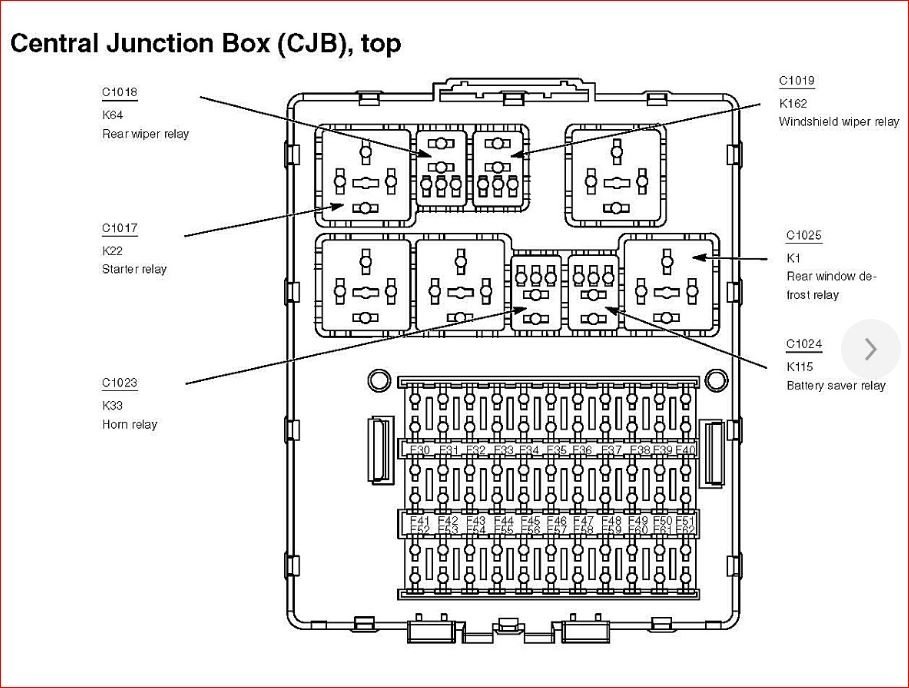

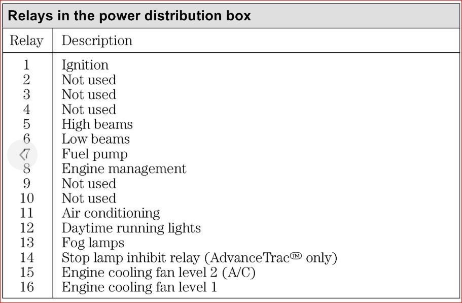

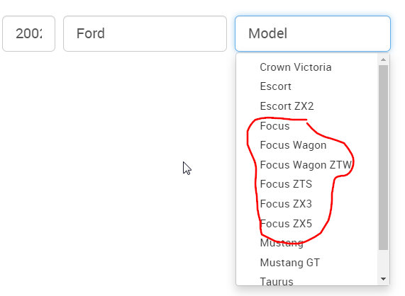

Okay, i know you sent me what you had on my fuse panels but they were not for my car. i have one under the dash on drivers side then one under the hood same side. i need to no the relays names and locations.
Jul 2, 2019 at 11:02 AM
Okay. Please tell me which body model that you have of the options attached and I will send you what is in the service manual.
Jul 2, 2019 at 11:46 AM
VERONICA WIMMS
  • 144 POSTS
Its a Ford Focus SE manual 8th vin numbers a 3it doesn't have any type of extras like alarm although it does have a triangle on the dash that blinks a red light. i thought it was the hazard light button, but they don't come on or blink wen pushed. it is a sedan not a wagon model.
Jul 2, 2019 at 2:42 PM
Okay. According to Alldata the diagrams I sent are correct. The battery junction box is on the rear LH side of the engine compartment. The Central Junction Box is on the LH side under the dash which seems like it matches what you are seeing on the vehicle.

Can you please look back at the picture of the pipe that had the hole melted and tell me its name and do you think it can be the PCM by chance?
Jul 15, 2019 at 1:05 PM
It looks like an EGR tube but it is a little hard to tell from this angle. Easiest way to tell is to determine what it is going to on one end of the other. This will tell you what it is.
It is possible that it is the PCM but at this point, so much has happened, that I am not sure this will resolve the issues. It may be best to have it checked out at this point. The only reason I say that is because I can't recommend you spend a few hundred dollars on a guess at best.
