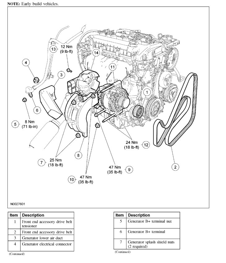

Where is the alternator located?
Sep 1, 2009 at 6:54 PM
BLUELIGHTNIN6
  • 16,542 POSTS
The alternator is located on the engine front near the firewall on the right side of the engine here is a guide that walks you through the removal and diagrams below to show you how it will be on your car.

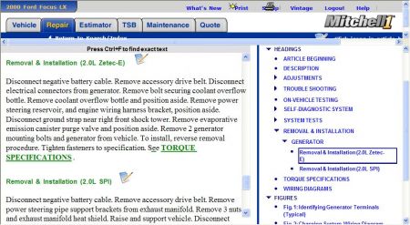

2003 Ford Focus 4 cyl Front Wheel Drive Automatic
what do i have to do once i have alternator off and cant get it out? please help

getting the alternator out of the 03 focus is a pain. you've got to remove a lot of parts to get it out... be VERY careful, there is a small black pipe connected to the fuel rail (some have told me it's the fuel pressure regulator, but no parts stores seem to know what it is, and it's only available from Ford, and it's $100, so be careful you don't break it when you pull the alternator past it.. best just to unscrew it from the fuel rail!) I forget what all I had to take off, but, basically just start taking stuff off above it till you can get it out :(

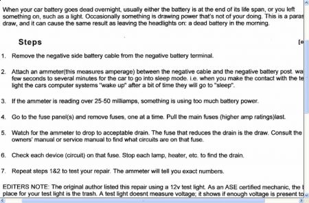

when i try to start my car it wont start so i thought it was the battery then i took it where i got the battery to get it cleaned. It was working fine all that day then when i get up to get ready for work it dont want to start i had to jump my car to get it started a it has been working all day. i just bought my battery in dec and it started to corode so that's why i got it cleaned
Jul 31, 2019 at 6:51 PM (Merged)
  • 75,992 POSTS
Get the battery load tested if okay -could be a short circuit in the electrical system that's draining the battery overnite.

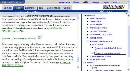

2000 Ford Focus 4 cyl Front Wheel Drive Automatic
how do i get the alternator out of the car i already have it loose but can not get it out

  • 75,992 POSTS
See below
https://images.2carpros.com/forum/automotive_pictures/12900_alty1_13.jpg
https://images.2carpros.com/forum/automotive_pictures/12900_alty2_9.jpg
