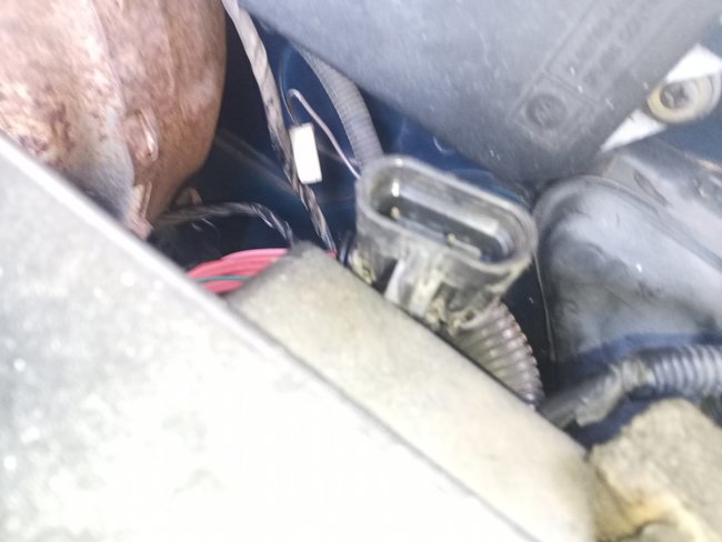

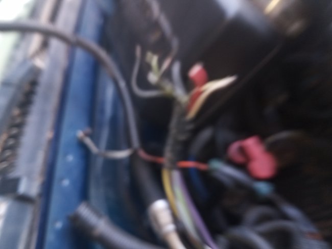

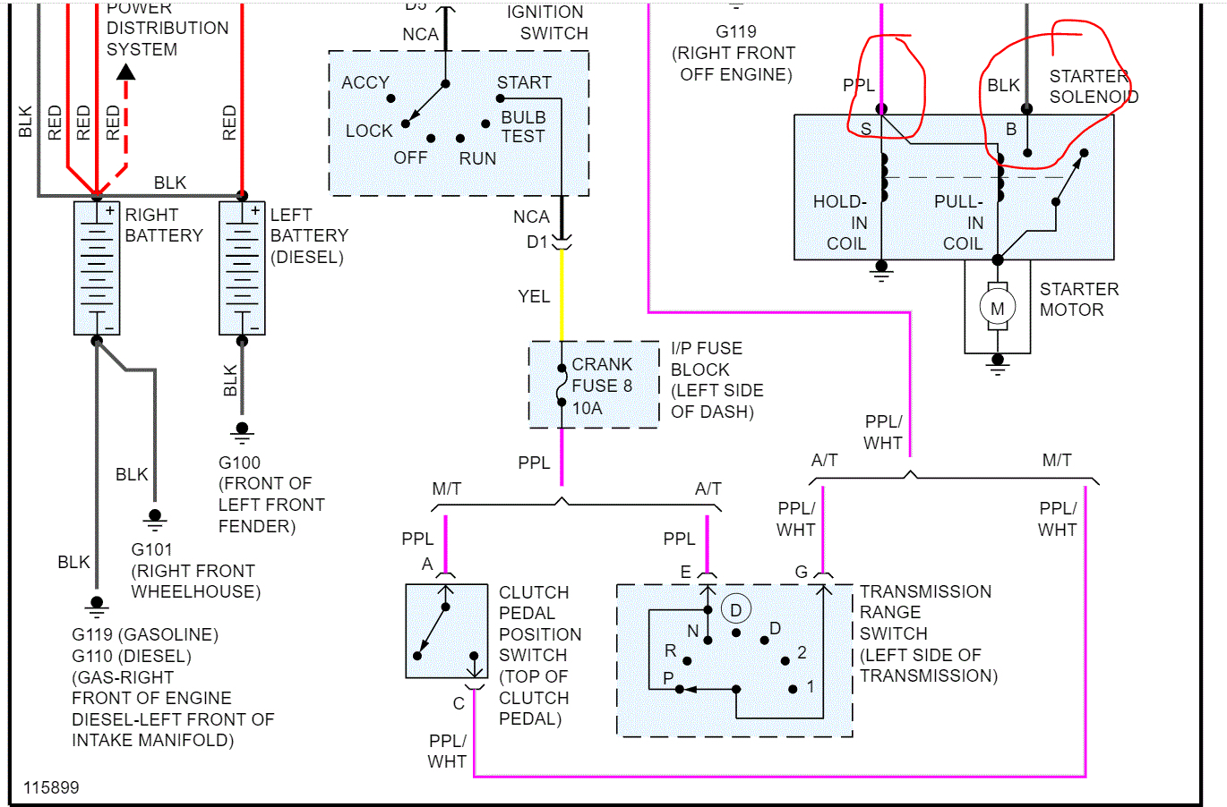

I replaced the motor on my 1999 model GMC with a 1996' motor. I was using the original harness. I was having problems all over the place, so I decided to put the 1996' harness in it! The wire plug on the passenger side under the hood that comes into the inside of truck was cut its 8 or so wires under the hood and on the inside, it drops down to a 4/6 wire count. would that wire cluster have any effect on the truck not starting? All it will do when I turn the key is the brake light and one other light in my dash panel will light up will not turn over. The fuel pump is kicking on, but truck will not turn over at all. can you give me some helpful info on my situation anything at this point will help me?

What color are the wires in the cut harness? Could you take a few pics and upload them for me to see? Also, do you still have the original harness? If the engine is the same size, it should have been useable. You may have had to change a few sensors, but it should have worked. Let me also know if you are using the original PCM.

Brad, is the 1406 a P-code (P1406)? Also, what do you mean by sparking to the starter? Is something shorting?

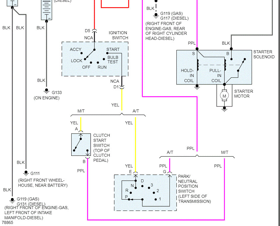

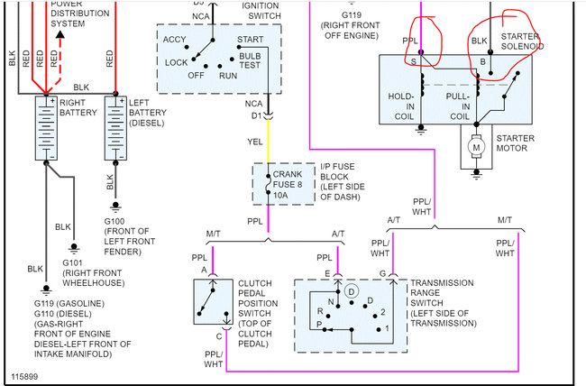

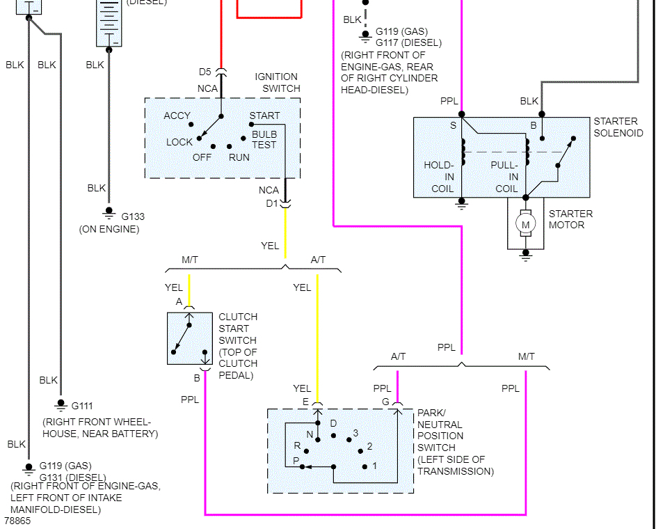

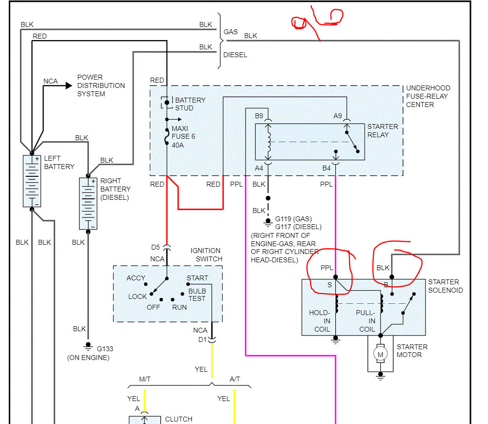

At the starter, there should be a heavy gauge wire from the battery, 12v at all times. The smaller wire is the trigger wire that should only get 12v with the key in the start position. Is that happening? Also, if you get sparks when you try starting it, are you certain everything is tight and not damaged?

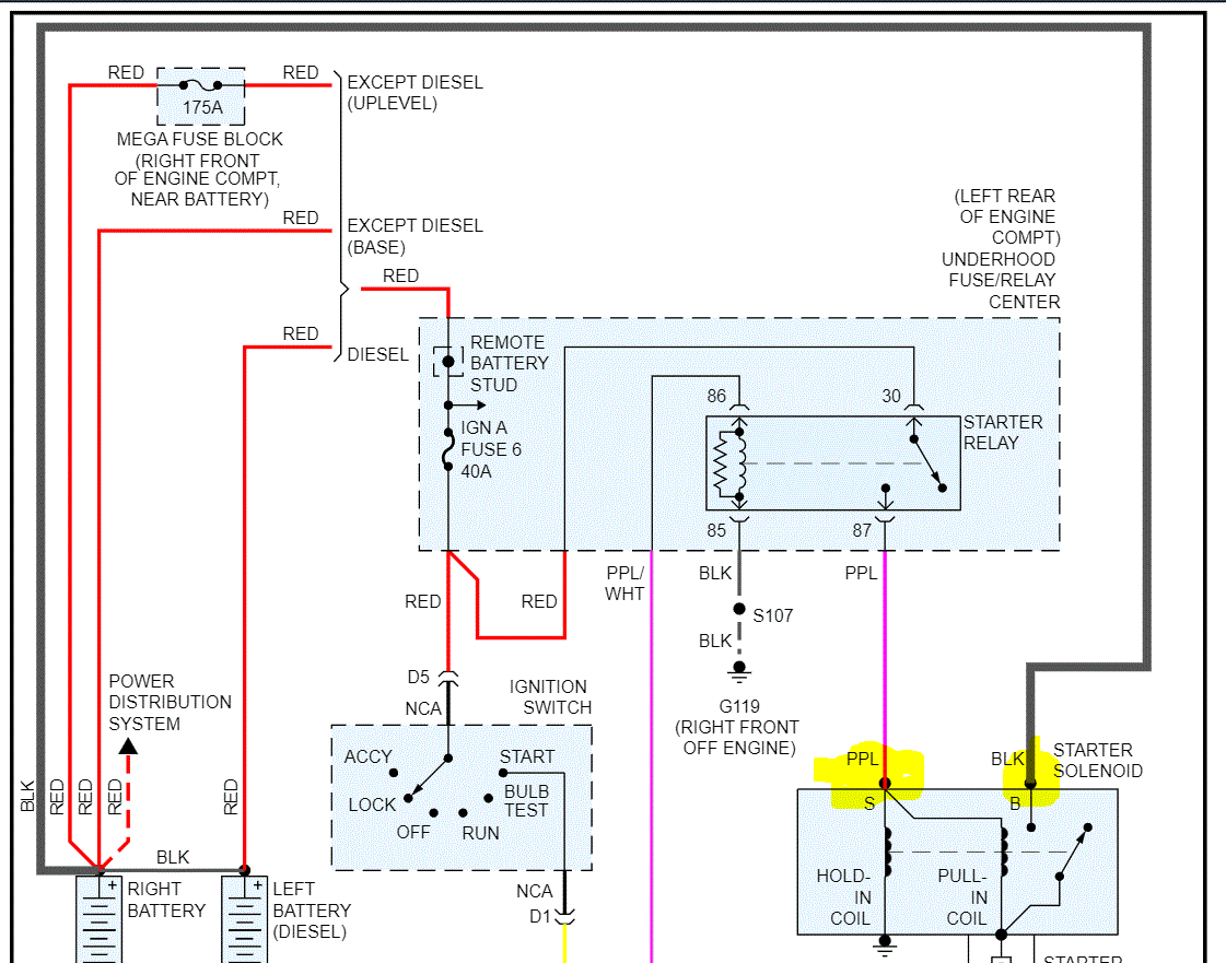

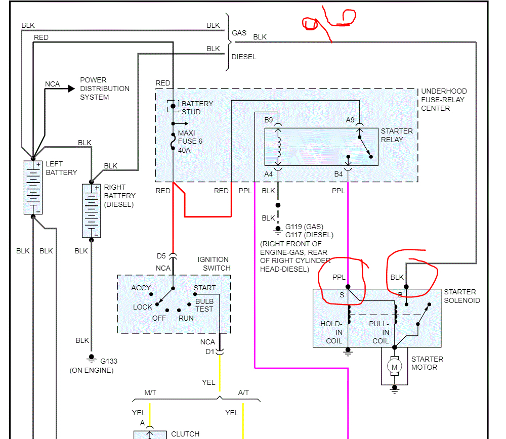

I attached two different schematics below. The first two are for the 96 start circuit and the last two are for the 99. They are very similar. Take a look through them and let me know if that is how it's wired.

I'm getting confused. Is it a 1998 or 1999? LOL Also, at the starter, there will be a smaller wire that is purple. It only should have power (12v) when the key is in the start position. Have a helper turn the key for you and check to see if that wire gets power. If it does and there is 12v to the starter from the battery (larger wire), the starter sounds bad.
