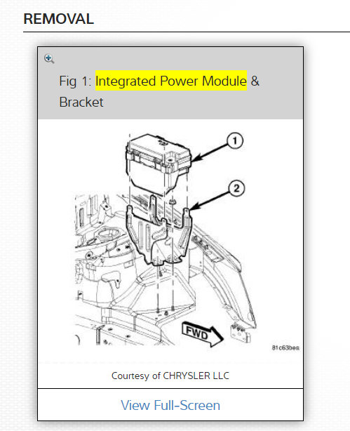

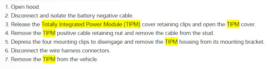

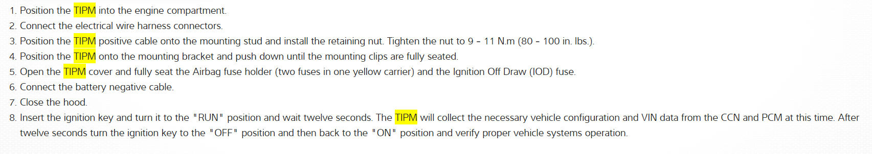

It sounds like the TIPM has gone out which is common but lucky for you it is easy to replace because it self initializes. here are diagrams and instructions below to help you fix it. Check out the diagrams (below). Please let us know what happens.
