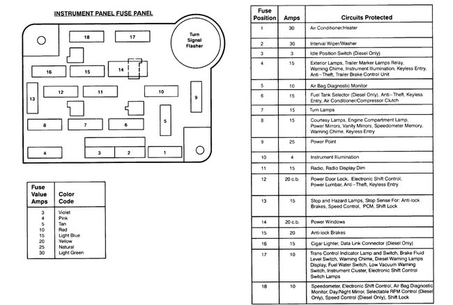

I have no dash lights, no tail lights and no turn signals. I replace the headlight switch still no dash lights, still no tail lights. new turn signal switch still no turn signals but I have hazards. If i turn the headlights on i can jump a wire across to give me dash and tail lights but still no turn. I have replaced the fuses.

There is a fuse #4 in the interior fuse panel we need to check for power. this guide can help with the fuse location in the diagrams below:
