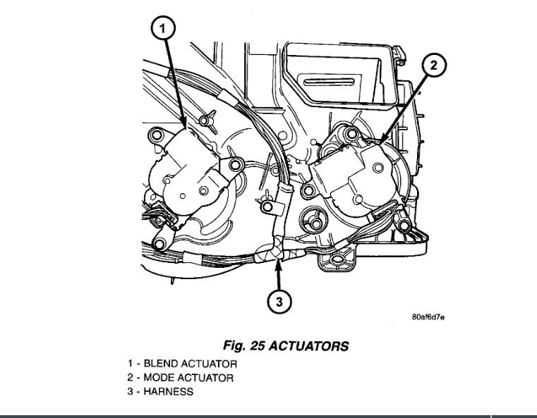

Okay, so basically I was driving with my defroster on and it got stuck on defrost. However around a month later I turned the car on and the AC was on. (I had turned the knob over to AC weeks before It actually turned on as mentioned above). Possible actuator issue?
Nov 5, 2018 at 12:06 AM

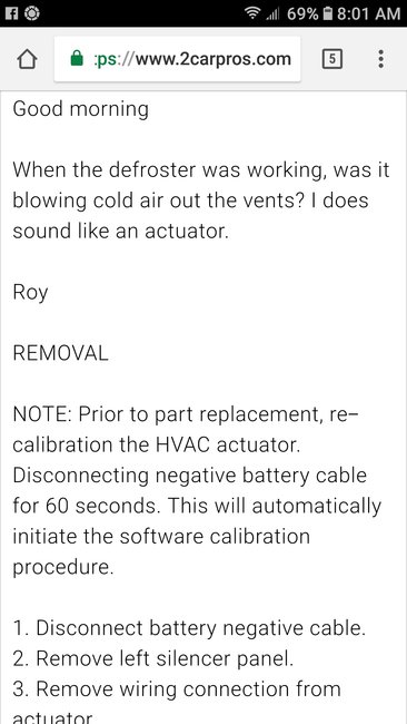

Good morning.
When the defroster was working, was it blowing cold air out the vents? It does sound like an actuator.
REMOVAL
NOTE: Prior to part replacement, re-calibration the HVAC actuator. Disconnecting negative battery cable for 60 seconds. This will automatically initiate the software calibration procedure.
1. Disconnect battery negative cable.
2. Remove left silencer panel.
3. Remove wiring connection from actuator.
Fig.25 Actuators

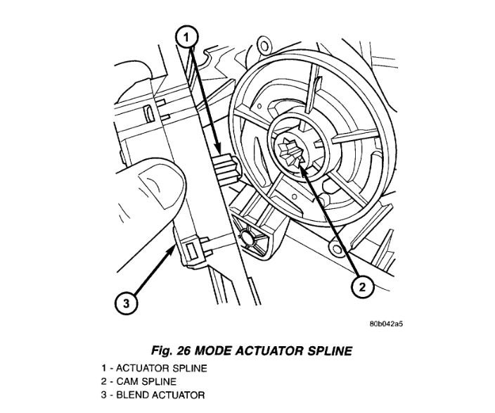

4. Remove mode actuator mounting screws and pull actuator straight down. Note actuator shaft position for installation reference.
Fig.26 Mode Actuator Spline
INSTALLATION
1. Install mode door actuator on the housing, make sure spline shaft is positioned properly with the cam.
2. Install and tighten the mounting screws.
3. Connect actuator wiring harness to the actuator.
4. Install console left side panel.
5. Install left silencer panel.
6. Connect the negative battery cable.

I attached a picture back a couple of posts. The procedure was there as well.
Nov 5, 2018 at 7:16 AM

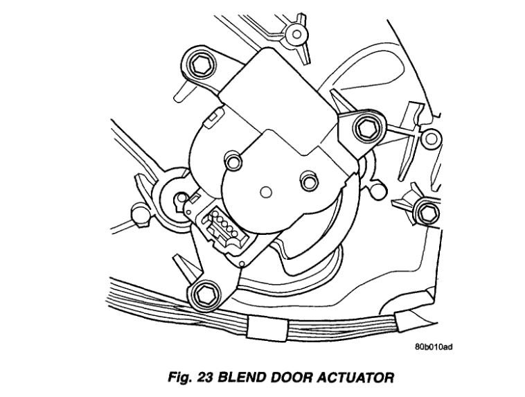

So I replaced the mode door and have no heat still. Maybe blend door?
Nov 18, 2018 at 9:21 AM
Yes. The blend door motor is what controls the heat not the mode door.

Sorry, traveling today.
Procedure below.
REMOVAL
1. Disconnect negative battery cable.
2. Remove the floor console.
3. Remove rear heat ducts.
4. Remove HVAC housing.
5. Disconnect the electrical connection.
Fig.23 Blend Door Actuator

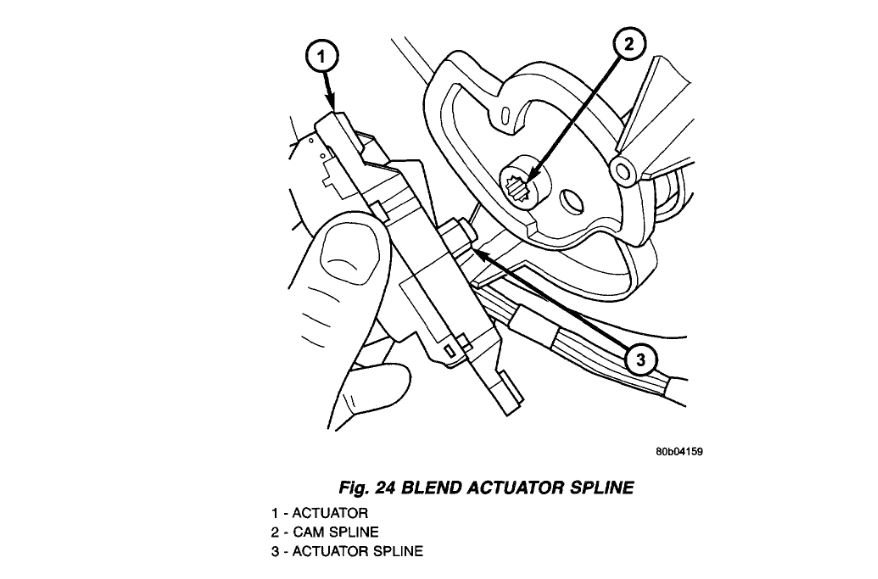

6. Remove actuator retaining screws and pull actuator straight down. Note actuator shaft position for installation reference.
Fig.24 Blend Actuator Spline
