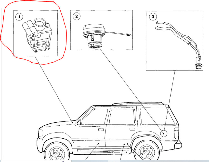

My vehicle started to act up on the way home (loss of spark or fuel). I made it home, but then the truck would not start. I towed it to the mechanic, and it started and ran for a while. After it was turned off it did not start again. So, the problem seems to be intermittent. We spent a little time together diagnosing and there were no trouble codes or check engine light. The fuse/relay box in the engine compartment did not have ground turned on from the PCM. Is this a known issue with older Explorer? Could this be caused by the PATS? (Drained battery in the key fob?) I had read that PATS would not disable a running vehicle, only prevent it from starting.

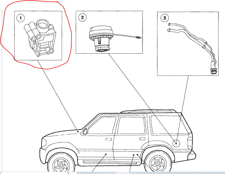

One other thing. Have you tried resetting the inertia switch? The Inertia Fuel Shutoff (IFS) switch on the RH toe board. You can reset it. (See pic 1 below)
See pic below.

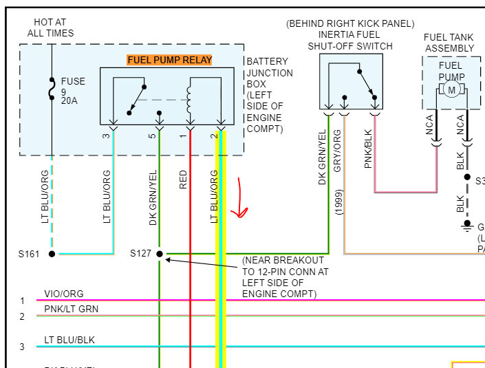

Thanks Joe, it has spark. i can hotwire the fuel pump and it will run so the fuel pump works but the relay in the under-hood fuse box is not getting ground. Several relays are not getting ground. Weirdly, the ground is turned on and fed by the PCM. My understanding is that this is how PATS works, it shuts off the ground. Yes, i have checked the inertia switch. The intermittent part is what gets me and no trouble codes and the fact it started acting up when driving. I will check the crankshaft position sensor. Is that common to be intermittent when it goes out?

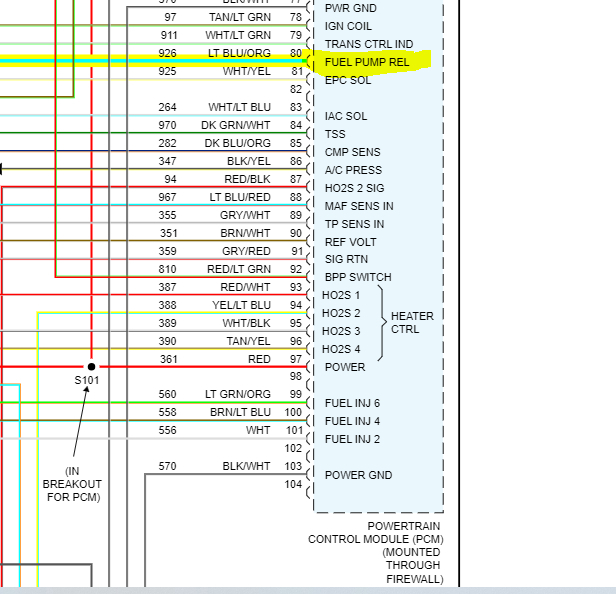

If the fuel pump relay isn't getting ground, you are correct. A ground path is provided via the PCM to complete the primary side of the relay. See pics below.
So, if you are not seeing ground from the PCM, the next thing to do is check at the PCM connector.
Keep in mind, the PCM has a ground as well. It is on the left side of the radiator support.

Okay, that leads us back to the power supply at the pump. We need to check at the PCM for a ground path for the relay. Also, have you confirmed there is power to the primary side of the relay? If there is power to the primary side and we have a ground path, that should actuate the relay.
Sorry for so many questions. Not being there makes wiring issues a little more difficult. Also, have you checked for power to and from the inertia switch? Maybe it's failing.

Yes, electrical is not my favorite to chase down especially when it is intermittent. And yes, I have positive power to the relays. I should say that this is a project vehicle, and I stopped my diagnosis when i discovered the PCM controlled the relays by turning on the ground. That was new to me, and it looked like i would need to start unwrapping the wiring harness to trace the ground distribution wires and connections. I don't have time this weekend to dive back into it, but I am trying to get sage advice from more experienced people to help me formulate a logical game plan when I do have time to go back to it. I was hoping this was common and there was a known culprit and remedy. But it sounds like I need to just continue with the logical progression through the harness. Do you know if there is a way to open up the relay box more and get to the bottom of it where all the wires come in?

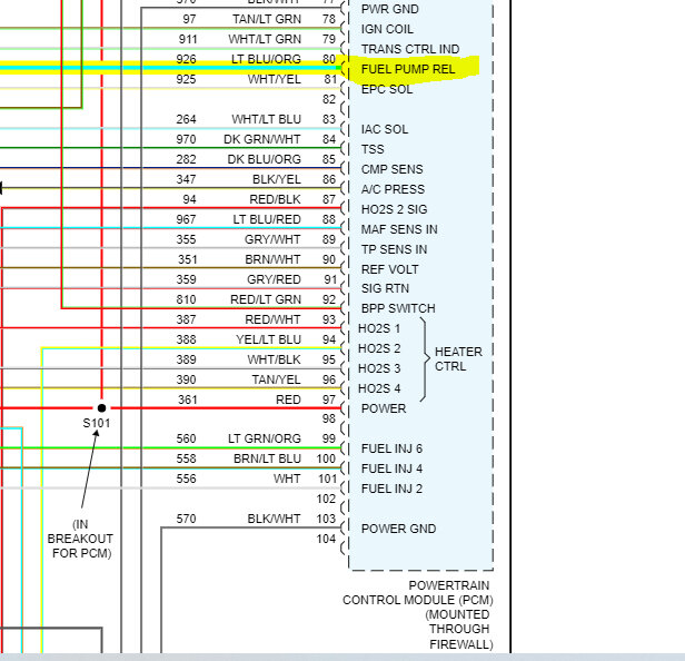

Thanks Joe, from your earlier diagrams it looks like i need to look at pin 103 with a black/white wire? Number 570 in the diagram? Is that your understanding of the ground to the relays that is controlled by the PCM?
Jul 2, 2023 at 7:45 AM
  • 110,240 POSTS
That is the PCM's ground. Using that ground, the PCM provides a ground for the relay via pin 80 (light blue wire with an orange tracer).
