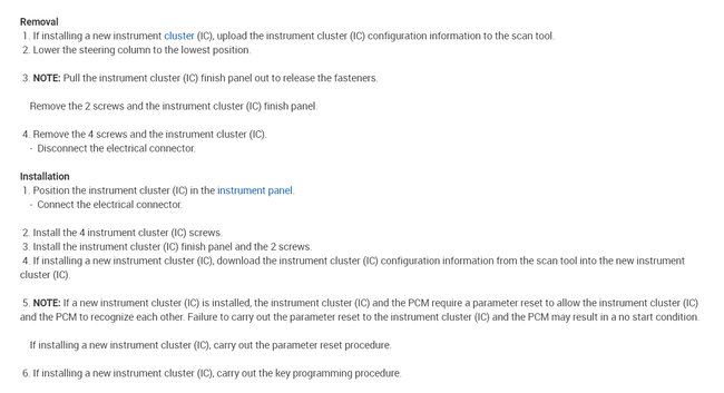

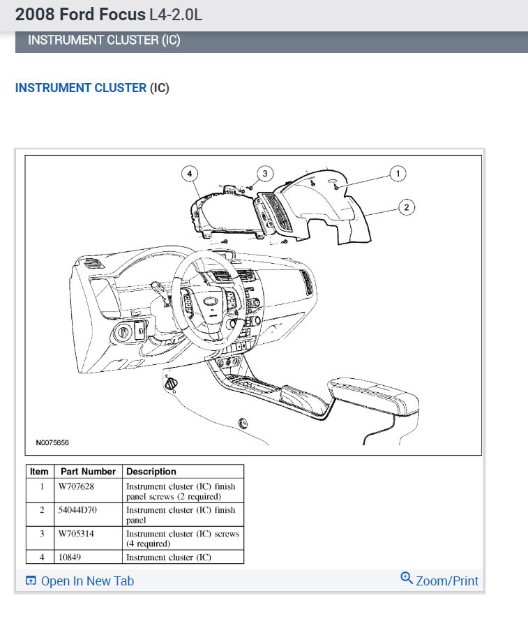

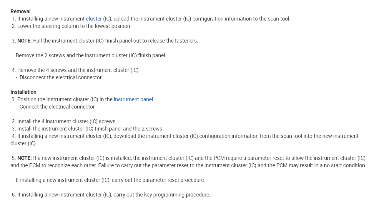

Water inside the car is never good. so please get that situation fixed, but it sounds like the cluster is having an issue. To be sure lets do a CAN scan which is the future of automotive repair you can get a CAN scanner from Amazon for about $50.00. here is a video to show you how:
https://youtu.be/InIlnsjOVFA
Here is how you remove the cluster in case that is the problem. Check out the diagrams (below). Please let us know what you find.
