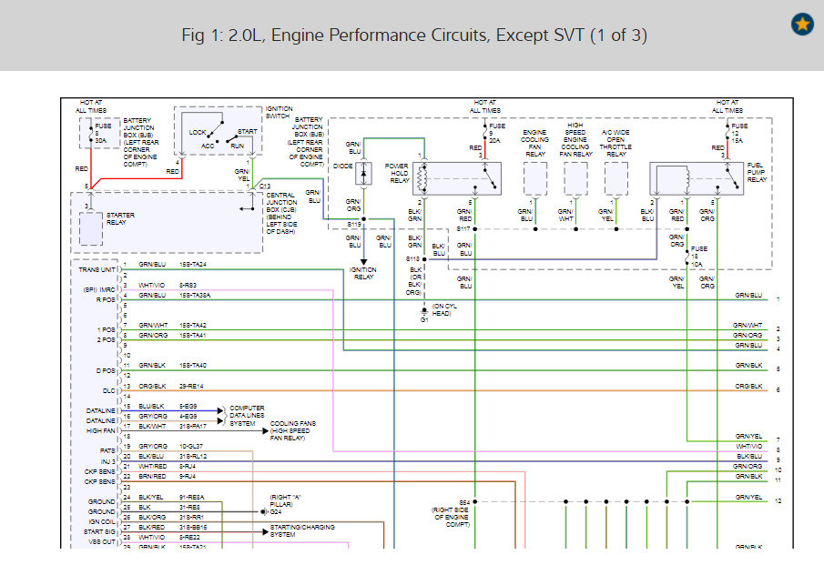

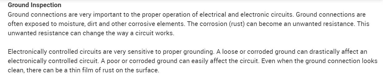

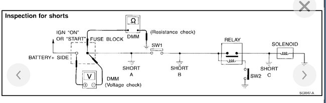

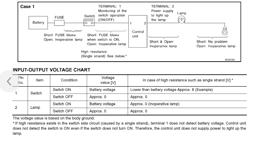

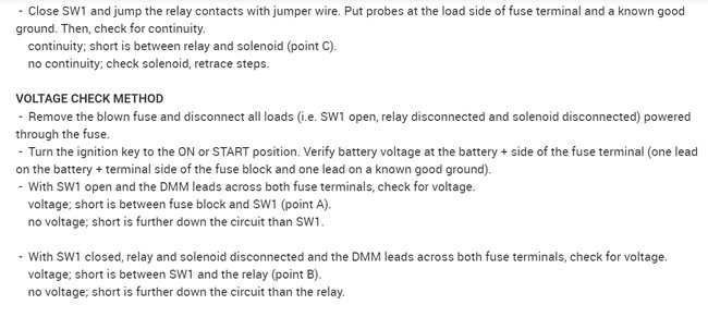

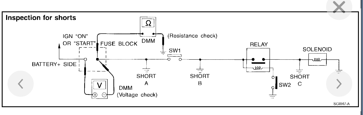

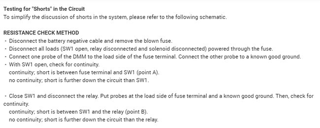

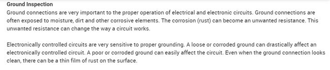

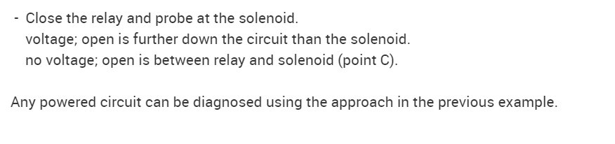

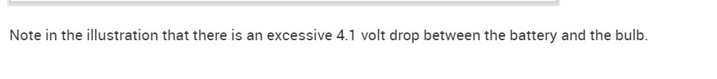

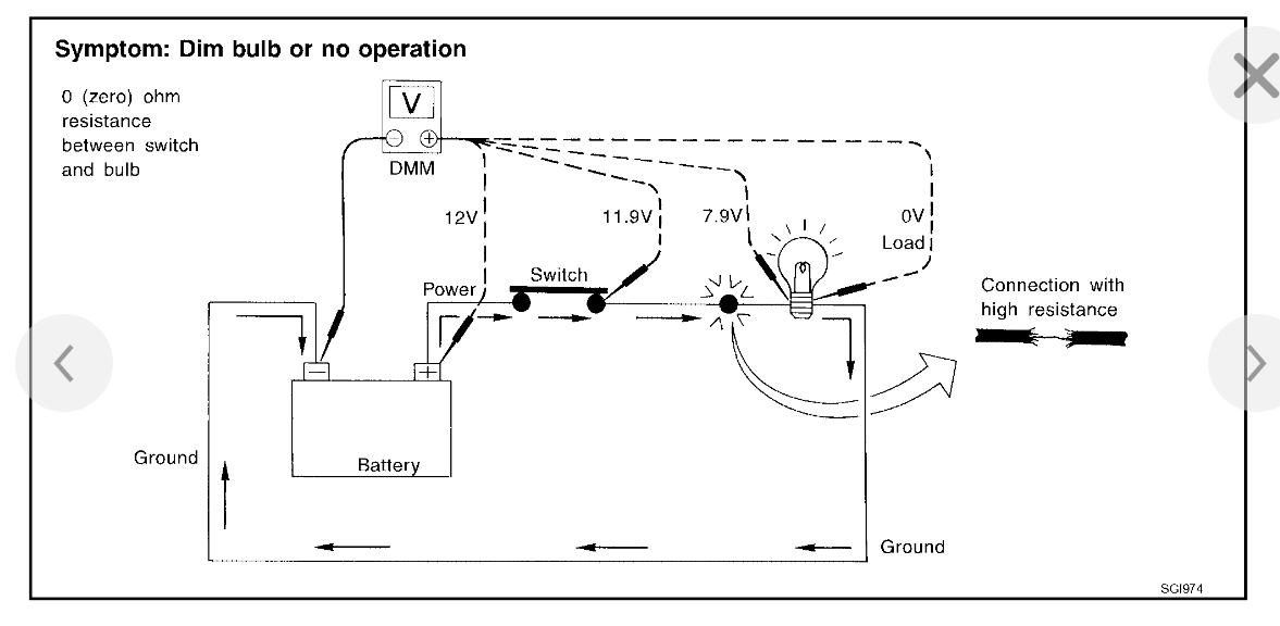

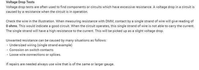

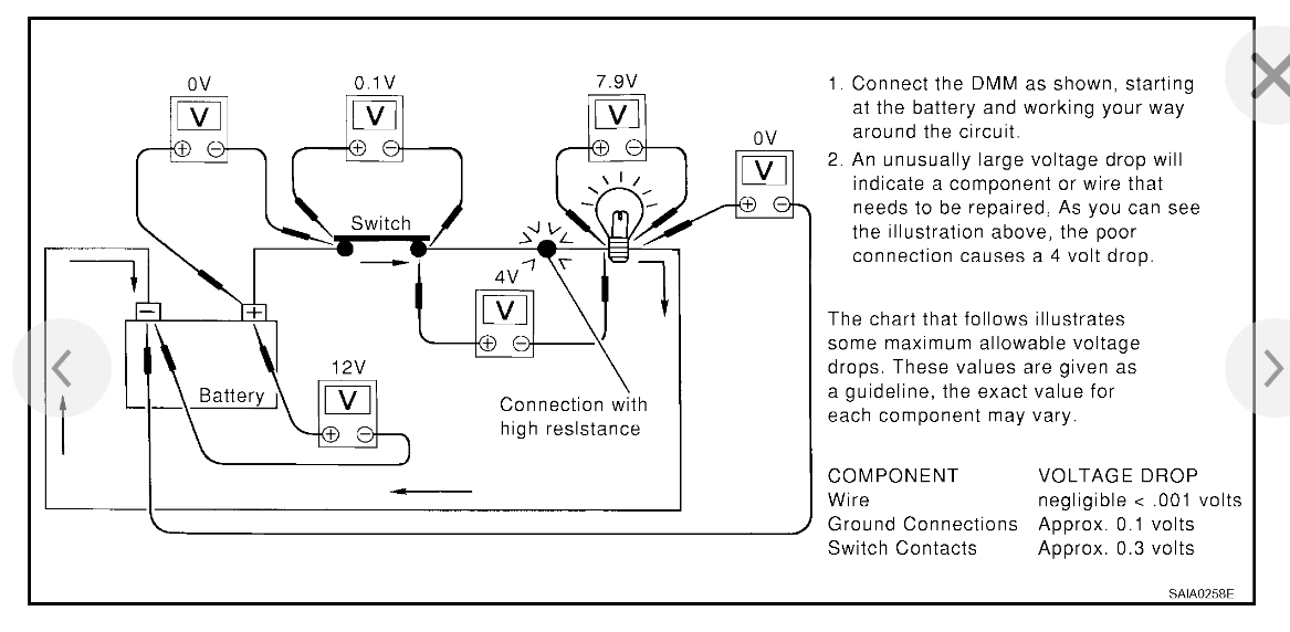

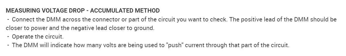

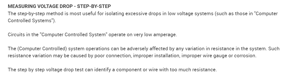

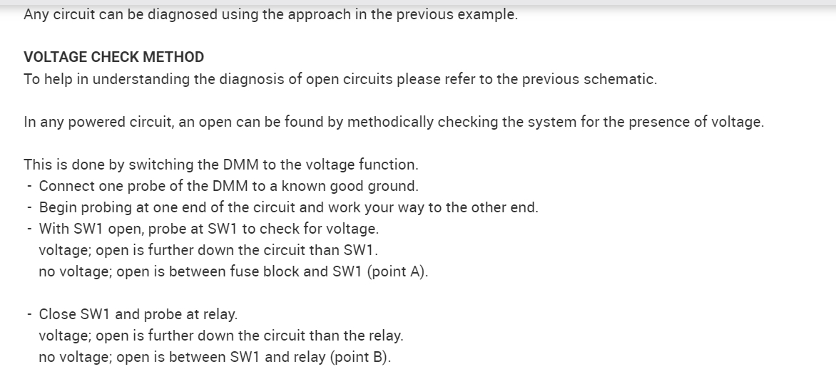

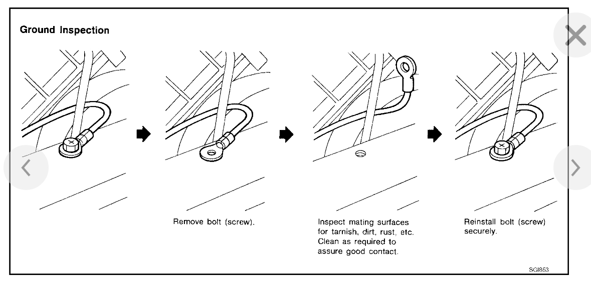

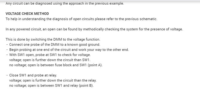

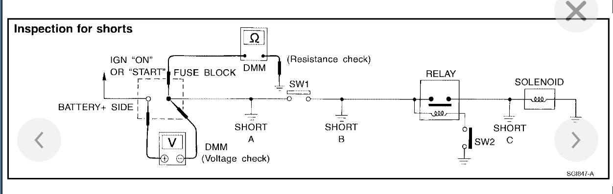

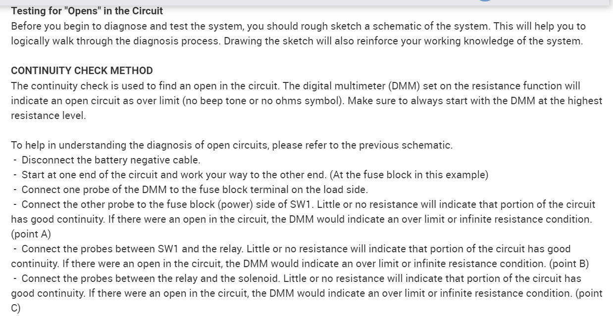

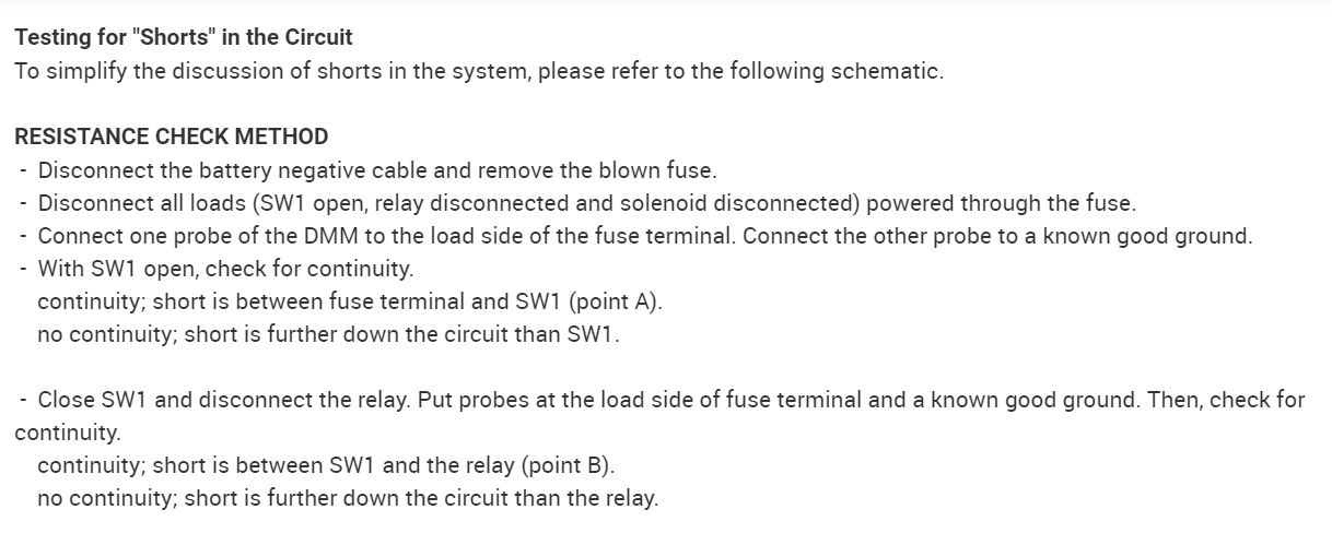

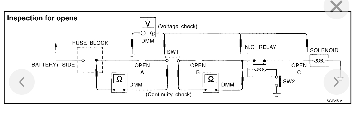

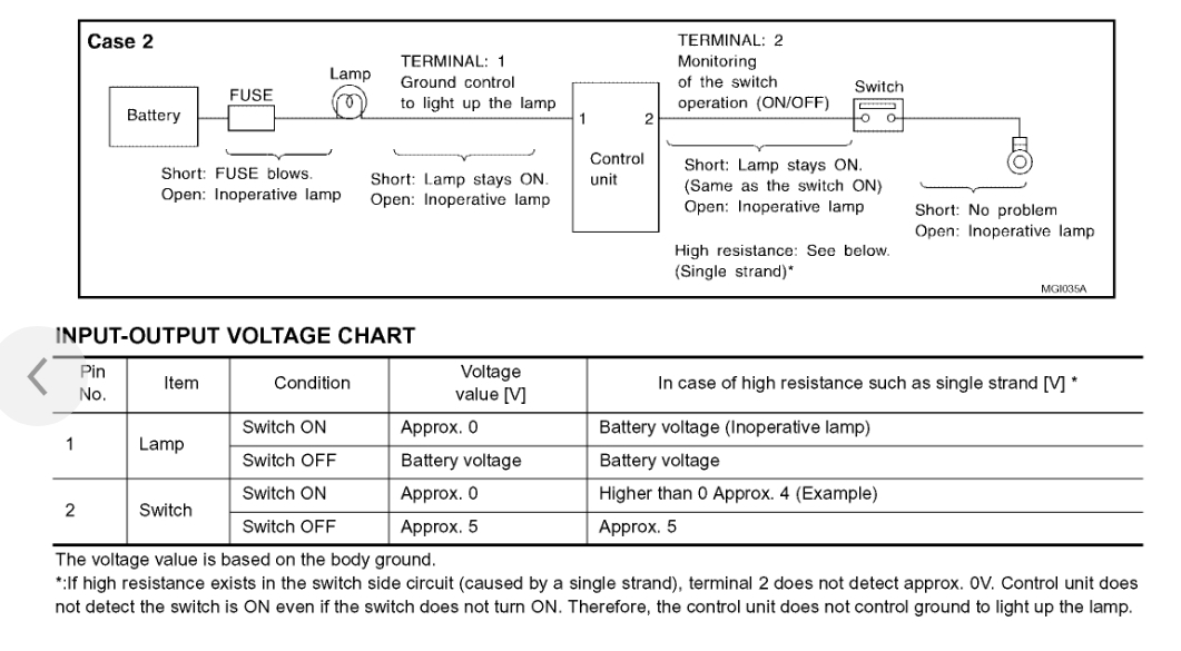

Hello again,
In the diagrams down below I have included directions for how to find opens in a circuit, shorts in a circuit, how to test a ground, and also how to find unwanted resistance or a problem in a circuit with a voltage drop test. Please go through these guides and get back to us with what you are able to find out.
Thanks,
Alex
2CarPros

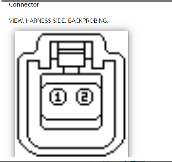

And i bought a aftermarket wiring harness for the crankshaft position sensor, but the wire colors don't match. how do i no how to connect?
Jul 31, 2019 at 12:57 AM

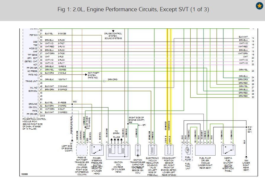

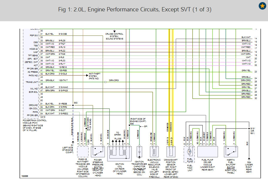

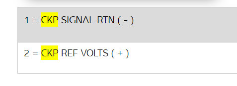

SCGRANTURISMO
  • 4,897 POSTS
Hello again,
Okay, the brown/red wire on the original harness is the(-) negative wire and the white/red wire on the original harness is the(+) positive wire. I have also included a wiring diagram of your vehicle with the Crankshaft Position Sensor (CKP) wires highlighted for you and a diagram of the wiring harness connector for you in the diagrams down below. Please go through them and get back to us with how things turn out.

On the new harness both wire are white only, but when i am trying to use the ohm multi tester. does the cars battery need to be in it hooked up and the fuses as well? when testing the harness does the red go on one side black on the other? and do i turn it on before i i hook it to the harness?
Jul 31, 2019 at 11:38 AM
SCGRANTURISMO
  • 4,897 POSTS
Hello again,
In the last reply I sent you a diagram of the electrical connector for your vehicle's CKP sensor. This is the connector from the vehicle's wiring harness. Orientate the new connector you are installing exactly like it is in the diagram. The way to orientate it is by where the tab is on it. The tab is what snaps and locks the connector in place on the sensor itself. The pins are then numbered with wire colors assigned. The wire colors are the wire colors of the vehicle harness. It don't matter what the color of the wires on your new connector are, they are not important, just get the vehicle harness wires correct and you are done. And yes, the battery should be disconnected whenever you are working on your car any time, except when it needs to be hooked up for electrical measurements. Please get back to us with how things turn out.
