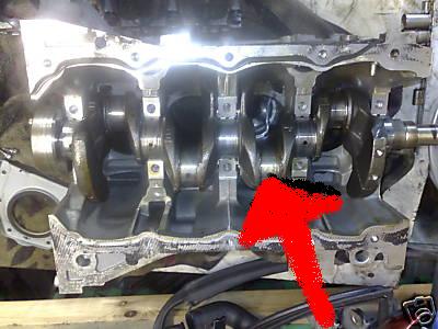

it is described by the garage as having a little end broken connection crankshaft to piston - would buying this part be a replacement or would I need something else
Ford focus 1.6 crankshaft assembly 2007 16v crank shaft in good used condition.only covered 4,400 miles. Complete with shells.
Also could you let me know how big a job I might be looking at and if to replace a larger piece of the engine (cylinder head?) with a scrap part would be easier could you let me know what i would need to get
I look forward to your response and would greatly appreciate any help you can give.
I will attach a picture of the proposed part for information

to replace this part you have to strip the whole engine down .. the part arrowed in the photo is the part you would be buying .. I don't think a 2007 focus part would fit into a 2002 focus .. you would have to check into this ..replacing the cylinder head would not rectify the fault described .. the other option you have is to buy a complete new/recon engine ...
