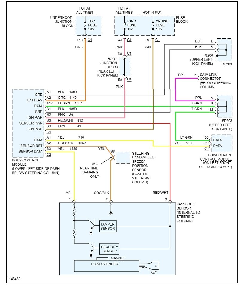

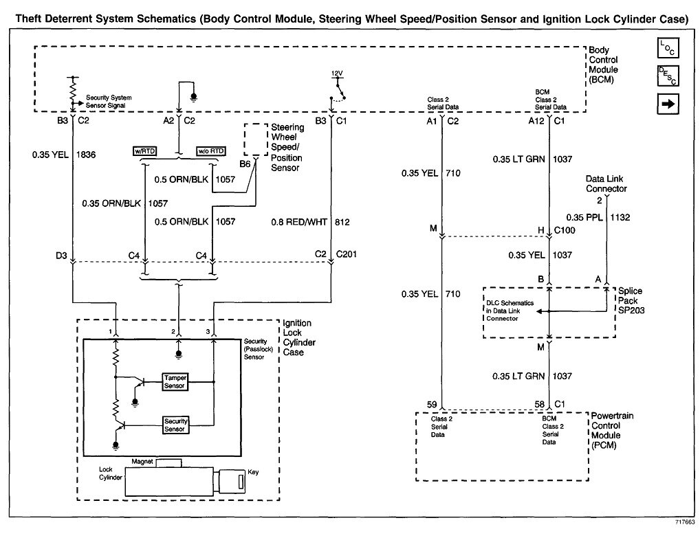

Pins were re-cleaned thoroughly and have good contact, not yet replaced. Replaced the ignition cylinder and coded the key. The truck has run perfectly for days now, and the issue is re-emerging. Reset security on the computer, with no different results. Discovered the 3-pin connection from the ignition switch was loose and wobbly in its connection to the new ignition cylinder. Added a thin plastic shim along its side and secured with electrical tape. Had perfect consecutive starts for another few days, now it’s returning to intermittent. The vehicle will start fairly consistently if I push on that 3-pin connection gently while turning the key. Should I focus on the pins when I’m able to replace them or look into a new ignition switch harness given the new find?

Here's two diagrams for that system. The first one is the manufacturer's and the second is the aftermarket version. Both show the PassLock sensor at the bottom.
I'd have to see what the pins look like to figure out how to make them make a better contact. All GM dealer's part departments have multiple huge kits with all the connector terminals available separately, but I don't know if that includes individual pins for that connector. Something needs to be done to make them fit tighter.
If that sensor has a bad wire connection, it is supposed to disable the injectors. The starter should still crank normally, unless something has changed in the design of the system. From what I remember, that sensor shouldn't affect the starter operation.
